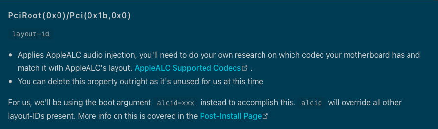

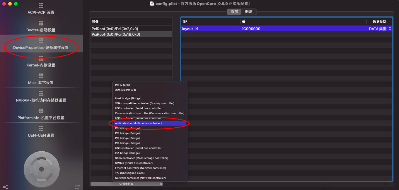

Devon.. Posted July 24, 2021 Share Posted July 24, 2021 41 minutes ago, Luxury Hair said: HI Everyone,So I have build a hackintosh on my laptop.Specs:Hp Pavilion 14 NotebookCPU: I7 5500UGPU: Intel HD 5500 + Geforce 840M(Not using)Ram: 8gbWireless Card: BCM43142 (Written BCM943142HM on card)Audio: Realtek ALC290OS: Big Sur 11.4BootLoader: OpenCore 0.7.0Screen: Elan Touch Screen USBThe main problem is The audio is not working at all. There is no device in system information and nothing is working on headphone ports. I have tried voodooHDA but it only showed Digital HDMI which is useless. I have also tried layout ids for ALC290 listed on AppleAlc supported codecs page but nothing worked. Please help me with this. I have also issue with internet and the touch screen works perfectly with UPDD driver. But please help me with the sound!!!I have attached the EFI using OpenCore 0.7.0 so please check if something is wrong.Thanks. EFI_Laptop.zip 6.92 MB · 0 downloads You don't see dsdt.aml in your EFI, Add audio device in deviceproperties. Please refer to:https://dortania.github.io/OpenCore-Install-Guide/config-laptop.plist/broadwell.html#deviceproperties AppleALC Supported Codecs https://github.com/acidanthera/AppleALC/wiki/Supported-codecs Quote Link to comment https://www.insanelymac.com/forum/topic/348360-laptop-audio-not-working-realtek-alc290-applealc/#findComment-2763502 Share on other sites More sharing options...

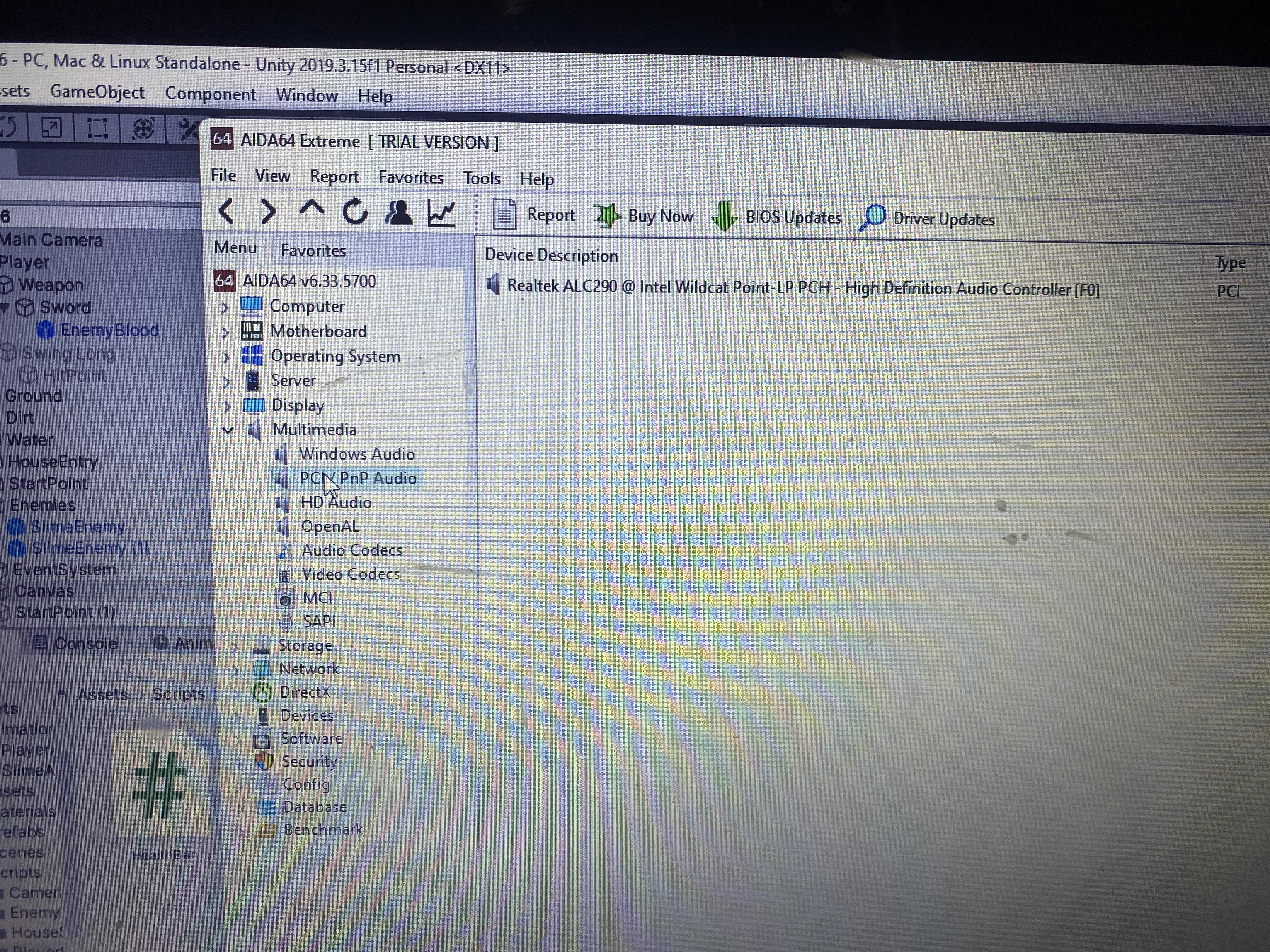

Luxury Hair Posted July 24, 2021 Author Share Posted July 24, 2021 Just now, Hervé said: Broadcom BCM94312 chipset (14e4:4365) is unsupported so you will have to replace your current card by a supported model or use a USB dongle. When you used VoodooHDA, did you also use AppleHDADisabler alongside? Did you double check in DPCIManager or Hackintool that codec is indeed ALC290? Thanks for the response. For the chipset, I will get a usb dongle or supported card. No, I didn't used AppleHDADisabler. I just used the .dmg file to install it. After installing, it didn't showed any device as it has issue in BS 11.3+. Then I watched a video and moved the VoodooHDA kext to /Library/Extensions using terminal and removed it from OC/Kext and .plist file. After doing this, It showed a Digital HDMI which is not connected and no use for me. So I decided to stick with AppleALC. I check the codec using AIDA64 on Windows. On the DPCIManager, the Codec column is empty. Thanks Just now, Devon.. said: You don't see dsdt.aml in your EFI, Add audio device in deviceproperties. Please refer to:https://dortania.github.io/OpenCore-Install-Guide/config-laptop.plist/broadwell.html#deviceproperties AppleALC Supported Codecs https://github.com/acidanthera/AppleALC/wiki/Supported-codecs Thanks for the response. Before adding it in DeviceProperties, I used the alcid=[layout-id from supported codecs] but none of the layout id worked. Then I followed dortania guide for pciroot layout id and I think 1C=28. But this also didn't worked. Quote Link to comment https://www.insanelymac.com/forum/topic/348360-laptop-audio-not-working-realtek-alc290-applealc/#findComment-2763509 Share on other sites More sharing options...
