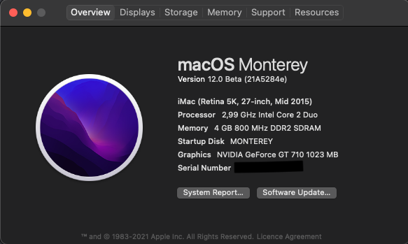

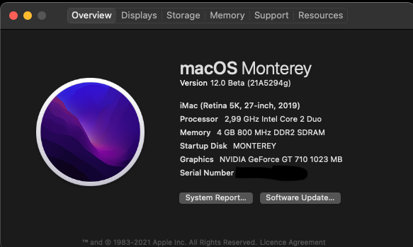

notobo Posted July 15, 2021 Share Posted July 15, 2021 Very old machine, low on ram, but working with Beta 3. SSDT by khronokernel & project trashOS https://github.com/khronokernel/trashOS EFI.zip 2 Quote Link to comment https://www.insanelymac.com/forum/topic/348279-hp-dc7800sff-monterey/ Share on other sites More sharing options...

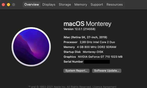

notobo Posted July 16, 2021 Author Share Posted July 16, 2021 addendum: Clover is 5137, update or vanilla install is possible only with smbios imac16,1+ or macpro6,1+, later you can go back to 15,1... sound is impossible, alc or voodoo with clover inject, here is with voodoo installed with l.e. kext tool in l/e... voodoo is 2.8.1 but patched for internal HP 7800 loudspeaker. if you don't need internal ls, you can go for last voodoo as slice recommend. bt is rather old usb adapter csr 0x0a12, patching with brcm works. VoodooHDA.kext.zip Quote Link to comment https://www.insanelymac.com/forum/topic/348279-hp-dc7800sff-monterey/#findComment-2762985 Share on other sites More sharing options...

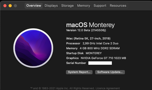

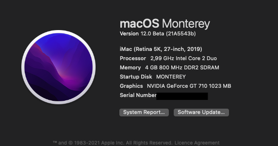

notobo Posted July 28, 2021 Author Share Posted July 28, 2021 beta 4 installed 1 Quote Link to comment https://www.insanelymac.com/forum/topic/348279-hp-dc7800sff-monterey/#findComment-2763769 Share on other sites More sharing options...
notobo Posted August 31, 2021 Author Share Posted August 31, 2021 Beta 6 without problems. Quote Link to comment https://www.insanelymac.com/forum/topic/348279-hp-dc7800sff-monterey/#findComment-2765476 Share on other sites More sharing options...

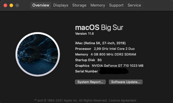

notobo Posted September 16, 2021 Author Share Posted September 16, 2021 (edited) Big Sur 11.6 works everything including VoodooHDA. Still with Clover 5138. Edited September 16, 2021 by notobo 1 Quote Link to comment https://www.insanelymac.com/forum/topic/348279-hp-dc7800sff-monterey/#findComment-2766589 Share on other sites More sharing options...
notobo Posted October 10, 2021 Author Share Posted October 10, 2021 Beta 9. Perfect. You'll need Smbios iMac17,1 for installation and Kepler patch for Nvidia. 1 Quote Link to comment https://www.insanelymac.com/forum/topic/348279-hp-dc7800sff-monterey/#findComment-2768886 Share on other sites More sharing options...

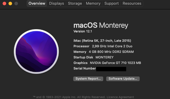

notobo Posted December 14, 2021 Author Share Posted December 14, 2021 everything ok...clover 5138, kepler patch 1 Quote Link to comment https://www.insanelymac.com/forum/topic/348279-hp-dc7800sff-monterey/#findComment-2773531 Share on other sites More sharing options...

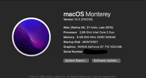

notobo Posted March 15, 2022 Author Share Posted March 15, 2022 12.3...perfect.. on clover 5138 Quote Link to comment https://www.insanelymac.com/forum/topic/348279-hp-dc7800sff-monterey/#findComment-2778272 Share on other sites More sharing options...

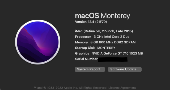

notobo Posted May 17, 2022 Author Share Posted May 17, 2022 12.4 21F79 no problem installing Same as before, stil on OC 0.76 and Clover 5138. Same EFI, same Voodoo in Library and Geforce Keppler Patcher after install. 1 Quote Link to comment https://www.insanelymac.com/forum/topic/348279-hp-dc7800sff-monterey/#findComment-2782427 Share on other sites More sharing options...

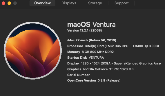

notobo Posted February 22, 2023 Author Share Posted February 22, 2023 (edited) Update legacy Ventura 13.2.1 with OC 0.8.9 SMBIOS 19,1 because lower doesn't work at all with CSR BT dongle. Old Voodoo HDA patched for Hp7800SFF in Library folder. For installation used USB 2.0 Hub for BT and Logitech Performance dongles. After install Post Root patched for Nvida Kepler with OCLP 0.6.2 with KDK. Patching for USB1,1 doesn't work good with IOHIDFamily, however, I leave dongles in USB Hub and everything is now under USB2 with 7 ports+ 4 from HUB. Tried old OCLP Alpha to patch without KDK, but compiled binary was not good. Searching for newer Alpha. EFI.zip Edited February 22, 2023 by notobo 1 Quote Link to comment https://www.insanelymac.com/forum/topic/348279-hp-dc7800sff-monterey/#findComment-2801688 Share on other sites More sharing options...
