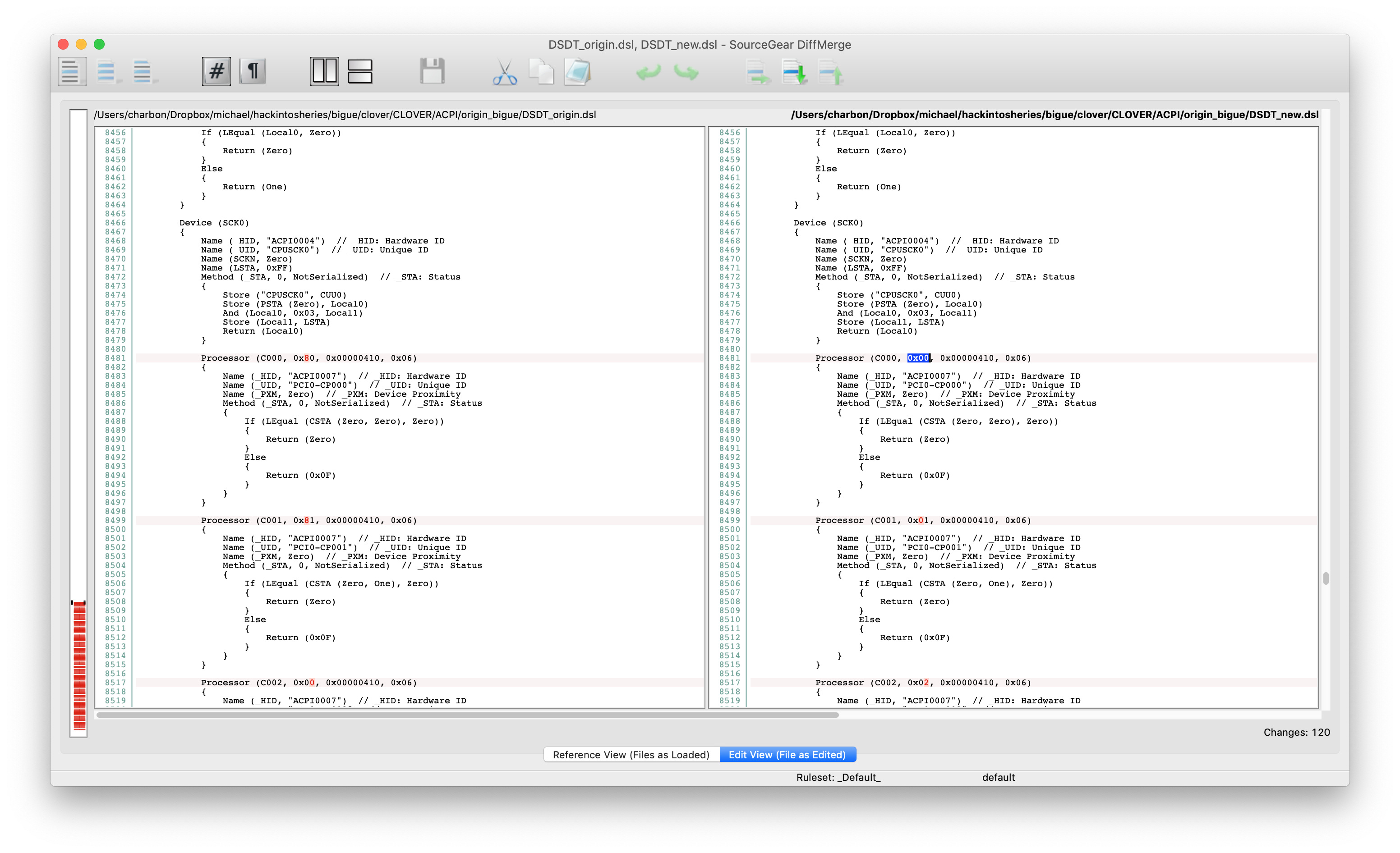

All right, I was wrong. The 3 years old path that I used to boot my hack was not deleting those lines, it was renaming the cpus!
I had found the "fixproc.rb" script on ox86.net (attached). This is the only modification nedd to boot my hack. The explanation was
Quote
Well, the problem in the microcode patch from intel or BIOS ACPI tables. The error in APIC Core ID's:
ACPI Processor ID 00h
APIC ID 02h (should be 00h)
ACPI Processor ID 02h
APIC ID 04h?(should be 02h)
ACPI Processor ID 04h
APIC ID 06h?(should be 04h)
etc
There's no software solution.

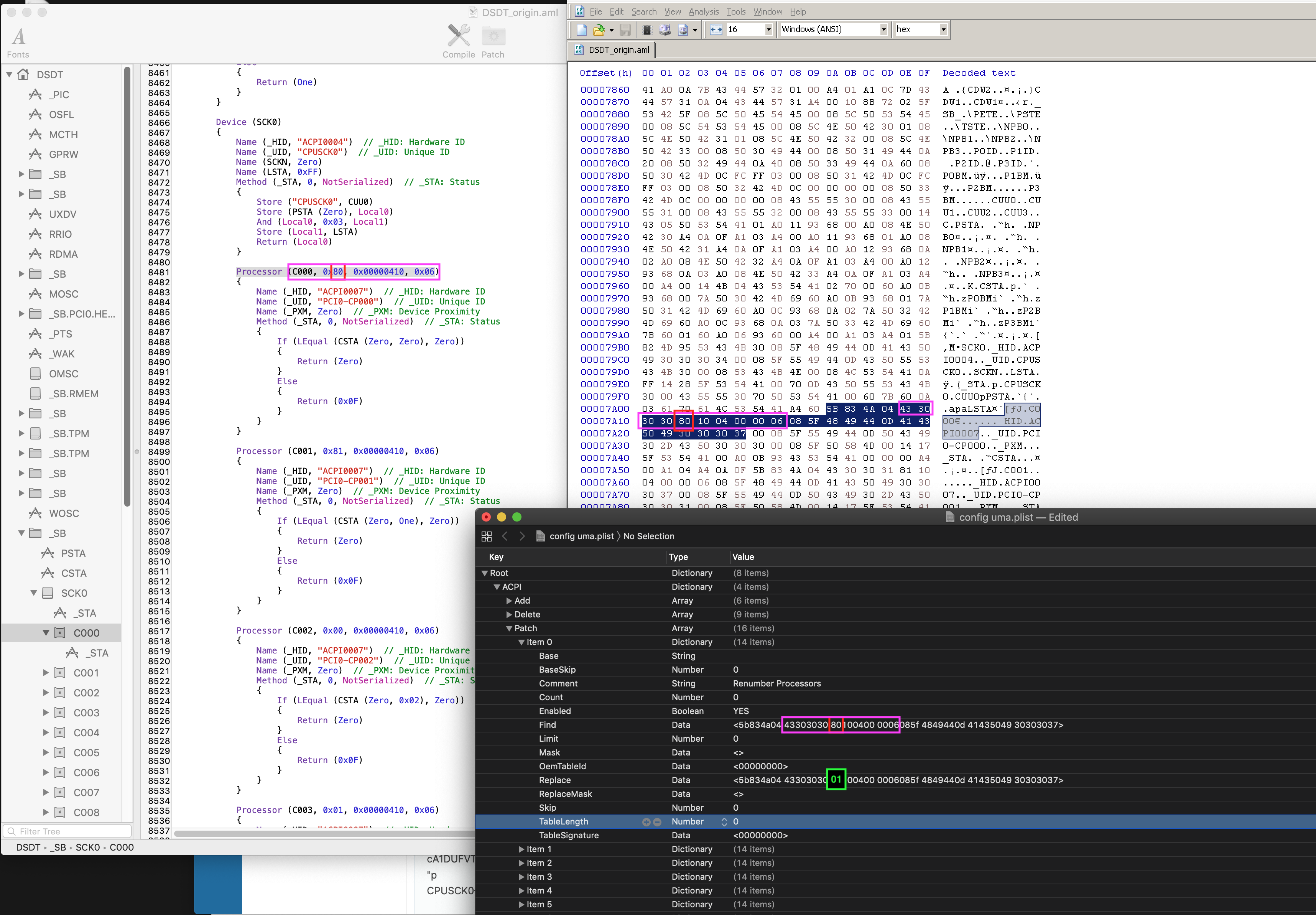

My method for this kind of patch is to search for whatever I need to change in the DSDT, then find the same thing with a Hex editor, and select a bit more on both ends just to make sure it's unique and will only be found/replaced once (can be verified by searching for the selected hex string)
Then just create a find/replace ACPI patch in OC config.
In your case you may need to do a bunch at once with a very long find/replace string.
466812571_ScreenShot2021-06-29at12_07_23PM.thumb.png.eaf0943b44a9c7282c50f905312ea3e2.png
I have a HP Z820 with dual 2667 CPU's and it took a few days to figure out this bug a few years back. I never switched that machine from clover because of all the necessary DSDT edits you need in order to avoid the boot panic and then also to get proper PM. But I guess OC is mature enough to try again.
Same problem as you have here though.
Here's the reference from my previous work on this: https://www.insanelymac.com/forum/topic/335860-guide-2018-z820-high-sierra-the-great-guide-sucess/?do=findComment&comment=2639436
many thanks for your input @theroadw! All this time, i had never figured once could look at the binary .aml file to figure out the necessary patches! I have put together a small ruby script to fix the processors. Here are all the patches!
Edit : I confirm the patches work!
