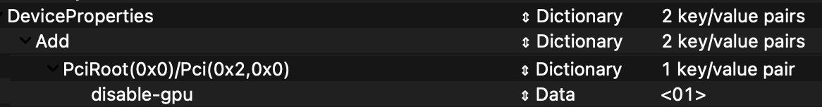

miliuco Posted June 21, 2021 Share Posted June 21, 2021 (edited) To have 2 graphics cards and use one with Windows and the other with macOS, you have to: connect 1 cable to the monitor from each GPU (2 x HDMI or one HDMI and one DisplayPort) to avoid changing the cable from one GPU to another when changing systems disable the GPU you don't want to use in Windows disable the GPU you don't want to use on macOS. I don't know how to disable a GPU in Windows but to do it in macOS there are sites with instructions. Disabling desktops unsupported GPUs (SSDT-GPU-DISABLE) Option 2: Blocking discrete GPUs from MacOS The easiest way to do this is with WhateverGreen's disable-gpu switch. You have to know the PCI path to the GPU that you want to disable. For example, if it's PciRoot(0x0)/Pci(0x2,0x0) DeviceProperties looks like this: Edited June 21, 2021 by miliuco 2 Link to comment Share on other sites More sharing options...
