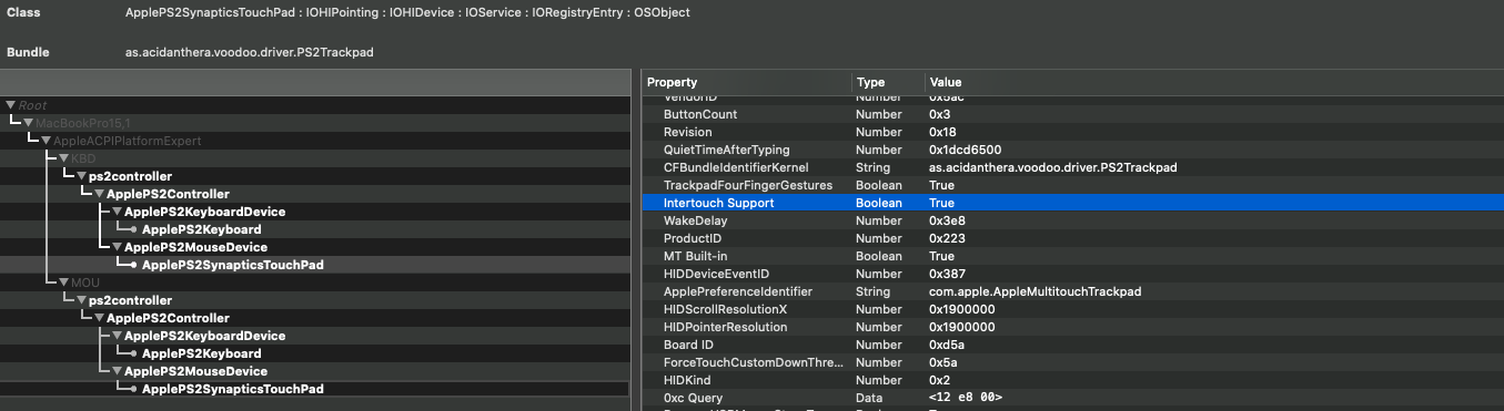

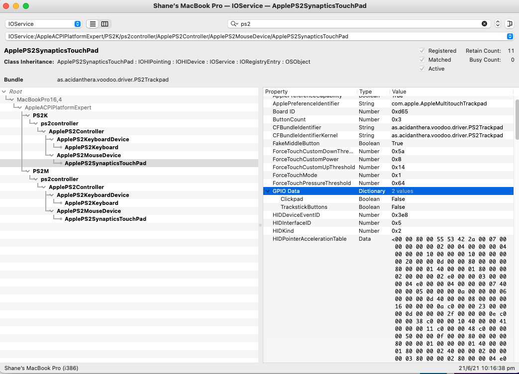

Avery B Posted June 20, 2021 Share Posted June 20, 2021 (edited) Do you have VoodooInput, and is it attaching to ApplePS2SynapticsTrackpad? Also, does it say in ioreg (under ApplePS2SynapticsTrackpad) whether or not it has "Intertouch support"? That generally means that the trackpad also works over SMBus, which can send a lot more info and has better multitouch support (much better than Rehabman's and Acidanthera's VoodooPS2) Spoiler If the above is true, you may also find an entry with GPIO data which is used by VoodooRMI (My SMBus driver for Synaptics trackpads) Spoiler Edited June 20, 2021 by 1Revenger1 Link to comment https://www.insanelymac.com/forum/topic/348133-voodoops2-by-acidanthera/#findComment-2761336 Share on other sites More sharing options...

Avery B Posted June 21, 2021 Share Posted June 21, 2021 (edited) I've seen some trackpads work over both PS2 and I2C (and I've also seen the opposite where it works on I2C but not PS2) The PS2 tends to be a fallback I've found, which I'm guessing is used in the BIOS and other legacy places. Smbus is a little wacky, the trackpad works over PS2 just fine. But the SMBus driver can start up and use the trackpad, though this requires some information from the PS2 side (the GPIO information I showed above). Plus the trackpad can only be reset over PS2 as far as I can tell looking at the synaptics source. Synaptic SMBus trackpads are weird since unlike the I2C trackpads, they rely on things over PS2 lol Edited June 21, 2021 by 1Revenger1 Link to comment https://www.insanelymac.com/forum/topic/348133-voodoops2-by-acidanthera/#findComment-2761354 Share on other sites More sharing options...

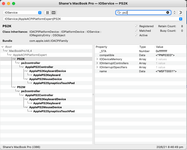

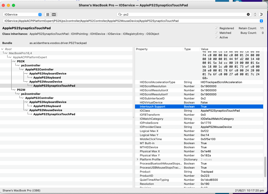

SavageAUS Posted June 21, 2021 Author Share Posted June 21, 2021 (edited) Ok i have found this info looking at my ioreg. Trackpad still not working in Monterey but working in Bis Sur except the "click" buttons do not function. Only tapping on the touchpad. Spoiler Spoiler Edited June 21, 2021 by SavageAUS Link to comment https://www.insanelymac.com/forum/topic/348133-voodoops2-by-acidanthera/#findComment-2761371 Share on other sites More sharing options...
SavageAUS Posted June 21, 2021 Author Share Posted June 21, 2021 I got it working in Monterey by using SSDT-XOSI and it’s relevant patch but that seems sub optimal and the “click” buttons on my trackpad don’t work (they work with rehabmans version)Windows is working fine from what I can see but yet to test Big Sur. Sent from my iPhone using Tapatalk Link to comment https://www.insanelymac.com/forum/topic/348133-voodoops2-by-acidanthera/#findComment-2761373 Share on other sites More sharing options...
