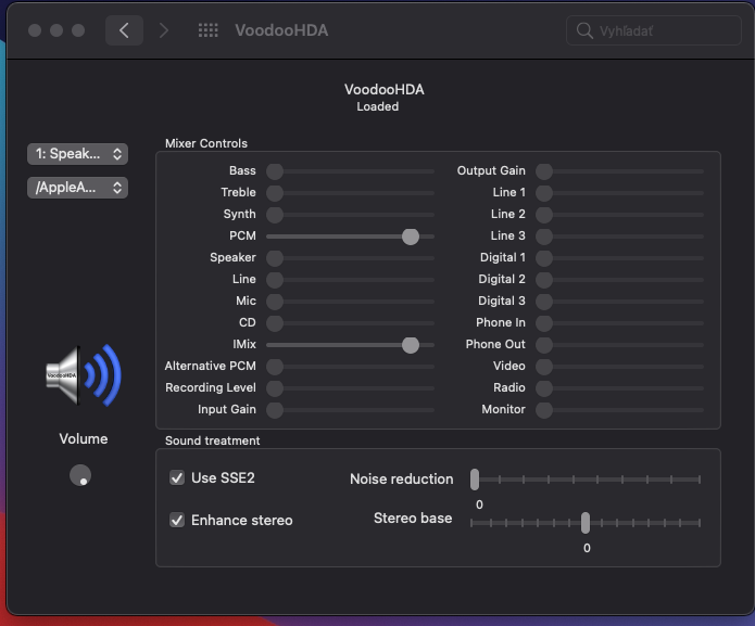

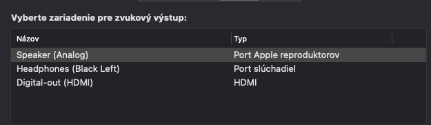

Matess_K Posted June 9, 2021 Author Share Posted June 9, 2021 On 6/5/2021 at 6:55 AM, Slice said: I don't think it is related. Consider to use VoodooHDA instead. Hi, I tried and it kinda works - thanks. It recognized speakers and headphones, however sound comes only from headphones when chosen. When speakers are chosen there is no sound. Do you have any idea what could cause this? Thanks Quote Link to comment https://www.insanelymac.com/forum/topic/348019-alc-287-lenovo-legion-s7-troubleshooting/#findComment-2760383 Share on other sites More sharing options...
Slice Posted June 9, 2021 Share Posted June 9, 2021 There are some tutorials how to tune voodooHDA. You have to produce a codec dump with the utility getdump and then analyse it. Quote Link to comment https://www.insanelymac.com/forum/topic/348019-alc-287-lenovo-legion-s7-troubleshooting/#findComment-2760402 Share on other sites More sharing options...

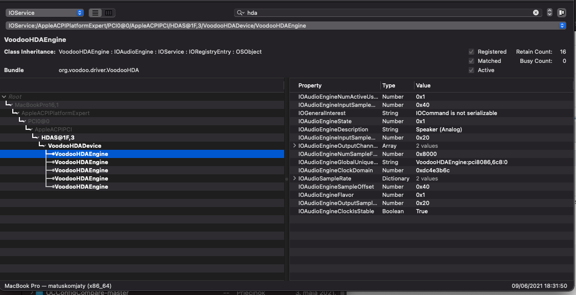

Matess_K Posted June 10, 2021 Author Share Posted June 10, 2021 13 hours ago, Slice said: There are some tutorials how to tune voodooHDA. You have to produce a codec dump with the utility getdump and then analyse it. I managed to produce codec dump and noticed that the speakers nodes are disabled, I tried to edit the config.plist inside the VoodooHDA.kext however it didn't manage to solve the problem. Could you point me to some tutorial or help me? Thanks codecdumpvoodoohda.rtf Info.plist Quote Link to comment https://www.insanelymac.com/forum/topic/348019-alc-287-lenovo-legion-s7-troubleshooting/#findComment-2760438 Share on other sites More sharing options...
Slice Posted June 10, 2021 Share Posted June 10, 2021 9 hours ago, Matess_K said: I managed to produce codec dump and noticed that the speakers nodes are disabled, I tried to edit the config.plist inside the VoodooHDA.kext however it didn't manage to solve the problem. Could you point me to some tutorial or help me? Thanks codecdumpvoodoohda.rtf 26.06 kB · 1 download Info.plist 4.21 kB · 0 downloads As I see the Speaker is present Playback: nid=23 [pin: Speaker (Analog)] | + <- nid=2 [audio output] [src: pcm] bindSeq=00000001 And can be tuned by rotating knob Quote Link to comment https://www.insanelymac.com/forum/topic/348019-alc-287-lenovo-legion-s7-troubleshooting/#findComment-2760488 Share on other sites More sharing options...
