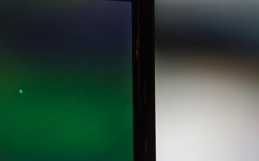

If I connect it while the computer running, the main screen(hdmi one) starts to glitch and blink, and the second one (dvi that is converted) gets a view with a green filter and blur.
If I connect it when computer is not working and boot, the screens became like the picture I've added below.(image.png)
The left one (green one) is the converted one, and its all green filtered. The right one is the main one with original HDMI.
But the login screen doesn't show up.

I am adding some videos how it happens.
The green one is the one with converter.
When I try to open my computer with both connected, this happens.
No login screen shows up.
Just blank wallpapers. One is green filtered. And making white glitch in the top..
Help me please, I am afraid if nobody looks in this category :(
