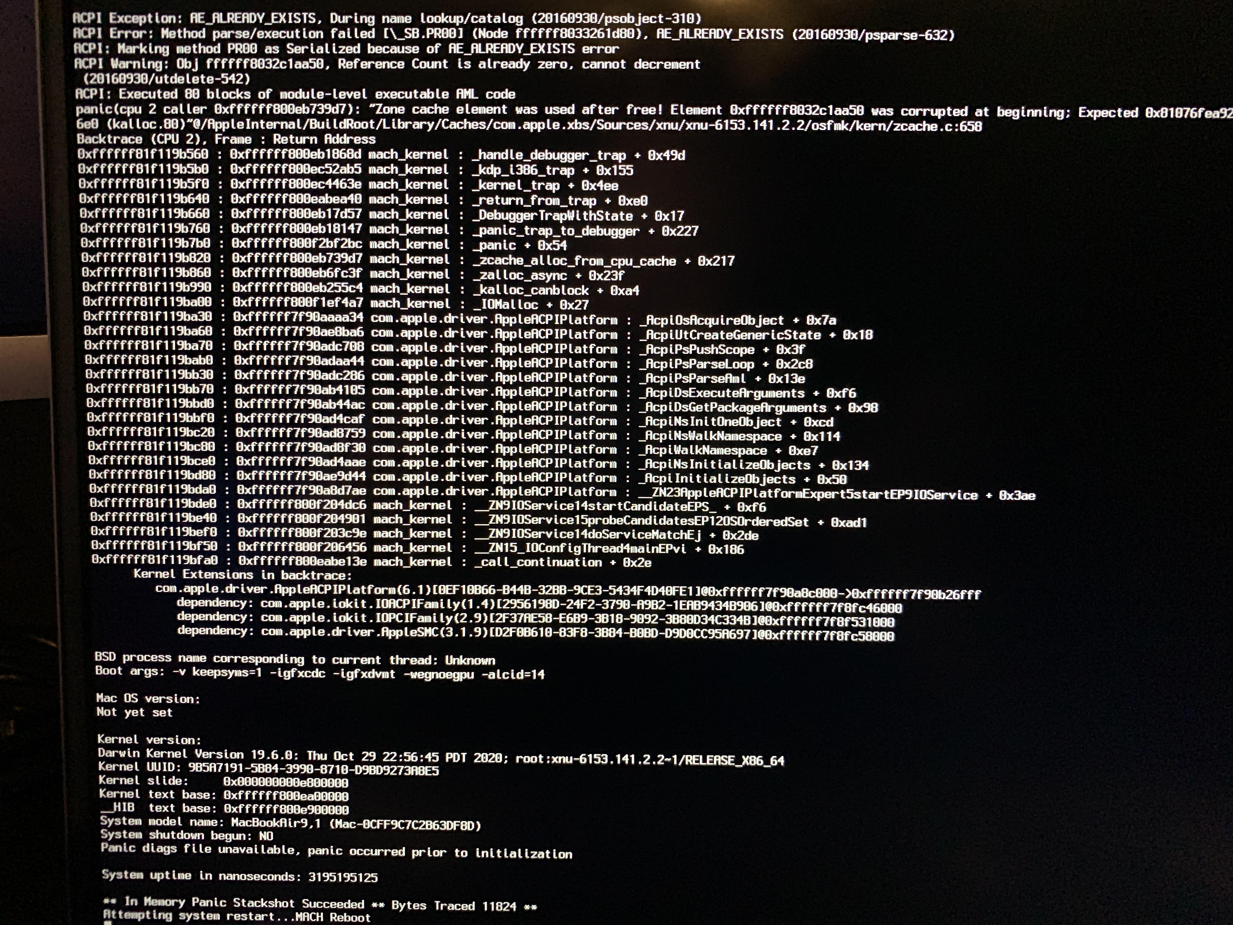

sojab0on0005 Posted March 17, 2021 Author Share Posted March 17, 2021 (edited) I know but i cant get the usb to boot I have attached a DSDT created with a windows cmd script SSDTTime Creation of usb with goes normally but clover has issues booting also has opencore I already have the beta intelwifi drivers Big sur i will have to check on creating a usb with big sur DSDT.aml Edited March 17, 2021 by sojab0on0005 Used tool names that are not suported Quote Link to comment https://www.insanelymac.com/forum/topic/347059-hp-pavalion-cs4838nd-mac-os/#findComment-2753309 Share on other sites More sharing options...

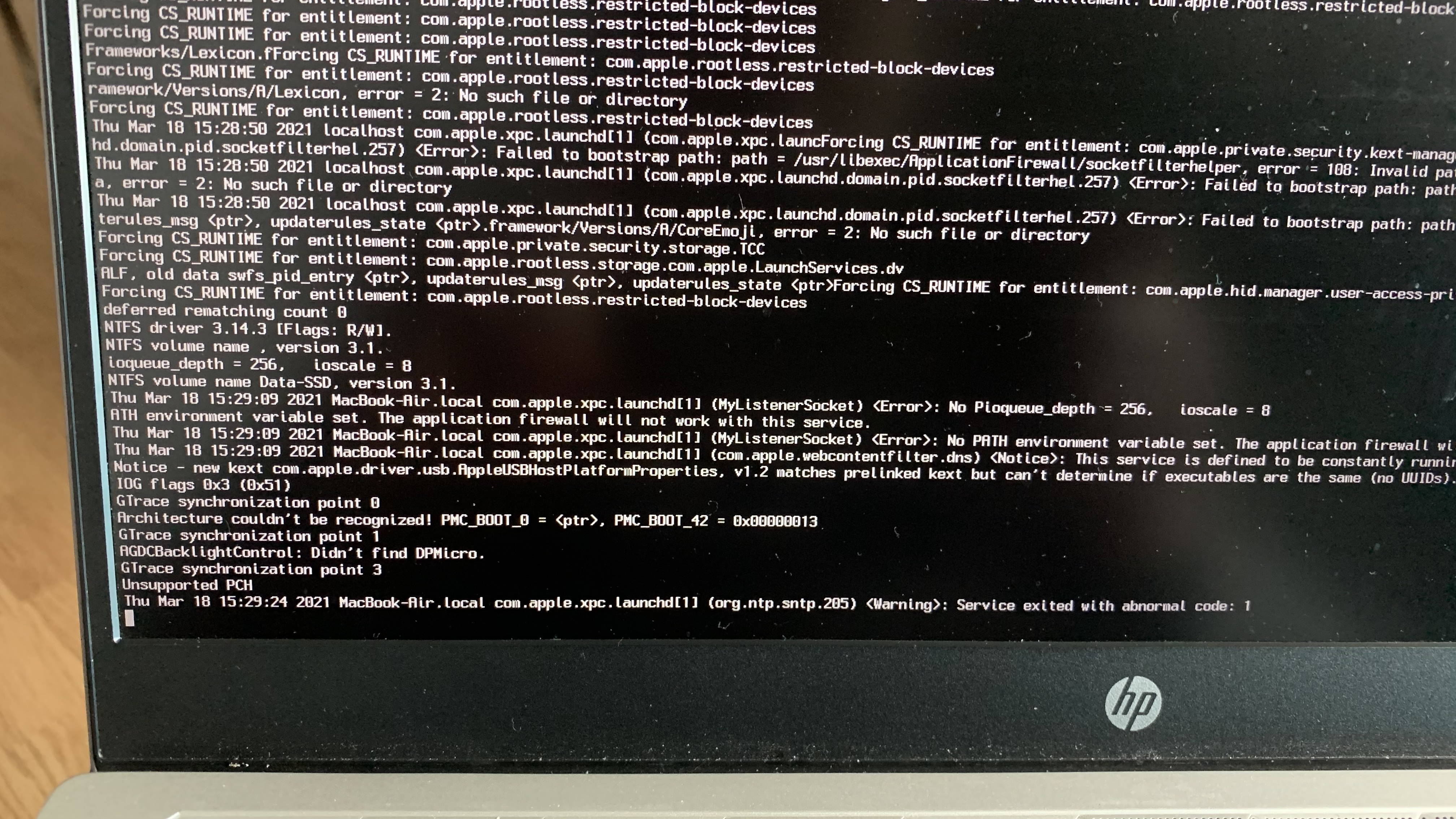

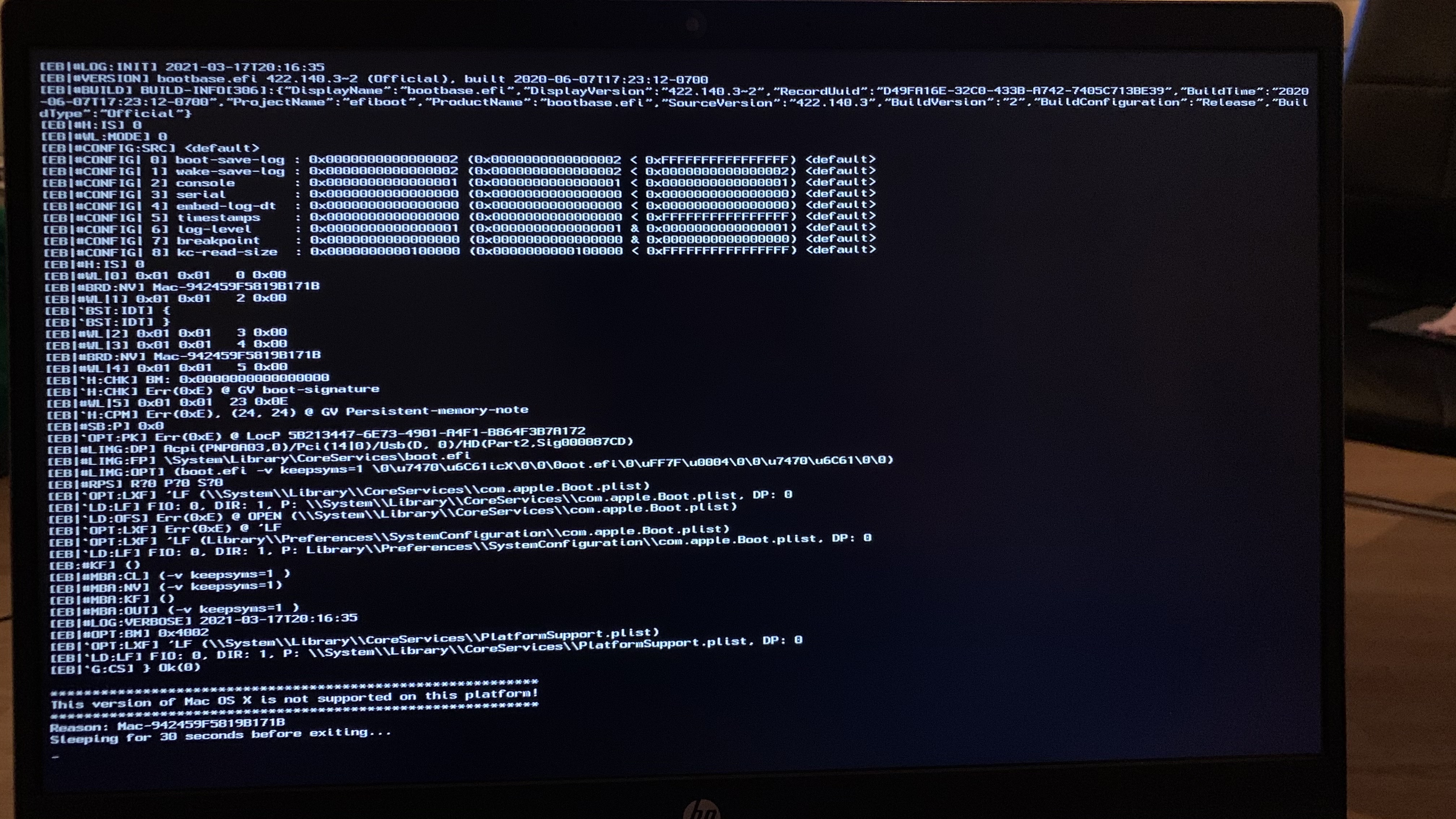

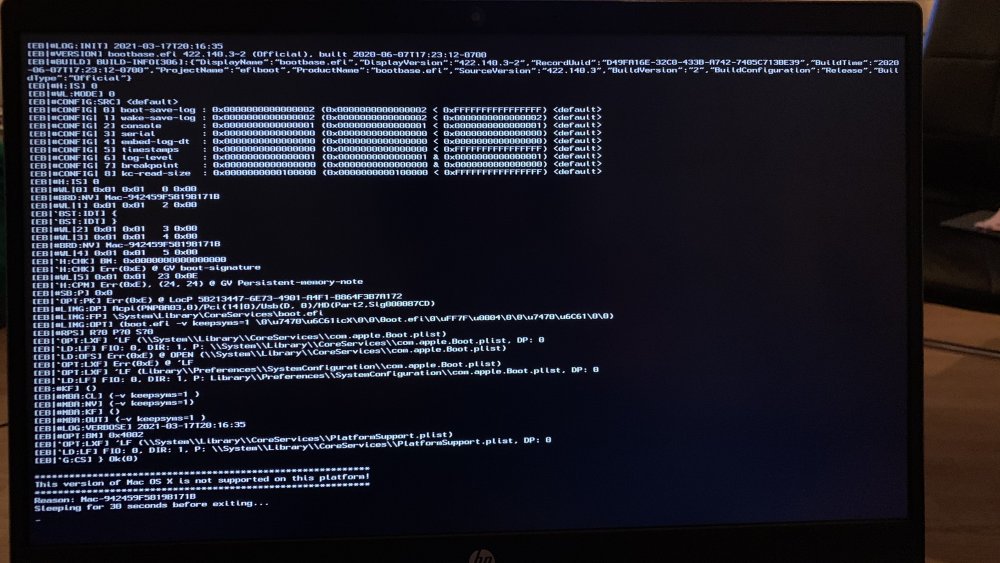

sojab0on0005 Posted March 17, 2021 Author Share Posted March 17, 2021 Any advice to create a big sur usb drive with working bootloader I have the BDU tool but when i boot clover that it downloads and put on it i get a bunch error texts on boot See attached screenshot Opencore does error out i a simmular way. Quote Link to comment https://www.insanelymac.com/forum/topic/347059-hp-pavalion-cs4838nd-mac-os/#findComment-2753312 Share on other sites More sharing options...
Slice Posted March 18, 2021 Share Posted March 18, 2021 This error means that the version of macOS you try to install can't be installed on the computer with Board-ID=Mac-942... See your config.plist -> SMBIOS section. Quote Link to comment https://www.insanelymac.com/forum/topic/347059-hp-pavalion-cs4838nd-mac-os/#findComment-2753333 Share on other sites More sharing options...

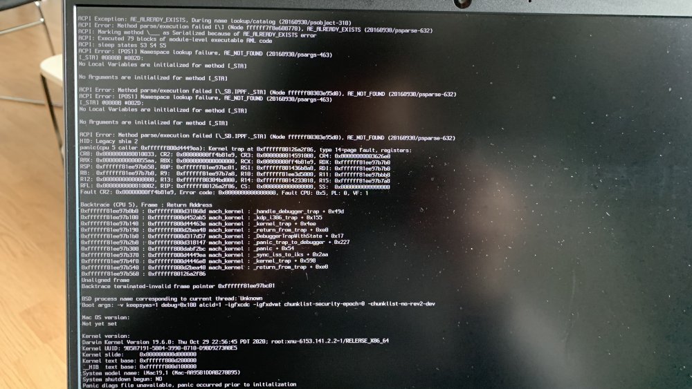

sojab0on0005 Posted March 18, 2021 Author Share Posted March 18, 2021 (edited) After some fideling with opencore and the icelake ssdts i gotnit to a kernel panic see attached smbios set to MacBookAir9,1 as advised in opencore guide opencore-2021-03-18-130955.txt opencore-2021-03-18-131749.txt opencore-2021-03-18-131823.txt opencore-2021-03-18-120508.txt opencore-2021-03-18-121618.txt opencore-2021-03-18-122121.txt Edited March 18, 2021 by sojab0on0005 Smbios setting not given added multiple open core logs Quote Link to comment https://www.insanelymac.com/forum/topic/347059-hp-pavalion-cs4838nd-mac-os/#findComment-2753350 Share on other sites More sharing options...

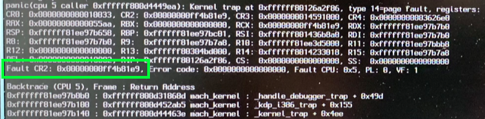

shl628 Posted March 18, 2021 Share Posted March 18, 2021 (edited) You may need to set the DevirtualiseMmio option to True and set the MmioWhitelist for a specific MMIO. https://dortania.github.io/OpenCore-Install-Guide/troubleshooting/extended/kernel-issues.html#kernel-panic-on-invalid-frame-pointer See also my reply in the topic below, which has a similar problem. Or, convert 0xFF4B81E9 address into decimal and add it to the MmioWhitelist in the Booter section of Config.plist. Of course, this also requires the DevirtualiseMmio option to be set to True. Edited March 18, 2021 by shl628 Quote Link to comment https://www.insanelymac.com/forum/topic/347059-hp-pavalion-cs4838nd-mac-os/#findComment-2753354 Share on other sites More sharing options...
sojab0on0005 Posted March 18, 2021 Author Share Posted March 18, 2021 Will tey that when i can do it, i have rebuild the usb drive woth same smbios settings and opencore now it pannics like i have de dsdt files for icelake and for set the values for hp in the config with propertree. Quote Link to comment https://www.insanelymac.com/forum/topic/347059-hp-pavalion-cs4838nd-mac-os/#findComment-2753360 Share on other sites More sharing options...
Slice Posted March 18, 2021 Share Posted March 18, 2021 Vendor HP usually requires quirk Lapic to be set. Quote Link to comment https://www.insanelymac.com/forum/topic/347059-hp-pavalion-cs4838nd-mac-os/#findComment-2753362 Share on other sites More sharing options...
sojab0on0005 Posted March 18, 2021 Author Share Posted March 18, 2021 (edited) i hd that option on as well <?xml version="1.0" encoding="UTF-8"?> <!DOCTYPE plist PUBLIC "-//Apple//DTD PLIST 1.0//EN" "http://www.apple.com/DTDs/PropertyList-1.0.dtd"> <plist version="1.0"> <dict> <key>LapicKernelPanic</key> <true/> </dict> </plist> copied directly from my config.plist file After some fiddeling with the config.plist in opencore configurator to set the CR2 fault adress it now goes allot furhter in booting but it blocks at unsuported PCH service exited with abnormal code 1 Added boot hang picture Edited March 18, 2021 by sojab0on0005 did the CR2 adress change hnags at unsuported PCH Quote Link to comment https://www.insanelymac.com/forum/topic/347059-hp-pavalion-cs4838nd-mac-os/#findComment-2753363 Share on other sites More sharing options...

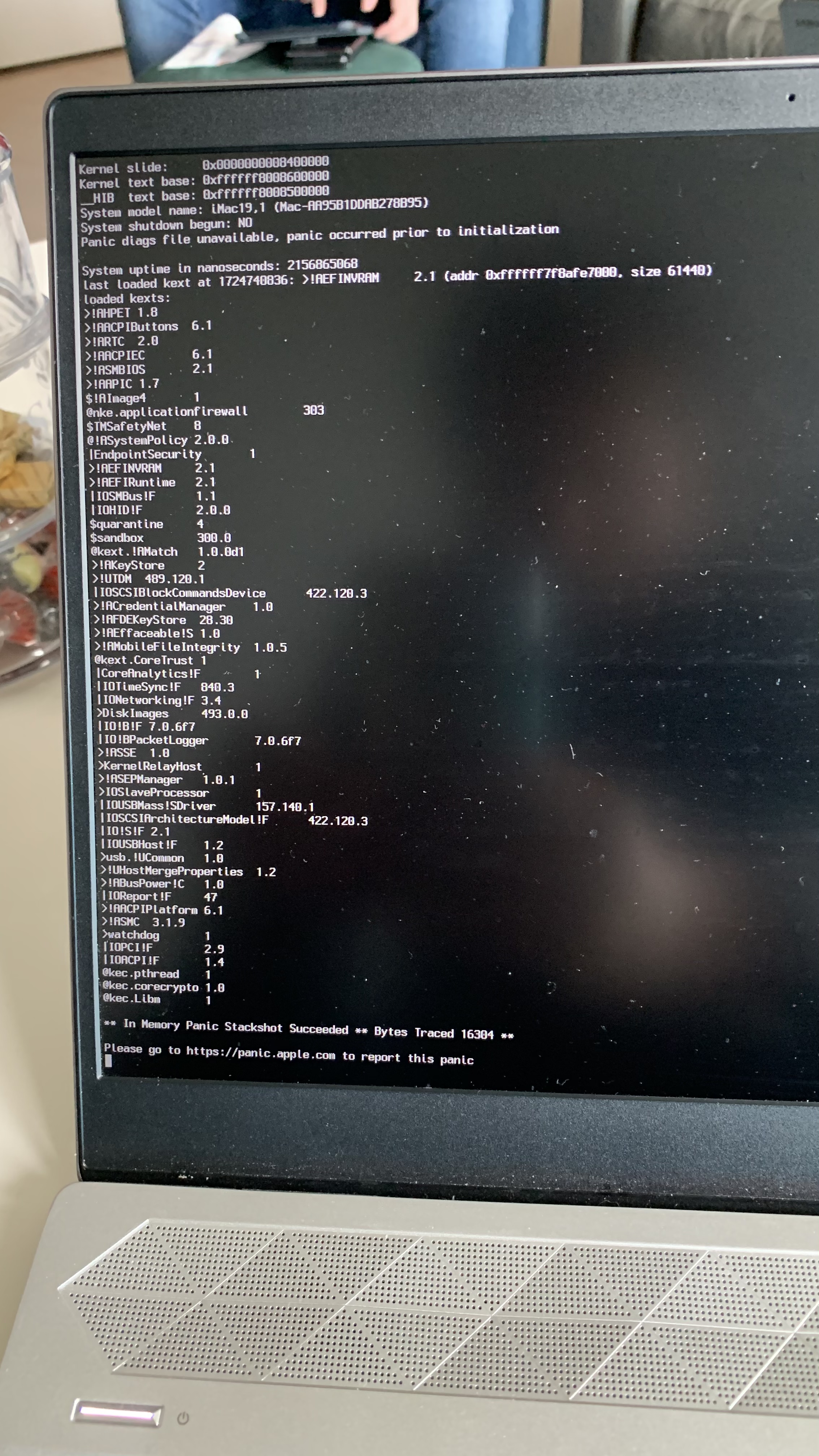

sojab0on0005 Posted March 18, 2021 Author Share Posted March 18, 2021 (edited) Very strange After installing from usb it boot to the installer part where it estiamtes timed goes trough with that part but when I try to boot the next run from the m.2 ssd it panics and creates a kernel dump some where but where and how can I get that dump to see what is goon on Cant seen to find the reason, except for the aml files it spits contant errors with reading faults during boot Edited March 18, 2021 by sojab0on0005 Quote Link to comment https://www.insanelymac.com/forum/topic/347059-hp-pavalion-cs4838nd-mac-os/#findComment-2753374 Share on other sites More sharing options...
