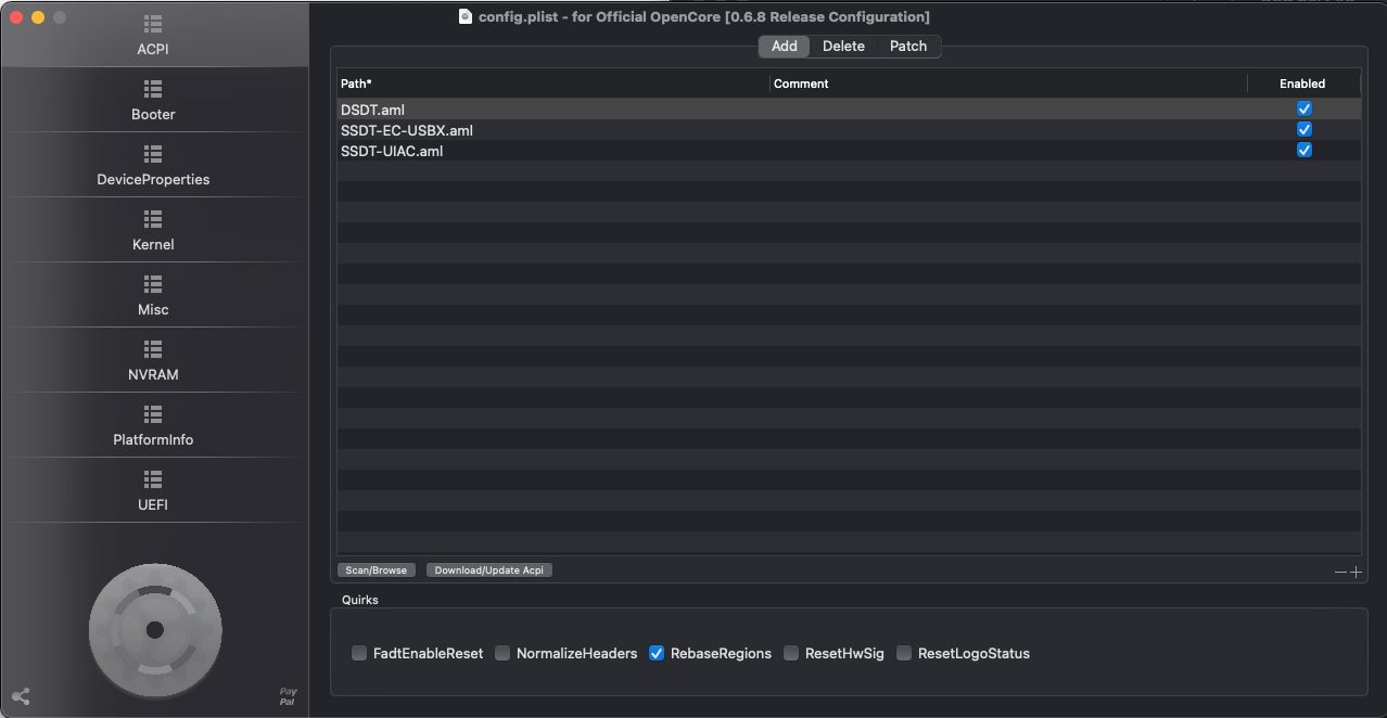

MaLd0n Posted April 11, 2021 Author Share Posted April 11, 2021 17 hours ago, Alexlex said: Thank you so much for this. Could you help me with ACPI solution? DSDT.aml.zip remove ssdts, select Rebase regions in acpi tab Link to comment https://www.insanelymac.com/forum/topic/346606-hackbeast-z490-vision-g-full-dsdt-patches-clover-or-opencore-guide-and-discussion/#findComment-2755259 Share on other sites More sharing options...

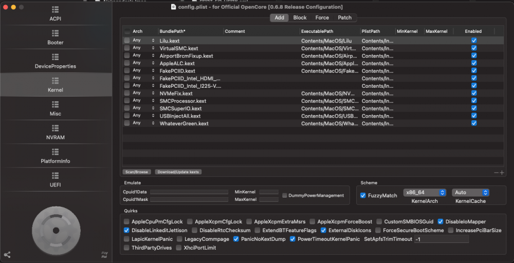

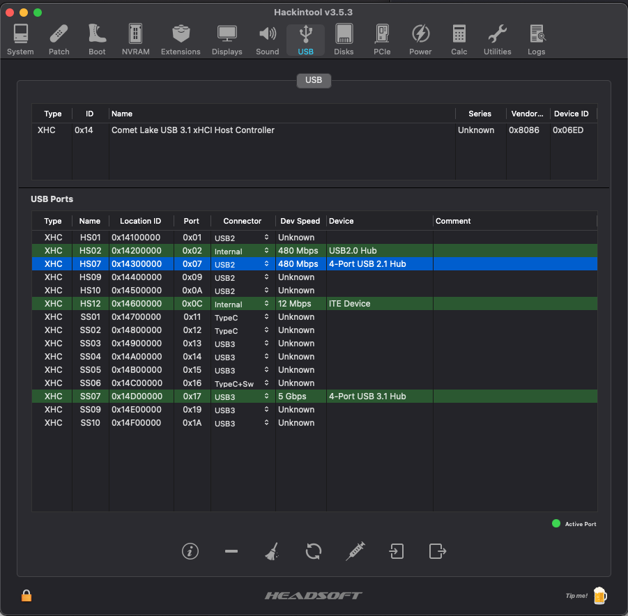

Alexlex Posted April 12, 2021 Share Posted April 12, 2021 19 hours ago, Alexlex said: Thanks a lot. Everything is running smoothly except sleep. Auto wake after fans shut down. Any ideas? Followed SchmockLords guide for both sleep and BIOS settings. https://github.com/SchmockLord/Hackintosh-Intel-i9-10900k-Gigabyte-Z490-Vision-D Settings are for Vision D, but they seem to apply to Z490 Vision G as well. Forgot to say that I am also running two Sata disks in OS Raid 0 on this setup. Attaching zipped EFI, and export from IORegistryExplorer if you have the time to take a look. Changed computer name to IMac btw. Best Alex EFI.zip 3.88 MB · 1 download Aleksander’s Imac.ioreg 6.05 MB · 0 downloads Apparently it's is my Broadcom BCM943602CS Bluetooth Internal USB connection that is waking up sleep. I tried without it connected and sleep works fine, but naturally I have no Bluetooth without it connected. I have both Bluetooth usb and enclosure USB 2 hub mapped to HS02, marked as internal. I tried with just the Bluetooth connector connected but still no sleep, also tried darkwake=10 as bootflag, but still no sleep. Any tips at fixing Bluetooth usb instant sleep wake would be really appreciated. Thanks a lot in advance. Link to comment https://www.insanelymac.com/forum/topic/346606-hackbeast-z490-vision-g-full-dsdt-patches-clover-or-opencore-guide-and-discussion/#findComment-2755348 Share on other sites More sharing options...
MaLd0n Posted April 13, 2021 Author Share Posted April 13, 2021 On 4/11/2021 at 2:52 PM, jd69 said: @MaLdOn Post one Full Dump with Ioreg.https://www.olarila.com/topic/10301-olarila-runme-dumper/https://olarila.com/files/Utils/RunMe.app.ziphttps://olarila.com/files/Utils/IORegistryExplorer.app.zip 13 hours ago, Alexlex said: Apparently it's is my Broadcom BCM943602CS Bluetooth Internal USB connection that is waking up sleep. I tried without it connected and sleep works fine, but naturally I have no Bluetooth without it connected. I have both Bluetooth usb and enclosure USB 2 hub mapped to HS02, marked as internal. I tried with just the Bluetooth connector connected but still no sleep, also tried darkwake=10 as bootflag, but still no sleep. Any tips at fixing Bluetooth usb instant sleep wake would be really appreciated. Thanks a lot in advance. remap ur usb. use ssdt uiac instead usbports.kext https://www.olarila.com/topic/9390-video-guide-usb-port-mapping-with-hackintool/ Link to comment https://www.insanelymac.com/forum/topic/346606-hackbeast-z490-vision-g-full-dsdt-patches-clover-or-opencore-guide-and-discussion/#findComment-2755398 Share on other sites More sharing options...

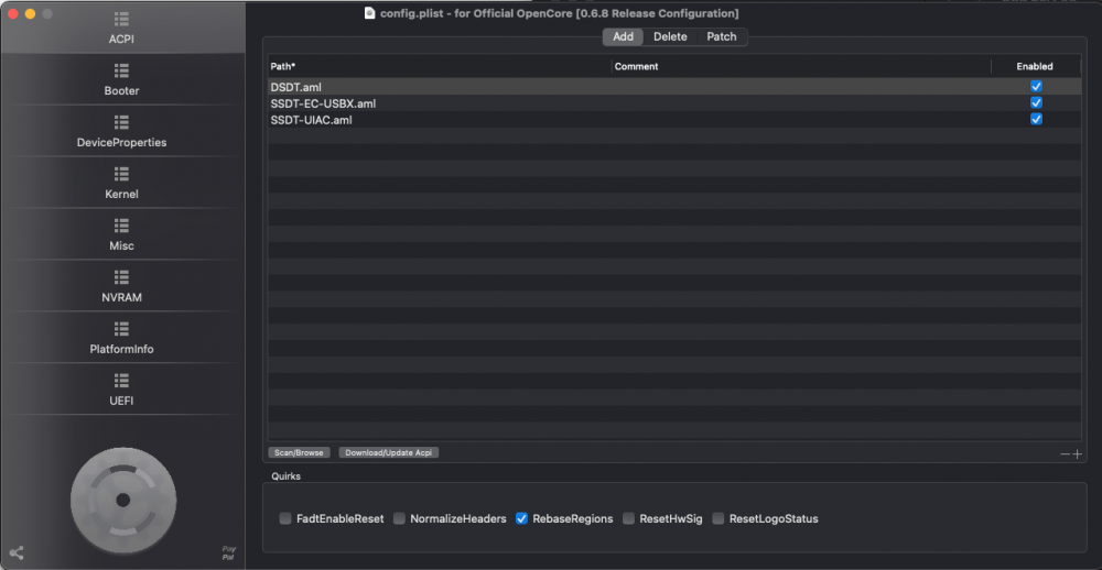

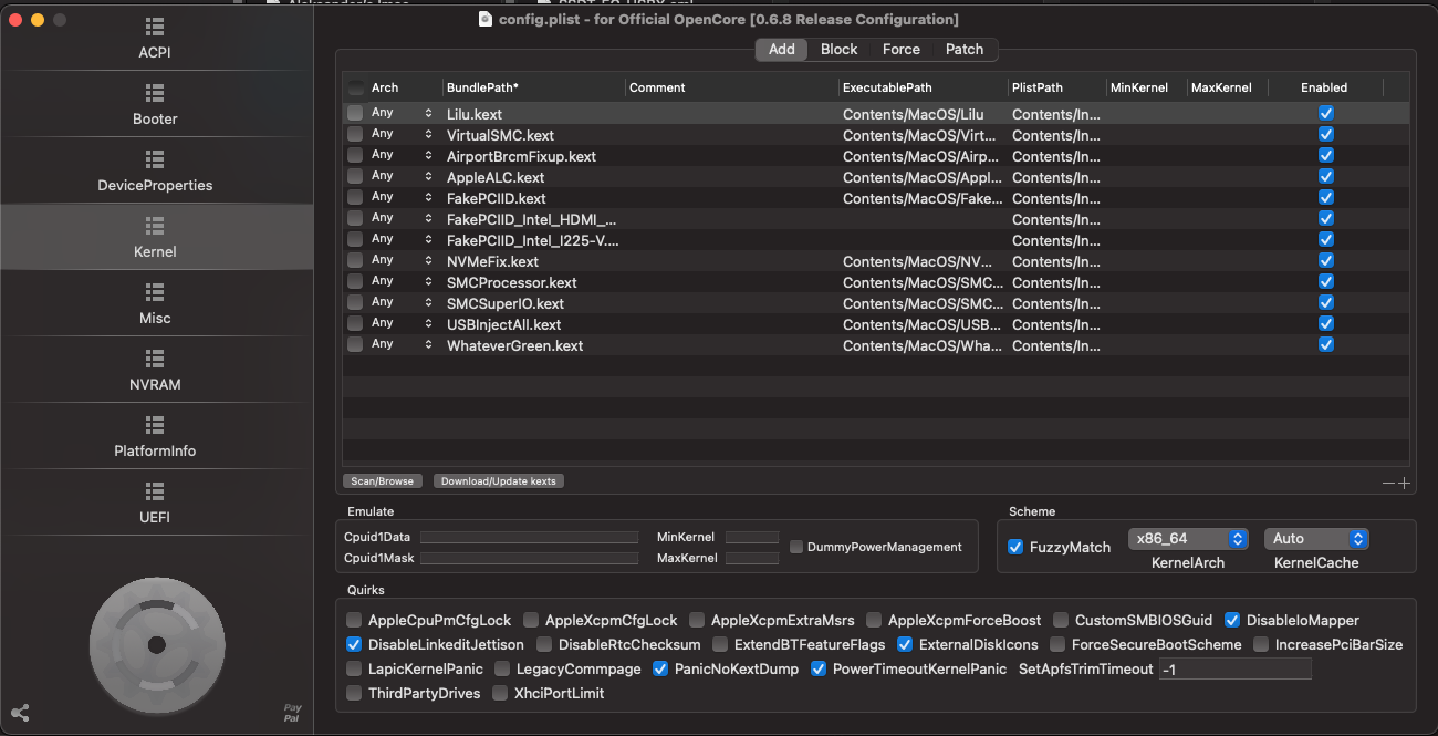

Alexlex Posted April 13, 2021 Share Posted April 13, 2021 15 hours ago, MaLd0n said: remap ur usb. use ssdt uiac instead usbports.kext https://www.olarila.com/topic/9390-video-guide-usb-port-mapping-with-hackintool/ Thank you, but still instant wake on sleep. I tried different combinations using only ssd uiac and usbinjectall.kext or USBports.kext with and without the internal ITE Device (HS12) in the mapping, But it must be something with this Wifi/blutooth combo card (HS02) that's messing things up. Maybe I should have some Broadcom Fixup kext? Thank you for all suggestions. Link to comment https://www.insanelymac.com/forum/topic/346606-hackbeast-z490-vision-g-full-dsdt-patches-clover-or-opencore-guide-and-discussion/#findComment-2755440 Share on other sites More sharing options...
MaLd0n Posted April 14, 2021 Author Share Posted April 14, 2021 23 hours ago, Alexlex said: Thank you for all suggestions. DSDT.aml.zip u dont need ssdt ec use power button for wake Link to comment https://www.insanelymac.com/forum/topic/346606-hackbeast-z490-vision-g-full-dsdt-patches-clover-or-opencore-guide-and-discussion/#findComment-2755552 Share on other sites More sharing options...
