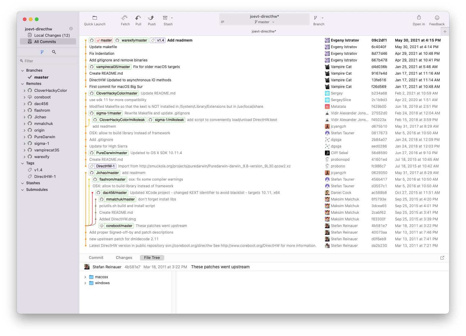

joevt Posted January 7, 2023 Share Posted January 7, 2023 I don't think the ACPIPlatformExpert method (which I refer to as "darwin" in my pciutils) or the IOPCIBridge method (which I refer to as "darwin2" in my pciutils) check the debug value, so you could use different values such as debug=0100 and it should still work. I can't get either of those two methods to work in 10.11 El Capitan but they do work in earlier macOS versions. IOPCIBridge method began with 10.10. I think ACPIPlatformExpert began with 10.6 but I've only tested down to 10.8 recently. I wonder if the IOPCIBridge method works on Apple Silicon Macs (since they don't have ACPI)? If it does work, it might not work for all devices. In that case, some modification would be required. DirectHW.kext is required for 10.11 and 10.5 and earlier (though I don't think anyone made a build for < 10.9 yet). If the IOPCIBridge method doesn't work for Apple Silicon Macs, then that needs a DirectHW.kext also. PowerPC Macs also require a DirectHW.kext. I think DirectHW.kext should implement a version of the IOPCIBridge method that can work in any macOS version and CPU architecture, since the intel-conf1 method does not allow reading PCIe extended configuration space (registers 0x100 to 0xFFF). 1 Link to comment https://www.insanelymac.com/forum/topic/346408-hwtools-for-mavericks-and-better-directhw-for-macos-big-sur-superiotool-mptable-osxpmem-iwleeprom-ectool-msrtool-ifdtool-inteltool-nvramtool-pciutils-370-and-flashrom-12/page/2/#findComment-2799698 Share on other sites More sharing options...
joevt Posted January 8, 2023 Share Posted January 8, 2023 On 2/2/2021 at 11:01 AM, Slice said: Andy, did you see this project? https://github.com/CloverHackyColor/directhw.git I've noticed a bug in that line of DirectHW forks. Originally, the list of user client methods was this: kReadIO kWriteIO kPrepareMap kReadMSR kWriteMSR as seen in these projects/files: ./coreboot-directhw/macosx/DirectHW/DirectHW.c ./coreboot-directhw/macosx/DirectHW/DirectHW.hpp ./dac456-DirectHW/macosx/DirectHW/DirectHW.c ./dac456-DirectHW/macosx/DirectHW/DirectHW.hpp ./flashrom-directhw/macosx/DirectHW/DirectHW.c ./flashrom-directhw/macosx/DirectHW/DirectHW.hpp ./mmalchuk-directhw/macosx/DirectHW/DirectHW.c ./mmalchuk-directhw/macosx/DirectHW/DirectHW.hpp ./mrAlexis-directhw/macosx/DirectHW/DirectHW.c ./mrAlexis-directhw/macosx/DirectHW/DirectHW.hpp ./PureDarwin-DirectHW/DirectHW.c ./PureDarwin-DirectHW/DirectHW.hpp ./startergo-DirectHW-BigSur/DirectHW/DirectHW.c ./startergo-DirectHW-BigSur/DirectHW/DirectHW.hpp ./vampirecat35-DirectHW-BigSur/DirectHW/DirectHW.c ./vampirecat35-DirectHW-BigSur/DirectHW/DirectHW.hpp Then kReadCpuID and kReadMem were added by Jichao like this: kReadIO kWriteIO kPrepareMap kReadMSR kWriteMSR kReadCpuID kReadMem as seen in these projects/files: ./CloverHackyColor-directhw/DirectHW.hpp ./Digits88-directhw/DirectHW.hpp ./Jichao-directhw/macosx/DirectHW/DirectHW.c ./Jichao-directhw/macosx/DirectHW/DirectHW.hpp ./lAbyOne-directhw/DirectHW.hpp ./matatata-directhw/DirectHW.hpp ./mspkg-directhw/DirectHW.hpp ./sigma-1-directhw/DirectHW.hpp ./somestupidgirl-DirectHW-BigSur/DirectHW/DirectHW.c ./somestupidgirl-DirectHW-BigSur/DirectHW/DirectHW.hpp ./warexify-directhw/DirectHW/DirectHW.c ./warexify-directhw/DirectHW/DirectHW.hpp But notice that that list is missing DirectHW.c for some of those projects. They have the following where kWriteMSR was moved to the end of the list: kReadIO kWriteIO kPrepareMap kReadMSR kReadCpuID kReadMem kWriteMSR as seen in these projects/files: ./CloverHackyColor-directhw/DirectHW.c ./Digits88-directhw/DirectHW.c ./lAbyOne-directhw/DirectHW.c ./matatata-directhw/DirectHW.c ./mspkg-directhw/DirectHW.c ./sigma-1-directhw/DirectHW.c so there could be a problem if a framework or library or executable doesn't match the kext and tries to use one of kReadCpuID, kReadMem, kWriteMSR. It probably would have been best for the kext and the framework or library to use a common header for the enumerations and structures used by both. 1 Link to comment https://www.insanelymac.com/forum/topic/346408-hwtools-for-mavericks-and-better-directhw-for-macos-big-sur-superiotool-mptable-osxpmem-iwleeprom-ectool-msrtool-ifdtool-inteltool-nvramtool-pciutils-370-and-flashrom-12/page/2/#findComment-2799744 Share on other sites More sharing options...
Slice Posted January 10, 2023 Share Posted January 10, 2023 @joevt, I think the bug should be fixed. Link to comment https://www.insanelymac.com/forum/topic/346408-hwtools-for-mavericks-and-better-directhw-for-macos-big-sur-superiotool-mptable-osxpmem-iwleeprom-ectool-msrtool-ifdtool-inteltool-nvramtool-pciutils-370-and-flashrom-12/page/2/#findComment-2799835 Share on other sites More sharing options...
joevt Posted January 11, 2023 Share Posted January 11, 2023 12 hours ago, Slice said: @joevt, I think the bug should be fixed. I'm working on the fork from warexify. It appears to be the fork that was most recently worked on. It has the vampirecat35 fork as upstream. It looks like it might have the best chance to work on ppc and arm64e and i386 and x86_64. To DirectHW I'm adding the IOPCIBridge access method that Apple created in IOPCIFamily for pciutils. This new access method (since macOS 10.10) replaces the ACPIPlatformExpert access method that Apple previously had (since macOS 10.6). Hopefully this access method can be used for ppc (macOS 10.4, 10.5) and arm64e (since macOS 11) by pciutils. My pciutils fork will have all the access methods (darwin for ACPIPlatformExpert; darwin2 for IOPCIBridge; darwin3 for my IOPCIBridge in DirectHW; intel-conf1 which uses the existing DirectHW code). The darwin3 access method will be superior to the intel-conf1 method since it will be able to access all the PCIe config space registers (000-FFF) instead of just the PCI config space registers (00-FF) and it will work with multiple IOPCIHostBridge. Apple Silicon Macs have multiple IOPCIHostBridge. PowerPC Macs also have multiple IOPCIHostBridge. Some Intel Macs may also have multiple IOPCIHostBridge but it seems that in some (all?) cases (such as X299 hackintosh) the PCI bus numbers are divided among them so they the don't have duplicate PCI bus numbers and you can access all the bus numbers from one IOPCIBridge. Link to comment https://www.insanelymac.com/forum/topic/346408-hwtools-for-mavericks-and-better-directhw-for-macos-big-sur-superiotool-mptable-osxpmem-iwleeprom-ectool-msrtool-ifdtool-inteltool-nvramtool-pciutils-370-and-flashrom-12/page/2/#findComment-2799861 Share on other sites More sharing options...
joevt Posted January 29, 2023 Share Posted January 29, 2023 I've finished On 1/11/2023 at 12:55 AM, joevt said: I'm working on the fork from warexify. It appears to be the fork that was most recently worked on. It has the vampirecat35 fork as upstream. It looks like it might have the best chance to work on ppc and arm64e and i386 and x86_64. To DirectHW I'm adding the IOPCIBridge access method that Apple created in IOPCIFamily for pciutils. This new access method (since macOS 10.10) replaces the ACPIPlatformExpert access method that Apple previously had (since macOS 10.6). Hopefully this access method can be used for ppc (macOS 10.4, 10.5) and arm64e (since macOS 11) by pciutils. My pciutils fork will have all the access methods (darwin for ACPIPlatformExpert; darwin2 for IOPCIBridge; darwin3 for my IOPCIBridge in DirectHW; intel-conf1 which uses the existing DirectHW code). The darwin3 access method will be superior to the intel-conf1 method since it will be able to access all the PCIe config space registers (000-FFF) instead of just the PCI config space registers (00-FF) and it will work with multiple IOPCIHostBridge. Apple Silicon Macs have multiple IOPCIHostBridge. PowerPC Macs also have multiple IOPCIHostBridge. Some Intel Macs may also have multiple IOPCIHostBridge but it seems that in some (all?) cases (such as X299 hackintosh) the PCI bus numbers are divided among them so they the don't have duplicate PCI bus numbers and you can access all the bus numbers from one IOPCIBridge. I finished the changes: https://gist.github.com/joevt/e3cd4ff08aae06279134969c98ca3ab7 https://github.com/joevt/directhw https://github.com/joevt/pciutils 1 Link to comment https://www.insanelymac.com/forum/topic/346408-hwtools-for-mavericks-and-better-directhw-for-macos-big-sur-superiotool-mptable-osxpmem-iwleeprom-ectool-msrtool-ifdtool-inteltool-nvramtool-pciutils-370-and-flashrom-12/page/2/#findComment-2800734 Share on other sites More sharing options...
