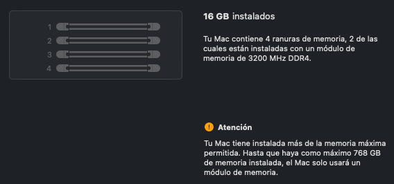

RestrictEvents.kext
New kext to resolve issues with the memory misconfiguration notifications when using MacPro7,1 SMBIOS. I have tried it, deleting the custom memory section of config.plist and, indeed, the warning when starting up and the balloon in About this Mac have disappeared but, when accessing the Memory tab, the information that is displayed continues to be wrong but, otherwise, the system seems to work fine with the correct amount of memory.
