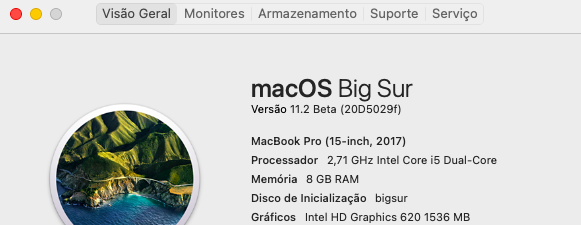

Max.1974 Posted January 3, 2021 Share Posted January 3, 2021 (edited) Hi guys, happy new year to all!! Im wish share my EFI folder, with Clover bootloader, r5127 with full configs to install and run macOS Big Sur. Im tested on Big Sur 11.1 and 11.2 (betas) and boot in 16 seconds. Works fine with Dual Boot to Windows (recommend format before install the Windows partitions). Opencore 2022 Monterey https://osxlatitude.com/forums/topic/17060-lenovo-thinkpad-e470-i5-7200u-kaby-lake-install-macos-monterey-opencore-2022/ @MaLd0n as always help me! Im recommend you extract your DSDT and SSDTs, and change ACPI folder to yours. Im use Patchmatic from Rehabman tutorial. Don't forget too that Big Sur will boot only with Preboot volume. I do my best to put this run, so im share for free, but appreciated you not forget help the InsanelyMac. My wireless card was Broadcom, not intel. Works everything, included SD Card, Battery %, Keyboard TrackPad and this /?° key. CSM could be enable to install Windows 7 if you wanted!! Its possible update to the last Clover 5128 **** * * * * * * * * * * Bios config for install (after install choice as you need): Network Wake On Lan: Disabled UEFI IPV4: Disabled UEFI IPV6: Disabled USB UEFI Bios Support: Enabled Always On USB: Enabled Charge in Battery Mode: Enabled USB 3.0 Mode: Enabled Keyboard/Mouse Trackpoint: Disabled Trackpad: Enabled Fn Ctrl swap:Disabled Fn sticky key: Disabled F1-F12 primary: Disabled Display Boot display: ThinkPad LCD Total graphics memory: 512 MB Boot time extension: Disabled Power Intel speed step: Enabled Mode AC: Max Performance Mode Battery: Battery Optimization Scheme for AC: Max Performance Scheme for Battery: Balanced CPU Power Management: Enabled Power On With AC: Disabled Intel Rapid Start: Disabled Beep and Alarm Password Beep: Disabled Keyboard Beep: Disabled CPU Intel Hyper Threading Technology: Enabled Intel AMT (Active Management) {BE CAREFUL HERE} AMT Control: Permanently Disabled (*** Caution ***) This can't be Enabled again after permanently disabling Password All passwords are unset Fingerprint Predesktop Authentication: Disabled Reader Priority: Internal Only Security Mode: Normal Security Chip Security Chip Selection: Intel PTT Security Chip: Disabled Physical Presence Provisioning: Disabled Physical Presence Clear: Disabled UEFI Bios Update Option Flash BIOS updating End User: Enabled Secure Rollback Prevention: Disabled Memory Protection Execution Prevention: Enabled Virtualization Intel Virtualization Technology: Enabled Intel VT-d Feature: Disabled I/O Port Access All except Fingerprint: Enabled Internal Device Access Bottom Cover Tamper Detection: Disabled Internal Storage Tamper Detection: Disabled Anti-Theft Computrace: Permanently Disabled (*** Caution ***) This can't be re-enabled after permanently disabling Secure Boot Secure Boot: Disabled Platform Mode: Setup Mode Secure Boot Mode: Custom Network Boot: PCI LAN UEFI/Legacy Boot: UEFI both (***CSM Enabled***) Boot Mode: Quick Boot Boot Device List Option: Enabled Boot Order Lock: Disabled All comments and suggests will be welcome, so here the folder: EFI-Clover-LenovoE470-BIGSUR-Preboot.zip EFI - LENOVO E470 - MALDON TECLADO 2022 - FULL.zip Edited January 16, 2022 by Max.1974 4 Link to comment https://www.insanelymac.com/forum/topic/346264-success-lenovo-thinkpad-e470-kaby-lake-r-intel-i5-7200u-macos-big-sur-monterey-clover-5127-for-bs-and-opencore-2022/ Share on other sites More sharing options...

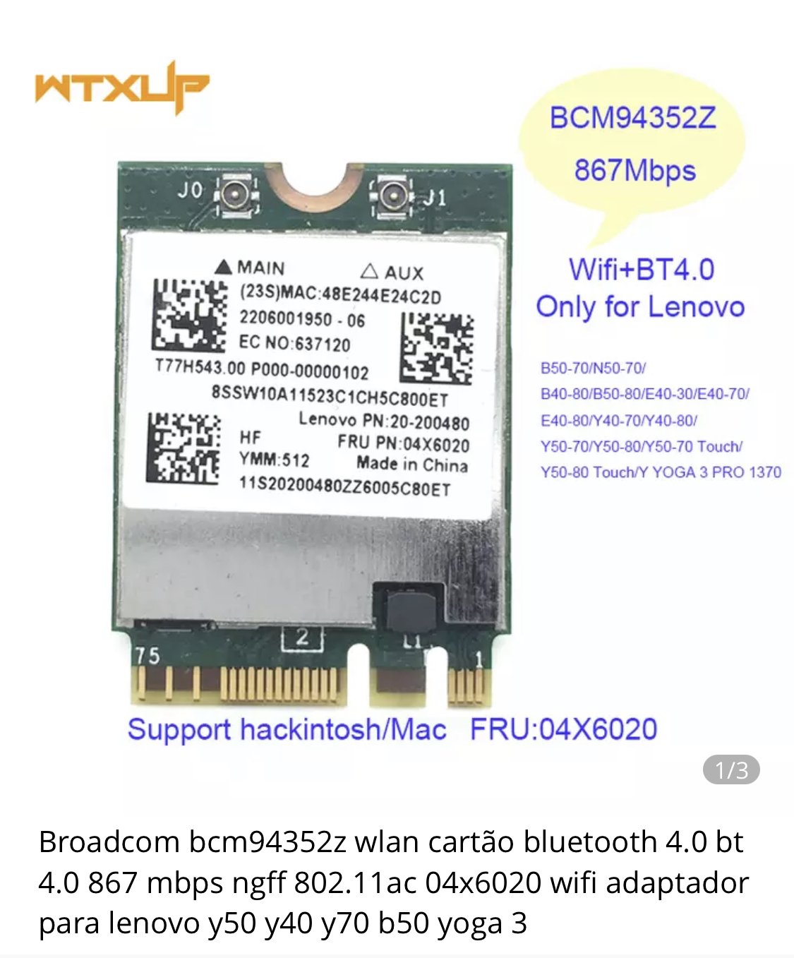

Allan Posted January 4, 2021 Share Posted January 4, 2021 Whats is the model of you WiFi card? 1 Link to comment https://www.insanelymac.com/forum/topic/346264-success-lenovo-thinkpad-e470-kaby-lake-r-intel-i5-7200u-macos-big-sur-monterey-clover-5127-for-bs-and-opencore-2022/#findComment-2748145 Share on other sites More sharing options...
Max.1974 Posted January 4, 2021 Author Share Posted January 4, 2021 Hi Allan my friend is this model 1 Link to comment https://www.insanelymac.com/forum/topic/346264-success-lenovo-thinkpad-e470-kaby-lake-r-intel-i5-7200u-macos-big-sur-monterey-clover-5127-for-bs-and-opencore-2022/#findComment-2748169 Share on other sites More sharing options...
