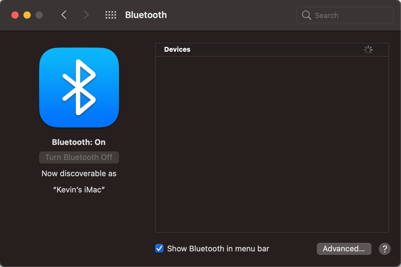

After that I wanted to test the "Sleep" and upon re-waking, the machine rebooted itself and mentioned "Boot Failure". Now my Bluetooth doesn't detect anything anymore.
I have double checked my BIOS settings to make sure nothing has changed, and the Intel Bluetooth is still disabled in Windows. On Device Manager (in Windows), there is a WiFi and Bluetooth in "Other Devices", so it looks like the machine does indeed recognise the T919.
Any thoughts on what the issue is?

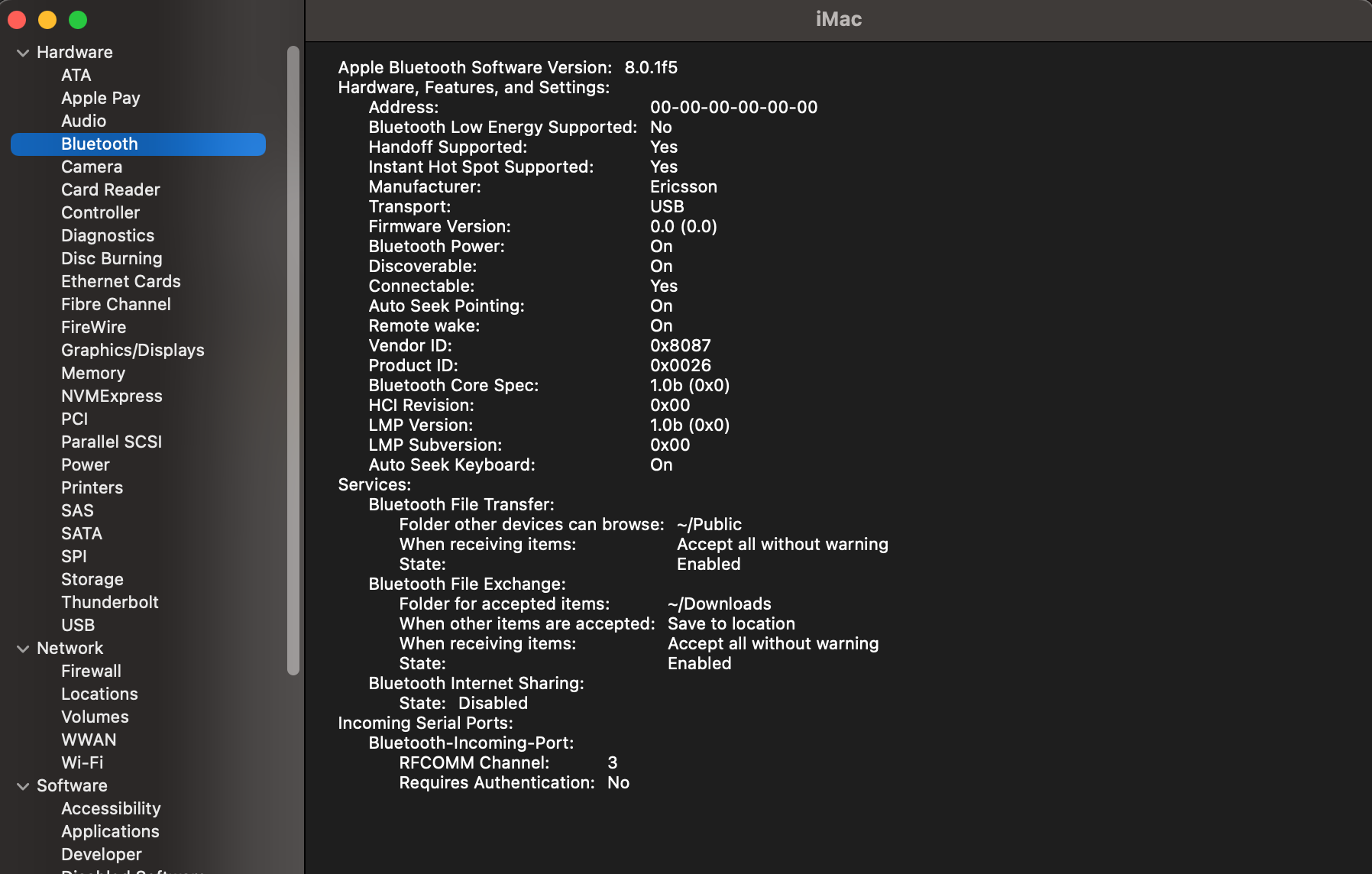

Here's a screenshot of my Mac.
I'm guessing that is not the Intel Bluetooth since it was disabled in Windows?

What I don't understand is why it worked the first time out of the box and then stopped working after that?
Any help would be much appreciated!
