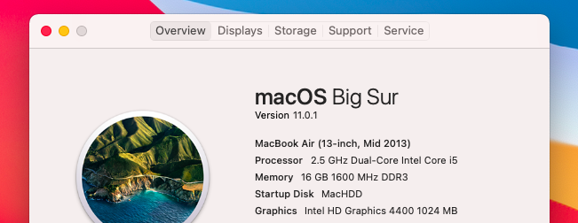

jkl555 Posted December 2, 2020 Author Share Posted December 2, 2020 I installed Big Sur despite the long wait time during installation. But the boot time of Big Sur is very long which I would say two to four minutes. I can't stand it and I moved back to Catalina. Link to comment https://www.insanelymac.com/forum/topic/345850-installer-hang-on-hp-840-g1-with-oc-063/#findComment-2746077 Share on other sites More sharing options...
jkl555 Posted December 3, 2020 Author Share Posted December 3, 2020 Update. All the time the long wait (or hang) is due to the WIFI/BT card. I deleted these 4 kext (a) AirportBrcmFixup.kext (b) BrcmBluetoothInjector.kext (c) BrcmFirmwareData.kext and (d) BrcmPatchRAM3.kext from OC and the installer booted smoothly without any long wait. I still have WIFI on the installation screen probably the wifi card is natively supported ? I have a BCM94360HMB. Need to dig into more about this. I know 94360 is natively support but only the apple-made version. Link to comment https://www.insanelymac.com/forum/topic/345850-installer-hang-on-hp-840-g1-with-oc-063/#findComment-2746091 Share on other sites More sharing options...
jkl555 Posted December 3, 2020 Author Share Posted December 3, 2020 A second attempt to install Big Sur is very smooth. I kept the AirportBrcmFixup and BrcmBluetoothInjector. The hang (or long wait) are due to BrcmFirmwareData.kext and BrcmPatchRAM3. Previously, there was a message on the first installation that I didn't notice was IOKit Daemon stall 'BCM20702A0' It is the BT of my BCM94360HMB. Guess I don't need to upload the firmware in Big Sur. After I took out these two kexts, all went well. I still have WIFI and BT. 1 Link to comment https://www.insanelymac.com/forum/topic/345850-installer-hang-on-hp-840-g1-with-oc-063/#findComment-2746161 Share on other sites More sharing options...
