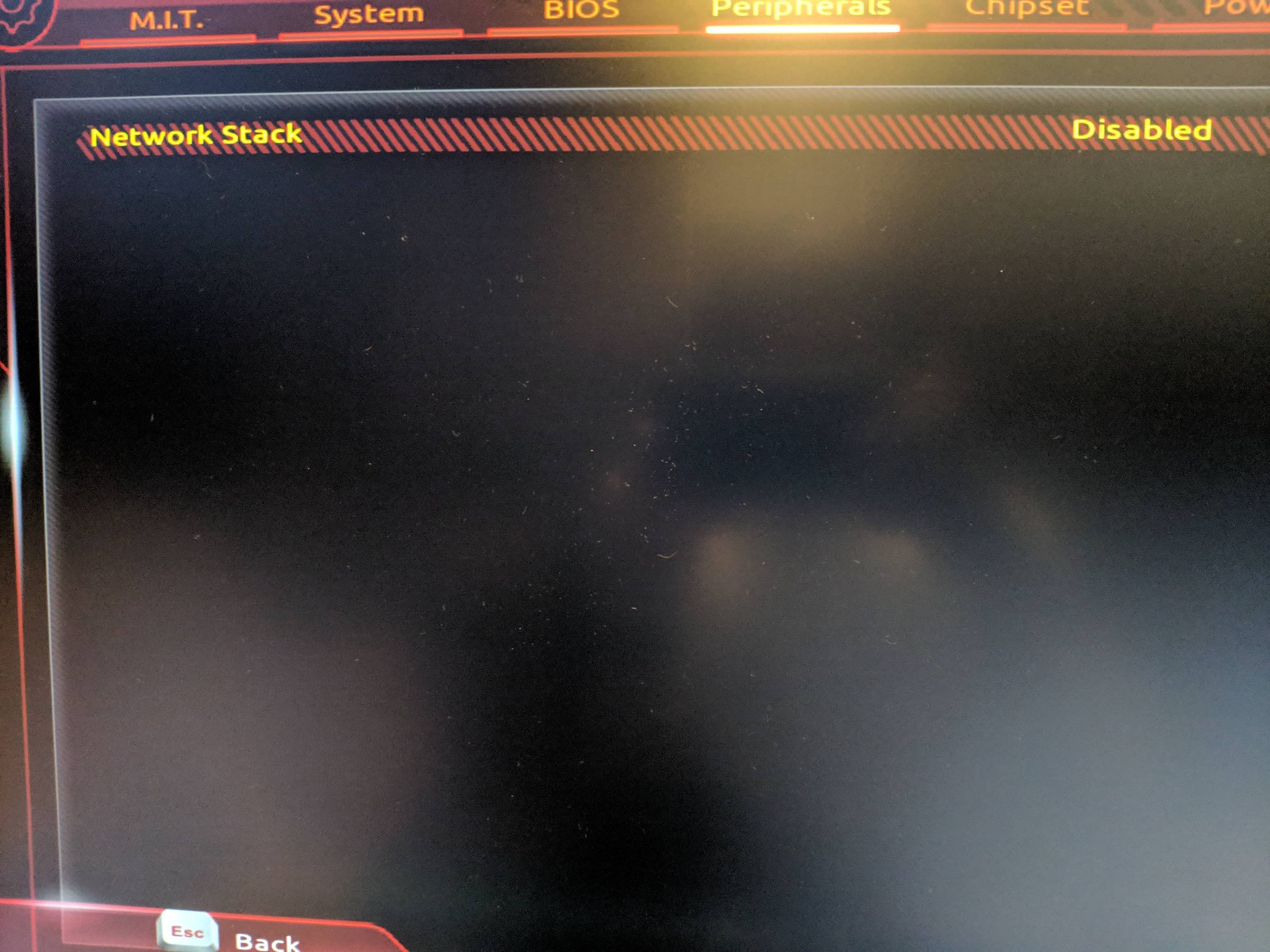

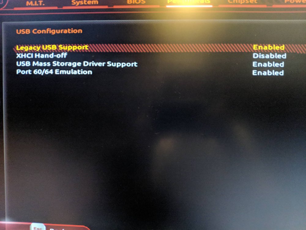

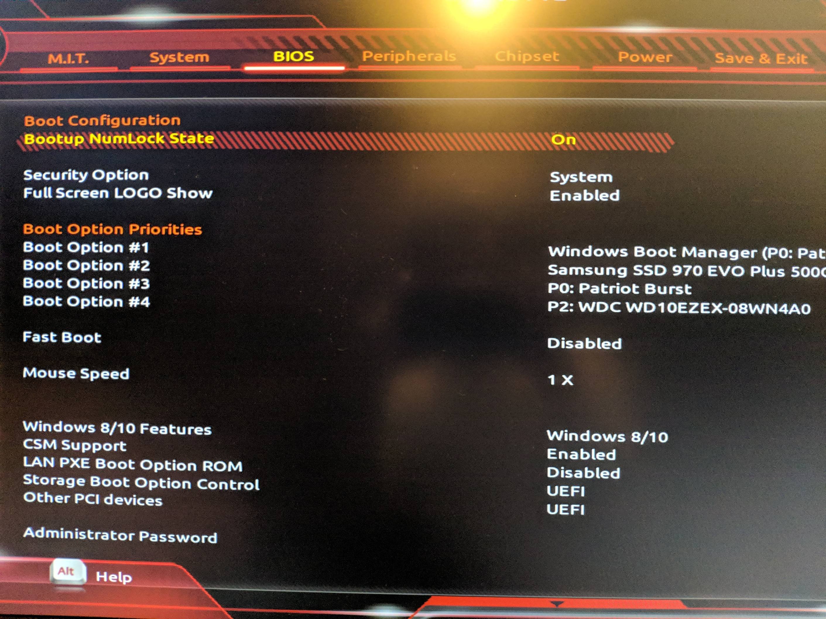

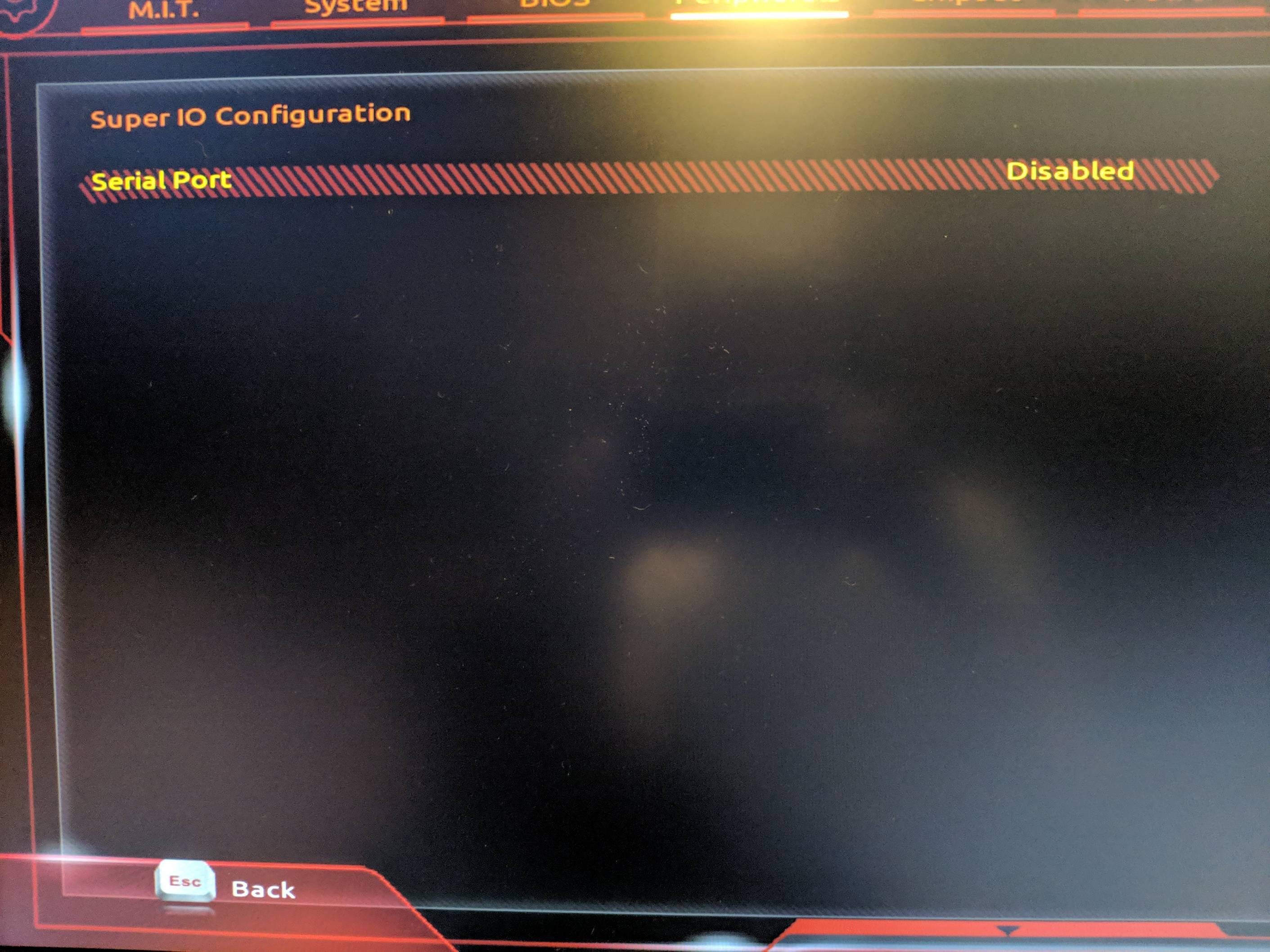

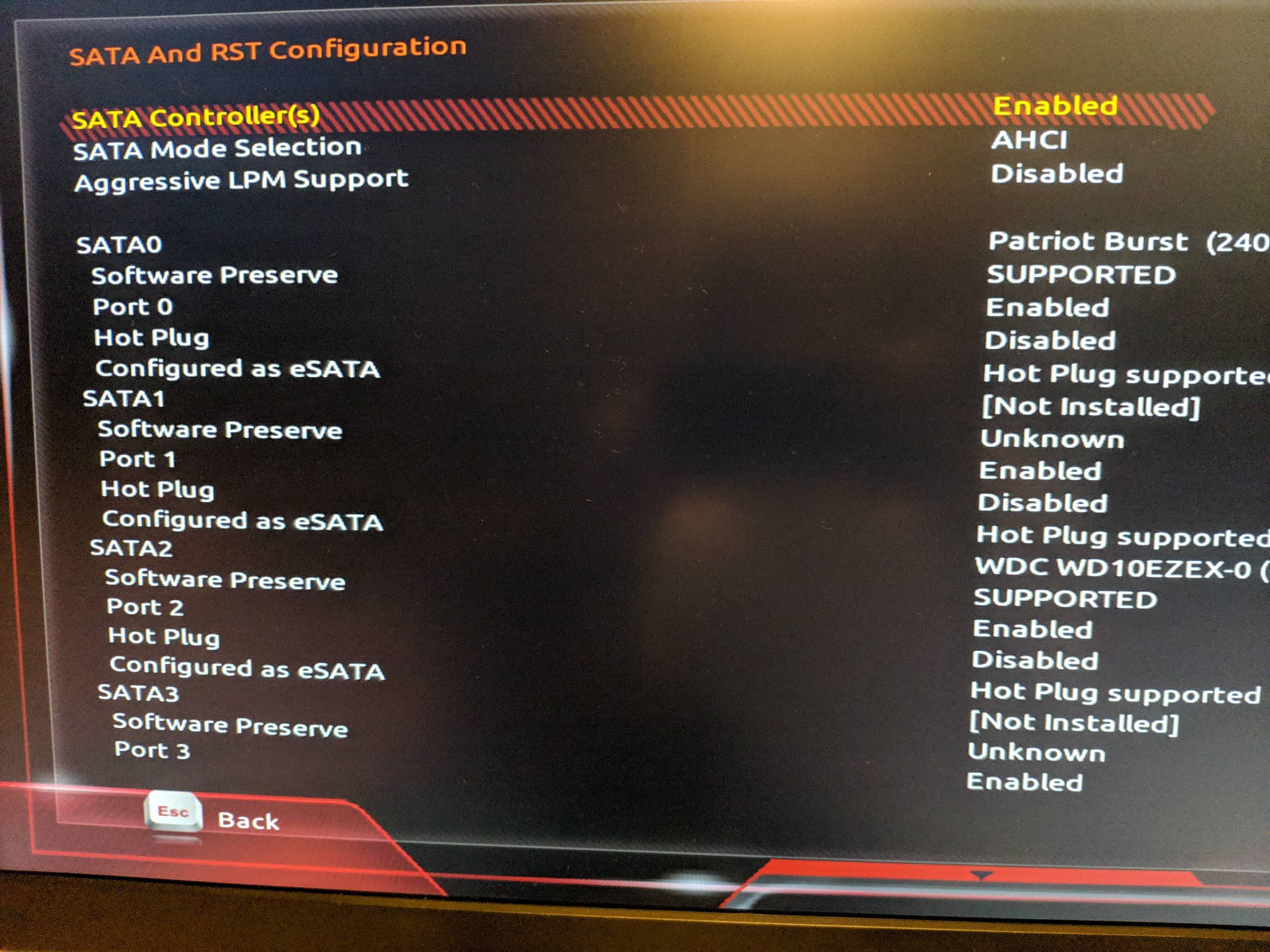

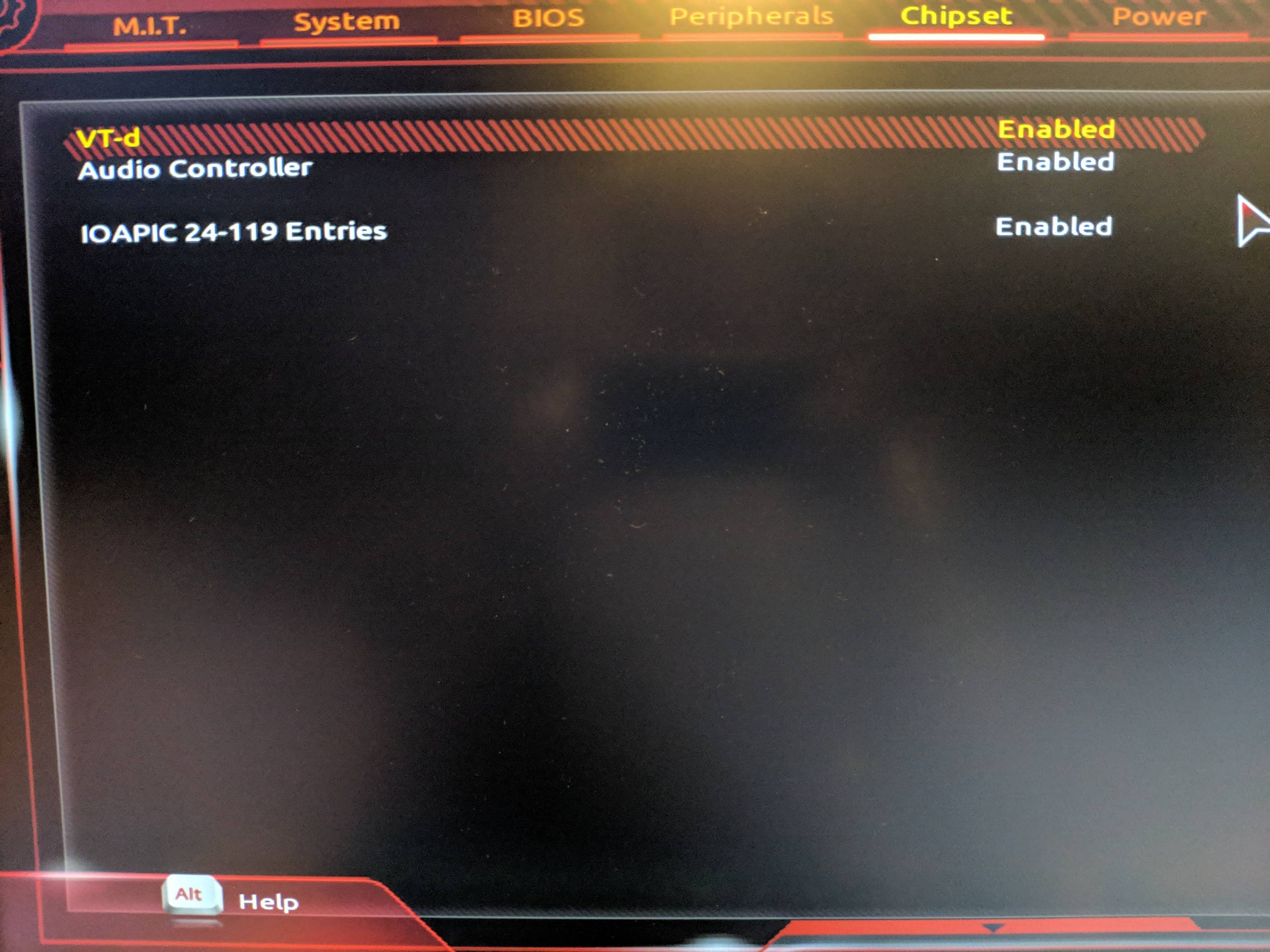

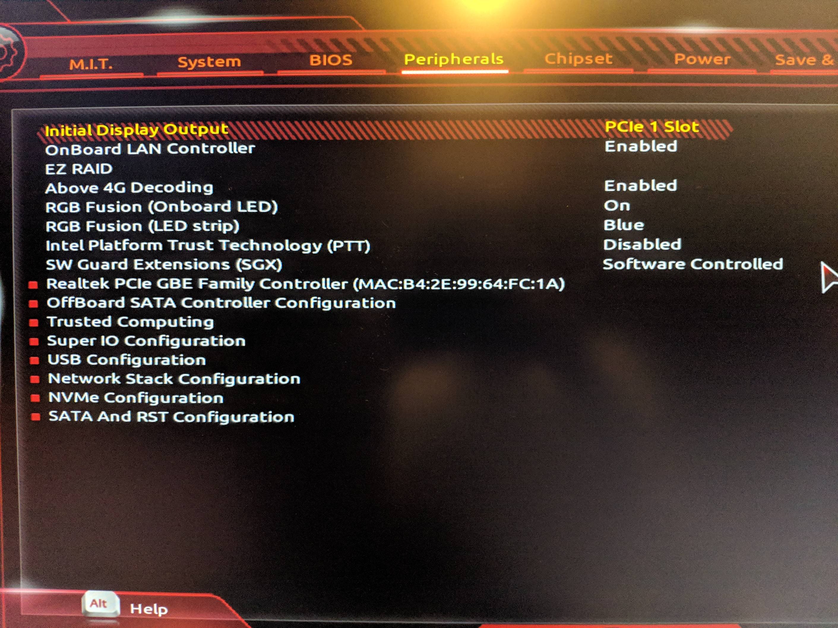

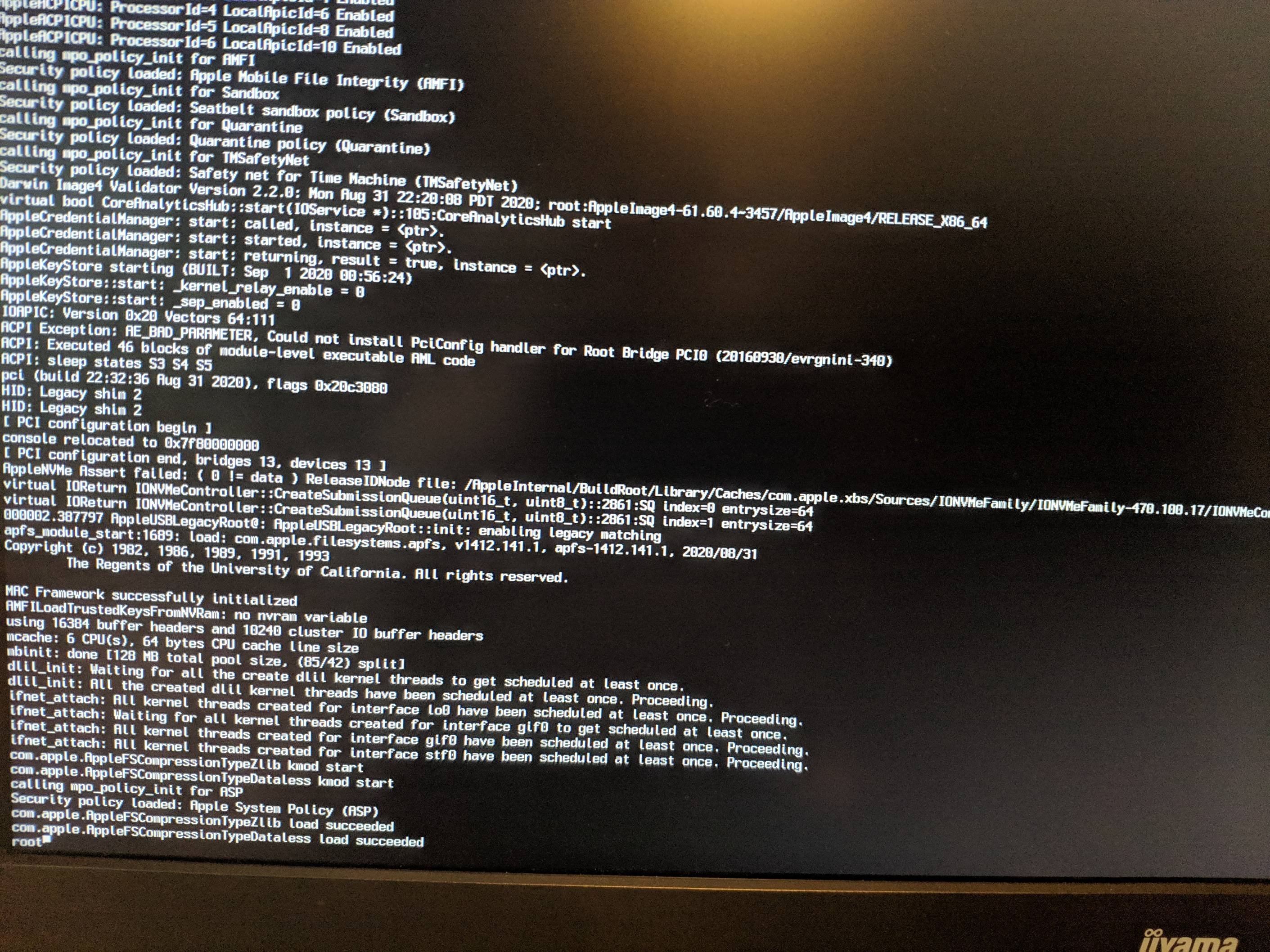

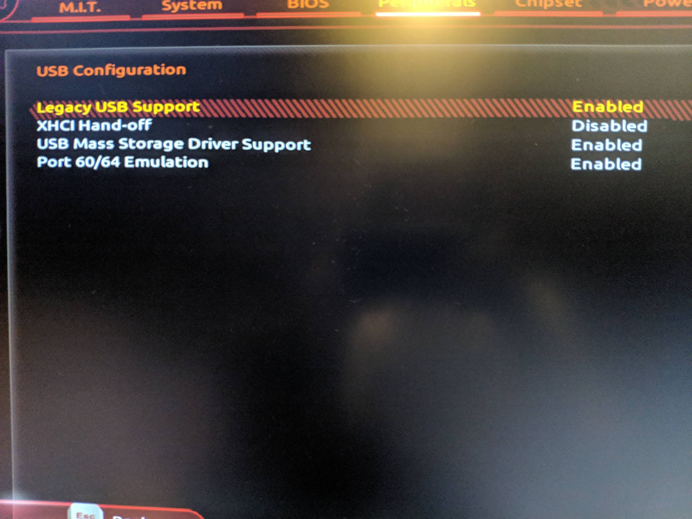

SolidaSlOl Posted November 22, 2020 Share Posted November 22, 2020 (edited) Hello, I stuck on getting "root" as the last message after clicking install macOS: Spoiler My build: Gigabyte Z370P D3 (BIOS version: F13) 9400-F Gigabyte Radeon RX 5600 XT Gaming OC Samsung 970 Evo Plus 500GB I went through the whole OpenCore guide and tried the following (always got the same error): Both prebuild ACPI and "SSDTs: The easy way" (these are in the attached EFI folder) All types of HPET (as 4th file in ACPI) Without USBInjectAll.kext Changing USB after clicking "Install" (saw that recommendation somewhere) Both USB 2.0 and 3.0 I would really appreciate any help, thanks. EFI.zip Also, attached bios configuration. Spoiler Edited November 22, 2020 by SolidaSlOl Quote Link to comment https://www.insanelymac.com/forum/topic/345841-stuck-on-root-gigabyte-z370p-d3-9400-f/ Share on other sites More sharing options...
SolidaSlOl Posted November 23, 2020 Author Share Posted November 23, 2020 Thank you for pointing that out. Sadly, disabling VT-d in BIOS didn't help Quote Link to comment https://www.insanelymac.com/forum/topic/345841-stuck-on-root-gigabyte-z370p-d3-9400-f/#findComment-2745175 Share on other sites More sharing options...
Frank Barcenas Posted December 29, 2021 Share Posted December 29, 2021 (edited) Did you ever figure out what the issue was? I'm stuck in the same place.. Any help would be appreciated. Edited December 29, 2021 by Frank Barcenas Quote Link to comment https://www.insanelymac.com/forum/topic/345841-stuck-on-root-gigabyte-z370p-d3-9400-f/#findComment-2774338 Share on other sites More sharing options...
Slice Posted January 4, 2022 Share Posted January 4, 2022 IOAPIC 24-119 disable. And check boot log for locked 0xE2. Quote Link to comment https://www.insanelymac.com/forum/topic/345841-stuck-on-root-gigabyte-z370p-d3-9400-f/#findComment-2774537 Share on other sites More sharing options...
