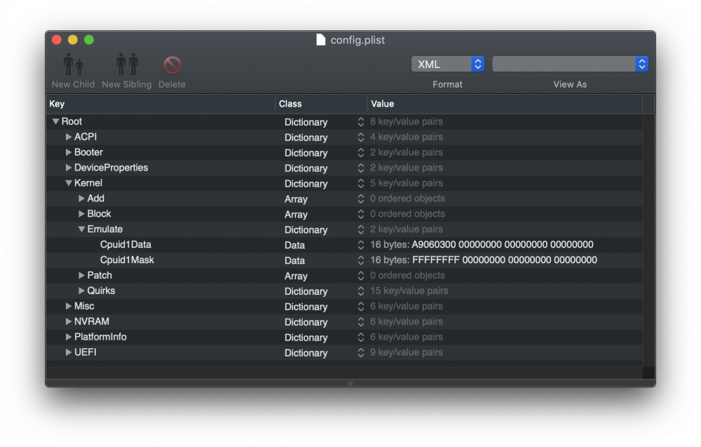

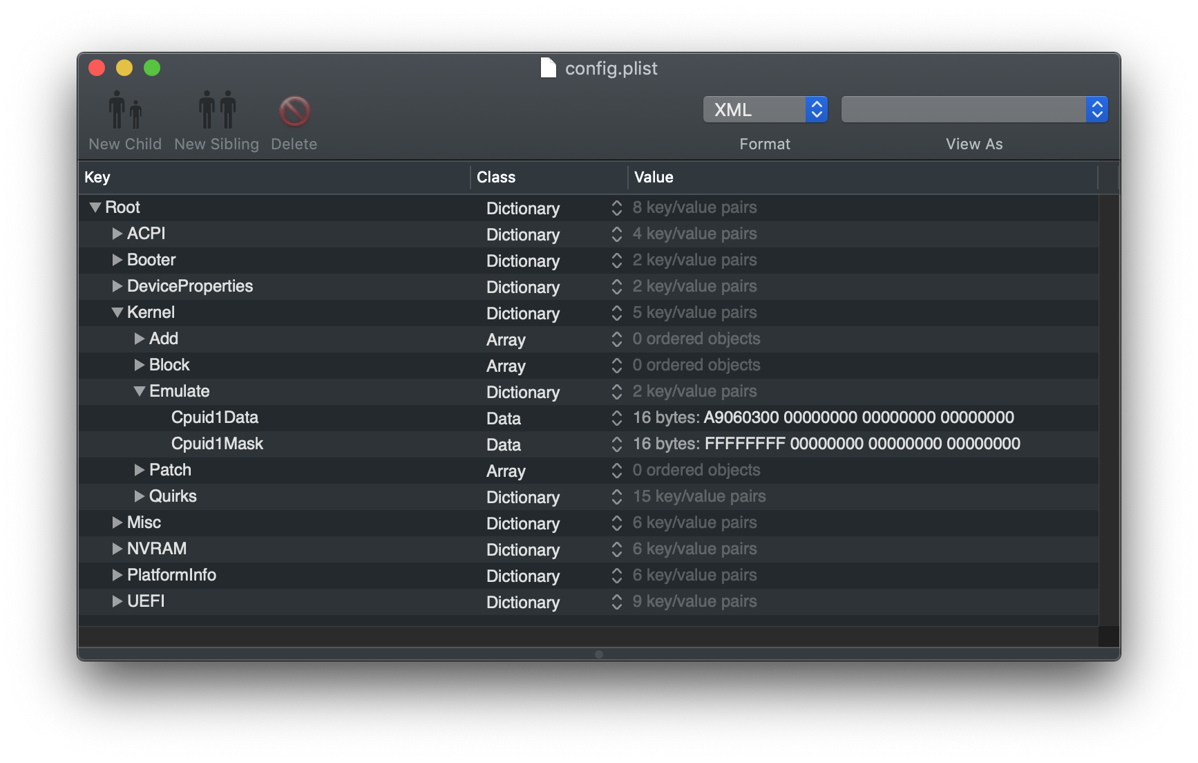

Cyberdevs Posted September 2, 2020 Share Posted September 2, 2020 @rajkhand I moved your topic to the correct section. I don't think you'll be able to boot El Capitan on a Coffee Lake CPU without using a Fake CPU ID from an older processor (I might be wrong though). You can try using an older processor IDs like SkyLake, Broadwell, Haswell etc. and see if you can boot your computer from the El Capitan volume with OC. Try these values under Kernel>Emulate section: Cpuid1Data: <A9 06 03 00 00 00 00 00 00 00 00 00 00 00 00 00> Cpuid1Mask: <FF FF FF FF 00 00 00 00 00 00 00 00 00 00 00 00> Spoiler Link to comment https://www.insanelymac.com/forum/topic/345046-use-macbook-pro-2010-old-hdd-in-hackintosh-using-oc-060/#findComment-2736169 Share on other sites More sharing options...
