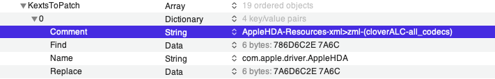

freddy3k Posted August 28, 2020 Share Posted August 28, 2020 clover 5119 motherboard = ga-h81m-ds2 RAM = 2x4gb kingston VideoCard = GT210 HDD = seagate 500gb everythings works fine except for the audio. i have installed Voodoo 2.8.7 output is working but has lot of cracking noise and mic / line in is not working only output is usable. i already tried the patch with layout id but no luck and always stock at IOHDA blah blah something and the system wont boot.. if anyone there kind enough to help me please i would really appreciate it.. TIA PS: HDMI output is working but unusable because of crack sound output (using Voodoo) Link to comment Share on other sites More sharing options...
pico joe Posted August 28, 2020 Share Posted August 28, 2020 applehda must be vanilla - use applealc - remove voodoohda & applehdadisabler (if exists) Link to comment Share on other sites More sharing options...

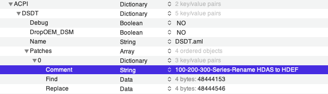

freddy3k Posted August 28, 2020 Author Share Posted August 28, 2020 yup it is vanilla and before i use voodoo i backed it up.. just to make sure i can revert it while am doing some experiment i did use applealc and installed it in L/E with lilu and remove Voodoo and the disabler add the the patch and also tried this other patch both have same result and also i added this to my config ps: my processor is intel i3 4170 Link to comment Share on other sites More sharing options...

freddy3k Posted August 29, 2020 Author Share Posted August 29, 2020 13 hours ago, Hervé said: According to the on-line documentation, all GA-H81M-DS2 mobos (v1.0/2.0/2.1/3.0) are fitted with Realtek ALC887 audio. https://www.gigabyte.com/Motherboard/GA-H81M-DS2-rev-10/sp#sp Remove VoodooHDA and AppleHDADisabler. Remove any AppleHDA patches, stick to full vanilla AppleHDA. Use Lilu + AppleALC + CodecCommander kexts (latter must be cached (from /L/E), not injected) Experiment with the various ALC887 layouts: https://github.com/acidanthera/AppleALC/wiki/Supported-codecs where can i get the CodecCommander kext? 13 hours ago, Allan said: Topic moved to the right place, it's not a guide. sorry about that and thanks for moving this to the right place.. kudos.. Link to comment Share on other sites More sharing options...

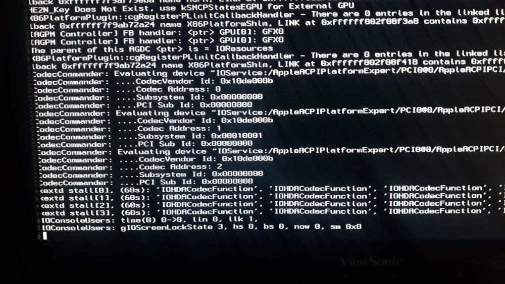

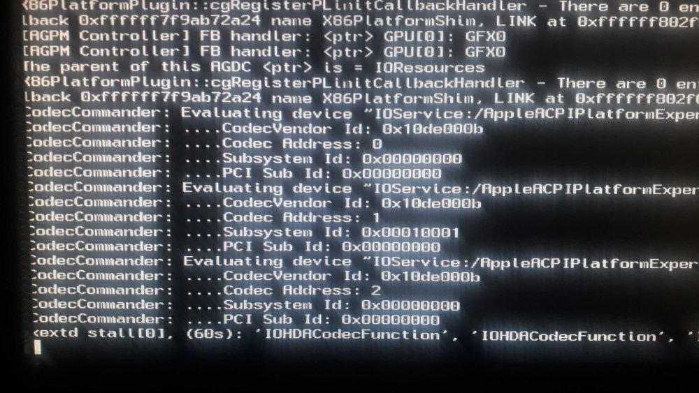

freddy3k Posted August 29, 2020 Author Share Posted August 29, 2020 15 hours ago, Hervé said: According to the on-line documentation, all GA-H81M-DS2 mobos (v1.0/2.0/2.1/3.0) are fitted with Realtek ALC887 audio. https://www.gigabyte.com/Motherboard/GA-H81M-DS2-rev-10/sp#sp Remove VoodooHDA and AppleHDADisabler. Remove any AppleHDA patches, stick to full vanilla AppleHDA. Use Lilu + AppleALC + CodecCommander kexts (latter must be cached (from /L/E), not injected) Experiment with the various ALC887 layouts: https://github.com/acidanthera/AppleALC/wiki/Supported-codecs where can i get the CodecCommander kext? 14 hours ago, Allan said: Topic moved to the right place, it's not a guide. sorry about that and thanks for moving this to the right place.. kudos.. ----- update ------ i followed the instruction Remove VoodooHDA and AppleHDADisabler. Remove any AppleHDA patches, stick to full vanilla AppleHDA. Use Lilu + AppleALC + CodecCommander kexts (latter must be cached (from /L/E), not injected) result: 15-20 minutes in this loading screen then it goes black but my keyboard capslock is working so i assume my card has a conflict in the codedcommander so i reboot with boot args nv_disable=1 resulted got the display but only apple logo with a loading bar screen which is not moving so i reverted everything back to voodoo which is really annoying Link to comment Share on other sites More sharing options...
freddy3k Posted August 29, 2020 Author Share Posted August 29, 2020 (edited) 3 hours ago, Hervé said: Screenshots show that graphics are not initialising. Strange because Tesla GeForce 210 is normally supported OOB up to High Sierra. Are you sure you did not make some other changes? You may try and add WhatEverGreen kext when using Lilu & its Plugins. If you want further assistance, please post zipped copy of Clover EFI folder + IOReg extract. Good luck! here is my clover setup and ioreg.. i use ioJones to extract ioreg by the way i extracted that io using voodoo 2.8.7 installed am using mojave not high sierra CLOVER.zip osx’s iMac.iojones Edited August 29, 2020 by freddy3k Link to comment Share on other sites More sharing options...
