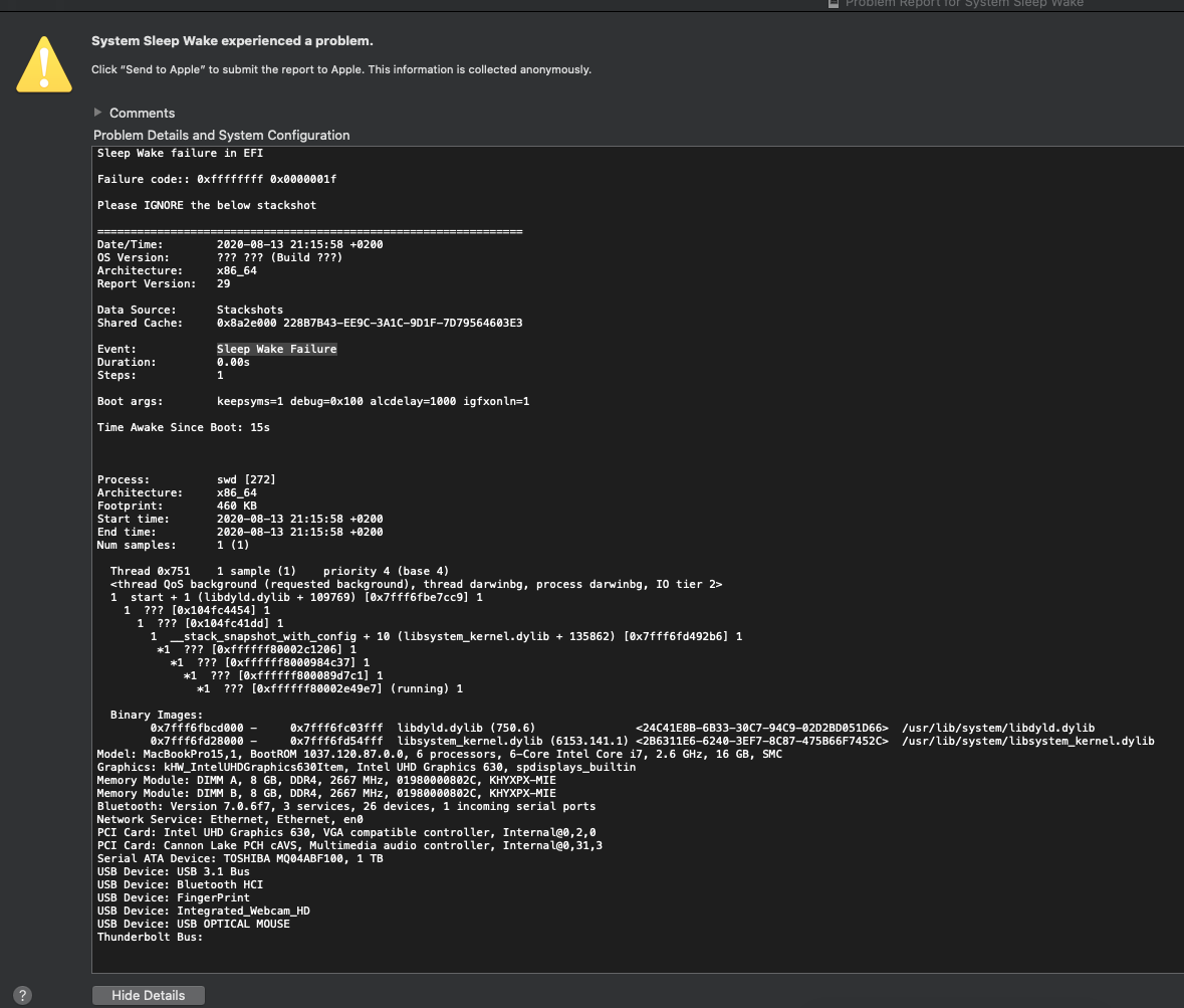

amin321 Posted August 13, 2020 Share Posted August 13, 2020 since the installation of macOS, the most observable problem is awaking from sleep failure, I almost tried every related thing like mapping USB ports, appropriate ig-platform-id and disabling dgpu , all of those does not help at all that report on panic gets triggered after force shutdown and reopening the system (as the system does not wake from sleep) dell g3 3590 intel core i7 9750h *iGPU : Intel UHD 630 *RAM : 16GB, 2x8GB, DDR4, 2666MHz *Storage : 256GB M.2 PCIe NVMe Solid Stat e Drive (Boot) + 1TB 5400 rpm 2.5" SATA Hard Drive (Storage) can anybody give me a tip on that Link to comment Share on other sites More sharing options...

amin321 Posted August 14, 2020 Author Share Posted August 14, 2020 8 hours ago, SavageAUS said: Upload your EFI folder for analysis. Does sleep work? Cpu power management? Screen brightness? Sent from my iPhone using Tapatalk sleep is partially working , sometimes wake properly from sleep and other times it does not , I mapped my ports and ignored the one for the fingerprint (deleted from my ports) , cpu power management is working properly followed OC documentation ssdt patch and cpufirend + cpufriend data provider, I am using ssdt-pnlfcfl.aml patch that makes brightness working I am still trying to just figure out what is the problem , it is been more than 2 months on that {censored} appreciate your respondhttps://gofile.io/d/sNPxcR Link to comment Share on other sites More sharing options...

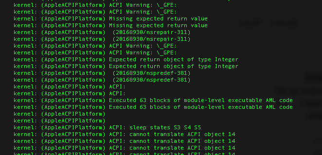

amin321 Posted August 16, 2020 Author Share Posted August 16, 2020 17 hours ago, SavageAUS said: I have almost the same setup on my laptop (see my signature), I’ll upload my EFI for you to check against yours when I get a chance. Sleep and wake via lid works (fixed recently by properly disabling dGPU) Don’t t use my whole EFI folder though just use it as a reference to get your system working. For me audio after sleep is not working and AppleBusPowerController does not load in Big Sur. Sent from my iPhone using Tapatalk EFI.zip Is that info valuable , or may causes of my problem ?! it comes out from identifying the states of acpi tables in terminal"log show --last boot | grep -i acpi" Link to comment Share on other sites More sharing options...
