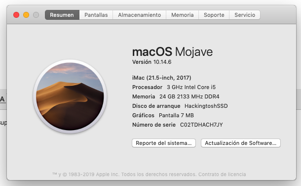

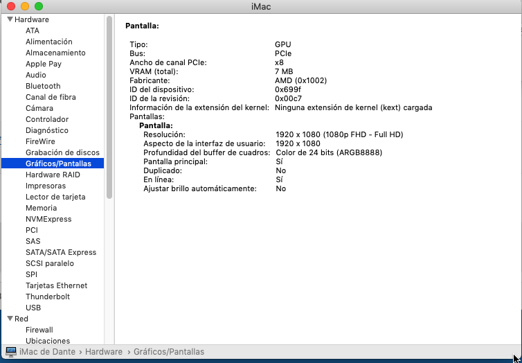

cinder92 Posted July 28, 2020 Share Posted July 28, 2020 Hello, I just saw in another post, that someone else has the same issue as me, however they suppose to found a solution, and because its an old post im creating a new one. These are my specs Gygabite Gaming B8 24 GB Ram SSD 512 GB Kingston Core i5 7600 RX550 4Gb Mojave I tried to set the FAKEID as 0x067FF1002 but didn't work. Thanks Link to comment https://www.insanelymac.com/forum/topic/344695-amd-radeon-rx550-4gb-not-working-mojave/ Share on other sites More sharing options...

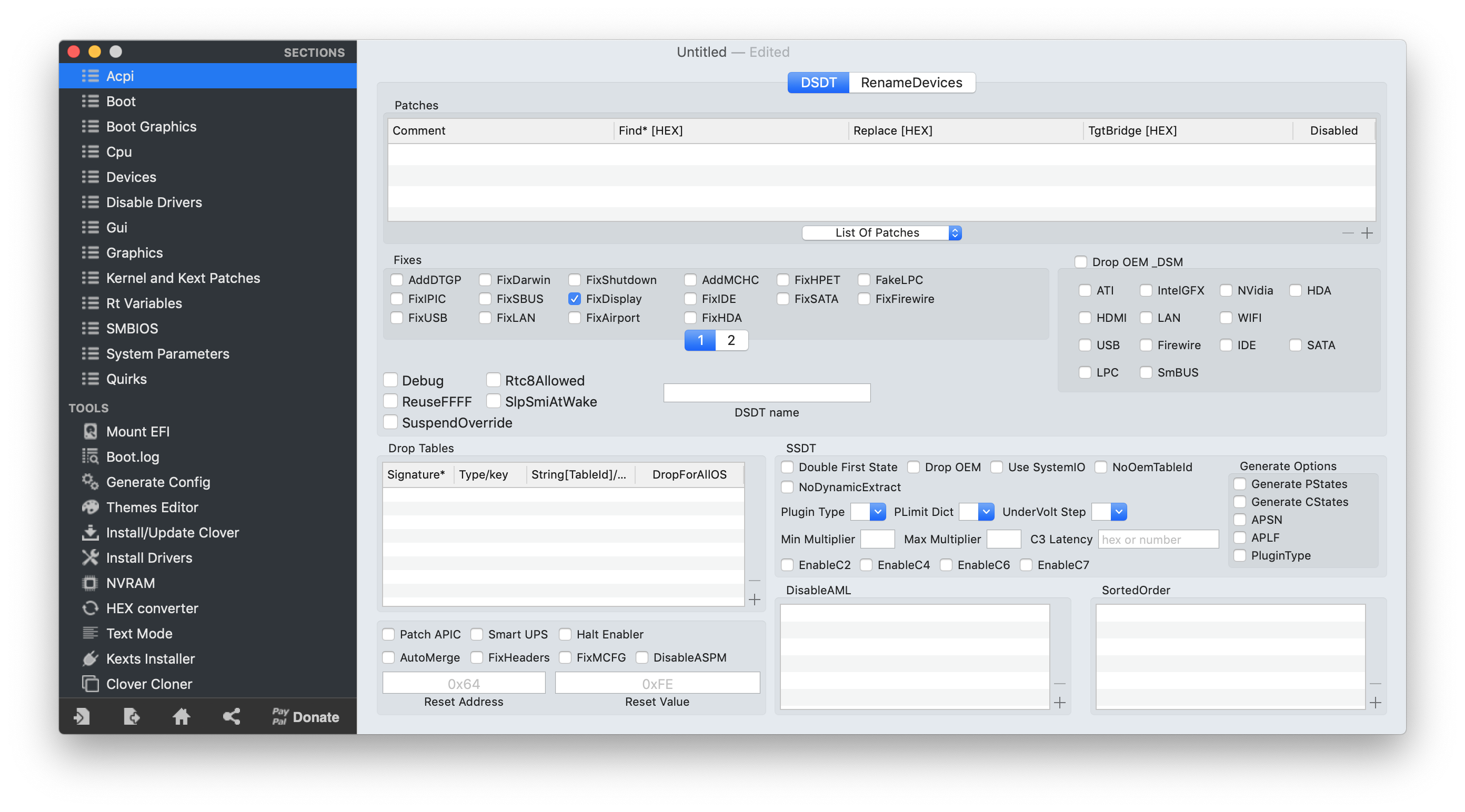

Cyberdevs Posted July 28, 2020 Share Posted July 28, 2020 When you are using a FakeID for GPUs you also need to add FixDisplay under ACPI Spoiler Link to comment https://www.insanelymac.com/forum/topic/344695-amd-radeon-rx550-4gb-not-working-mojave/#findComment-2732369 Share on other sites More sharing options...
cinder92 Posted July 28, 2020 Author Share Posted July 28, 2020 3 hours ago, Cyberdevs said: When you are using a FakeID for GPUs you also need to add FixDisplay under ACPI Hide contents i tried that, but didn't work Link to comment https://www.insanelymac.com/forum/topic/344695-amd-radeon-rx550-4gb-not-working-mojave/#findComment-2732396 Share on other sites More sharing options...
sunnyboy958 Posted July 29, 2020 Share Posted July 29, 2020 Sorry for my English, I think you can try add id 0x699f1002 into AMD9500Controller.kext and AMDRadeonX4000.kext , then install them to SLE, rebuild cash. 0x699f1002.zip Link to comment https://www.insanelymac.com/forum/topic/344695-amd-radeon-rx550-4gb-not-working-mojave/#findComment-2732407 Share on other sites More sharing options...
