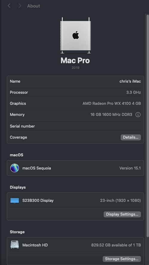

chris1111 Posted March 9, 2023 Share Posted March 9, 2023 Sleep Wake Works here AMD Radeon Pro WX 4100 4 GB macOS Mojave HP Prodesk 600 G1 but wake up not in Ventura, stay in black screen after sleep Link to comment Share on other sites More sharing options...
