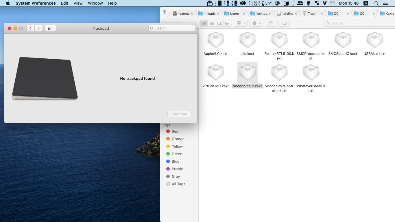

Excuse me, guy. I’m using OC 0.5.9 DEBUG for installing MacOS 10.15.5 in my DELL INSPIRON 3421. Although I've use the VoodoPS2controller and VoodoInput kexts (I’ve clean snap shot though) but my trackpad doesn't work. I'm using DELL Touchpad in DELL INSPIRON 3421. Any helps. Thanks a lot for reading my article

You need to find out what make it is. Elan, Synaptics or i2c. Then you can troubleshoot.
Voodoops2 is a good choice as long as it’s loaded correctly with OpenCore, you could also try ApplePS2SmartTouchpad, google will help find it.
What are you doing “snapshots” with?
Posting an IOReg and your config.plist (minus serial numbers / rom / mlb) will help too.
Mount EFI partition, copy EFI folder to desktop to modify before uploading (do not modify your hard drives config) also debloat your EFI folder, resources etc are not needed for diagnosis.

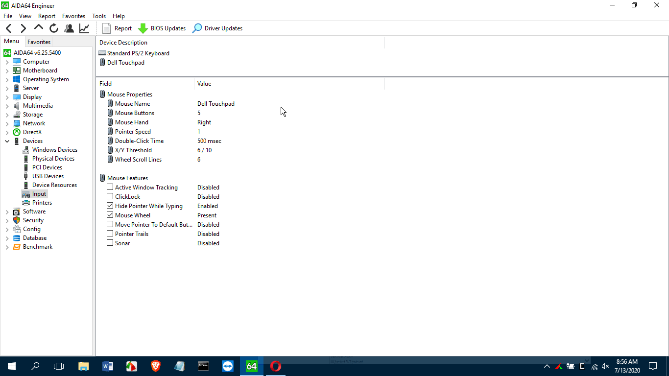

Here they are, my EFI and a file saved with IOreg. By the way, my laptop is a 2012 model so perhap it doesn't have I2C touchpad (I don't know how to find out, I also try AIDA64 Engineering but when I used to use window 7, it shown that my mouse is ps2). This EFI work for the trackpad but only up to 2 fingers, if I click with 3 fingers, no thing happen. Any ways, thanks for your help

I've try ApplePS2Smarttouchpad, too but I can only tap with 2 fingers, any helps?

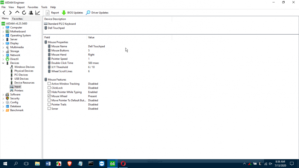

By the way, when my laptop OS was Window 7, open in device manager said that PS2Keyboard and StandardPS2mouse so I think I should use PS2controller and Voodoo Input
2 hours ago, Bandysc said:
Can you boot linux (you can boot live usb) and execute command `xinput -list` to check what is the touchpad brand?
It's a synaptic PS/2 and you've talked to me in my discord, too (Anyway, thanks a lot for trying to help me)
