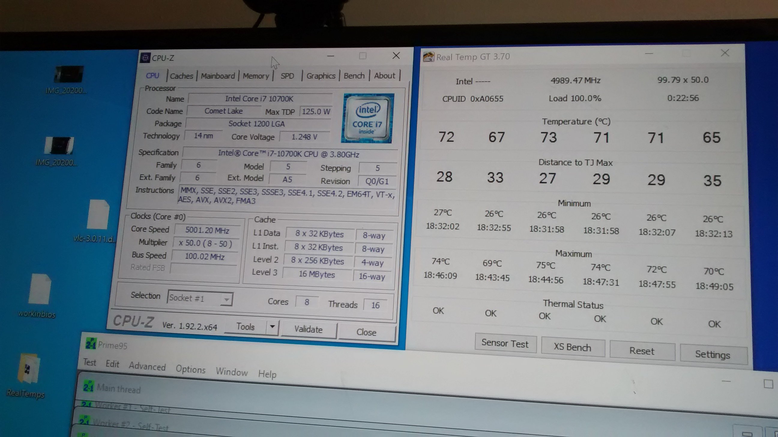

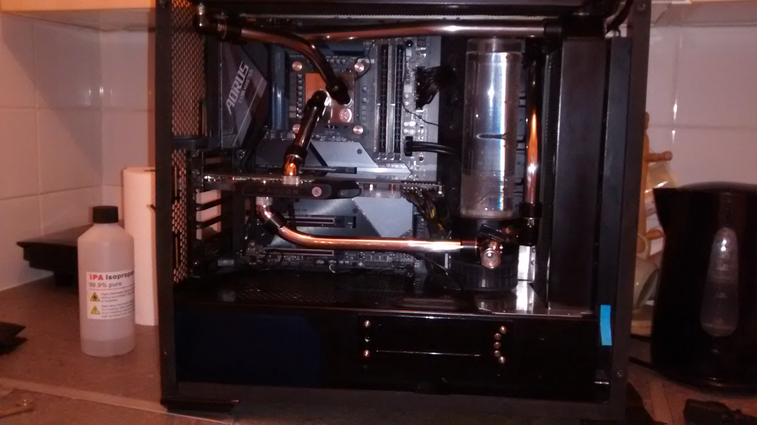

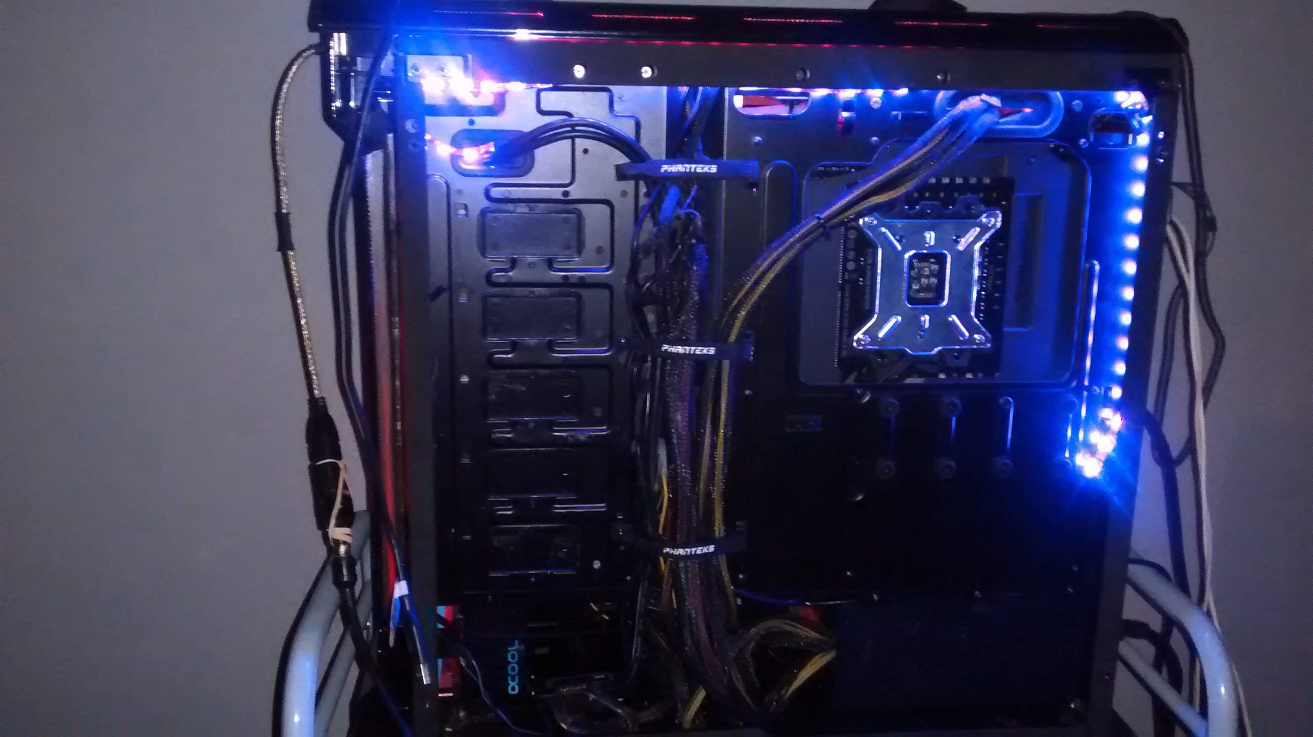

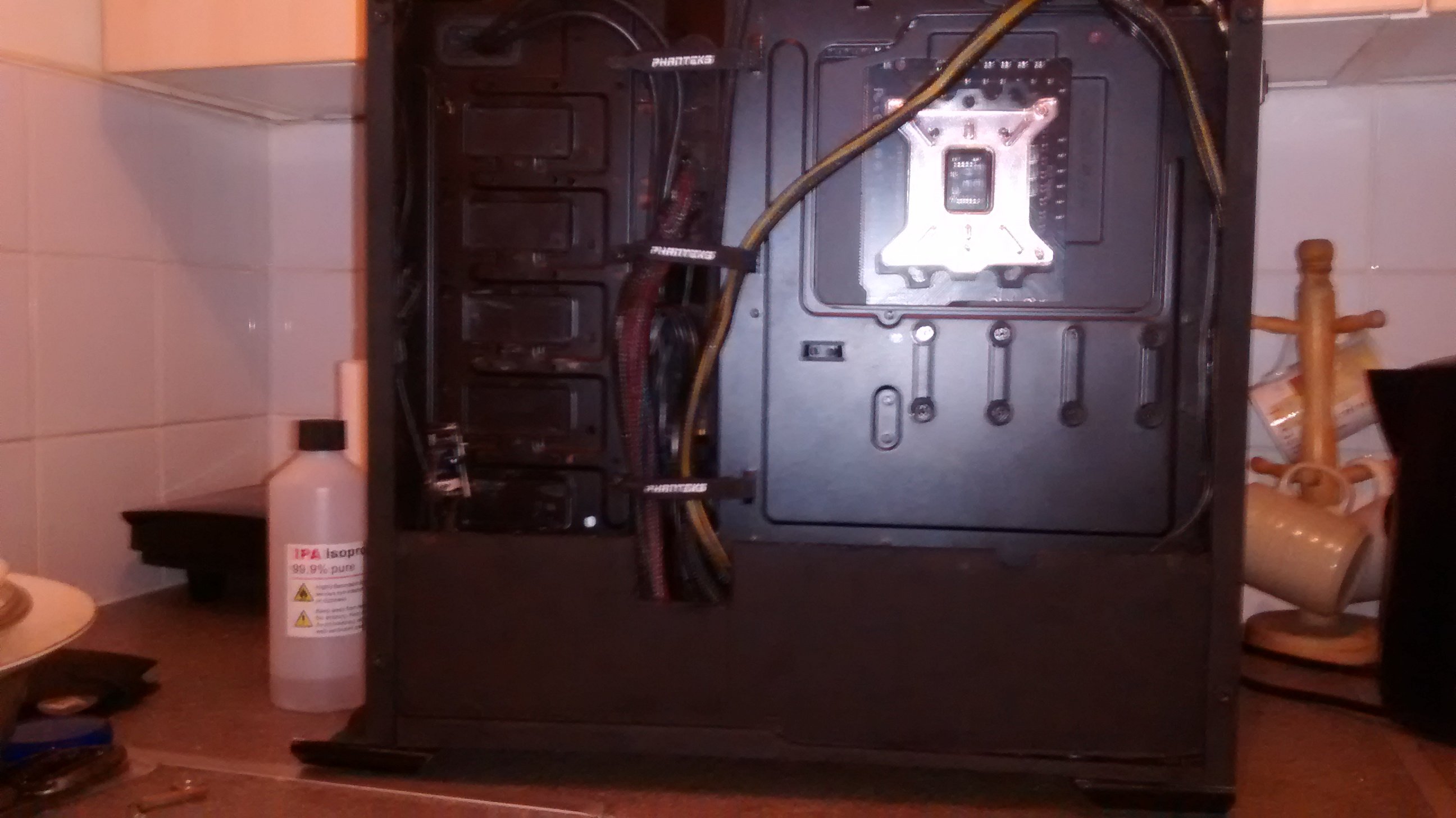

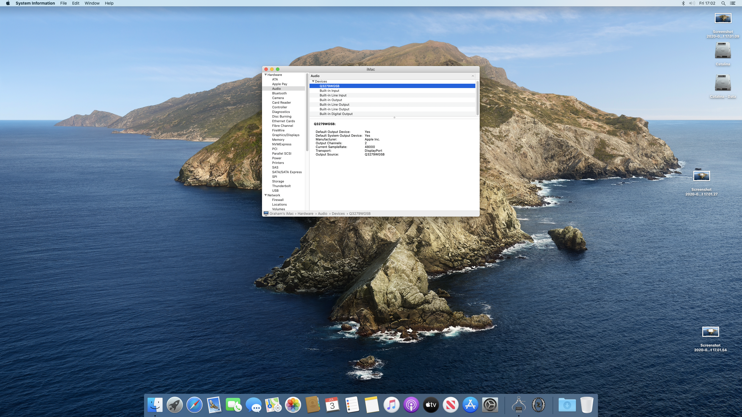

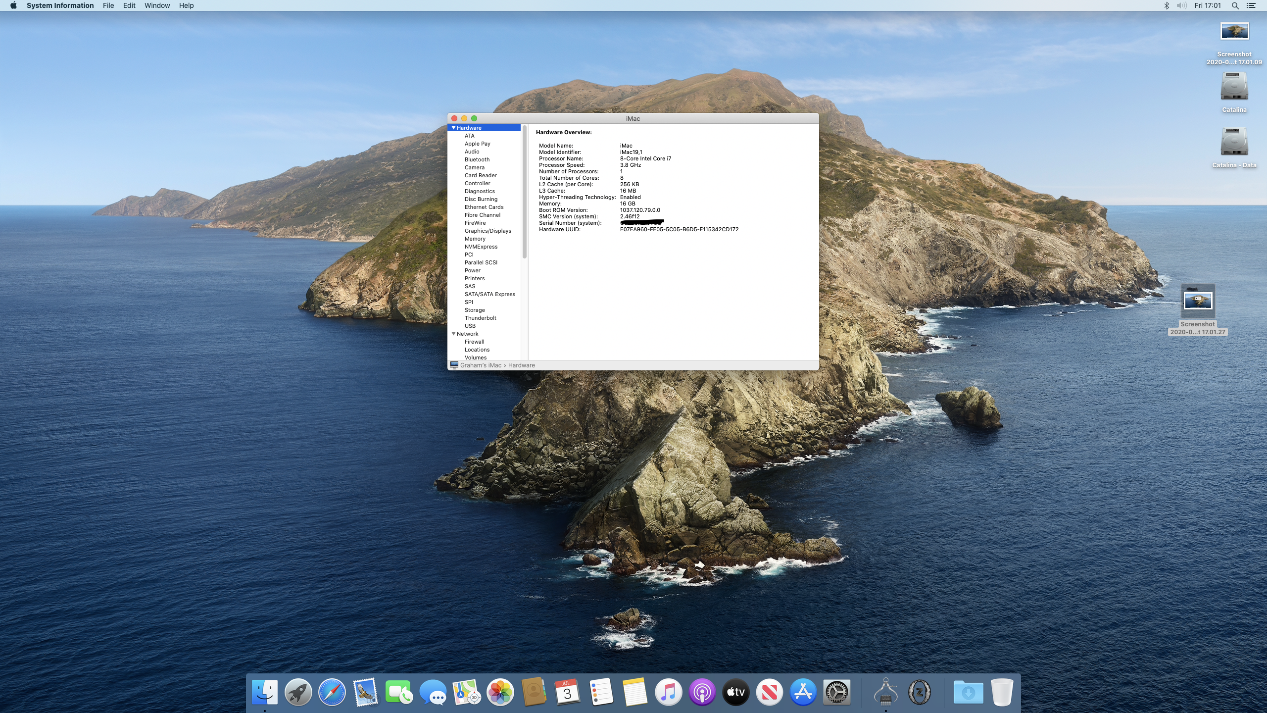

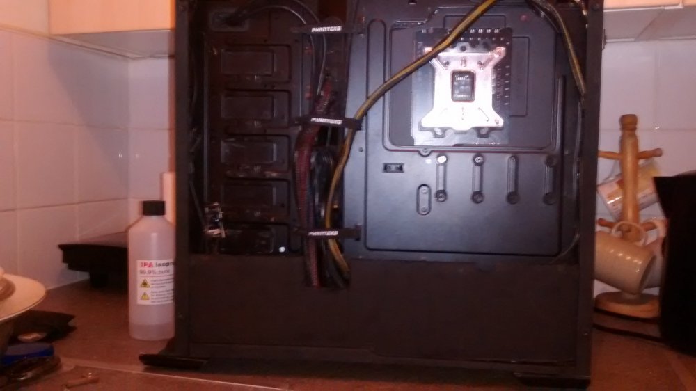

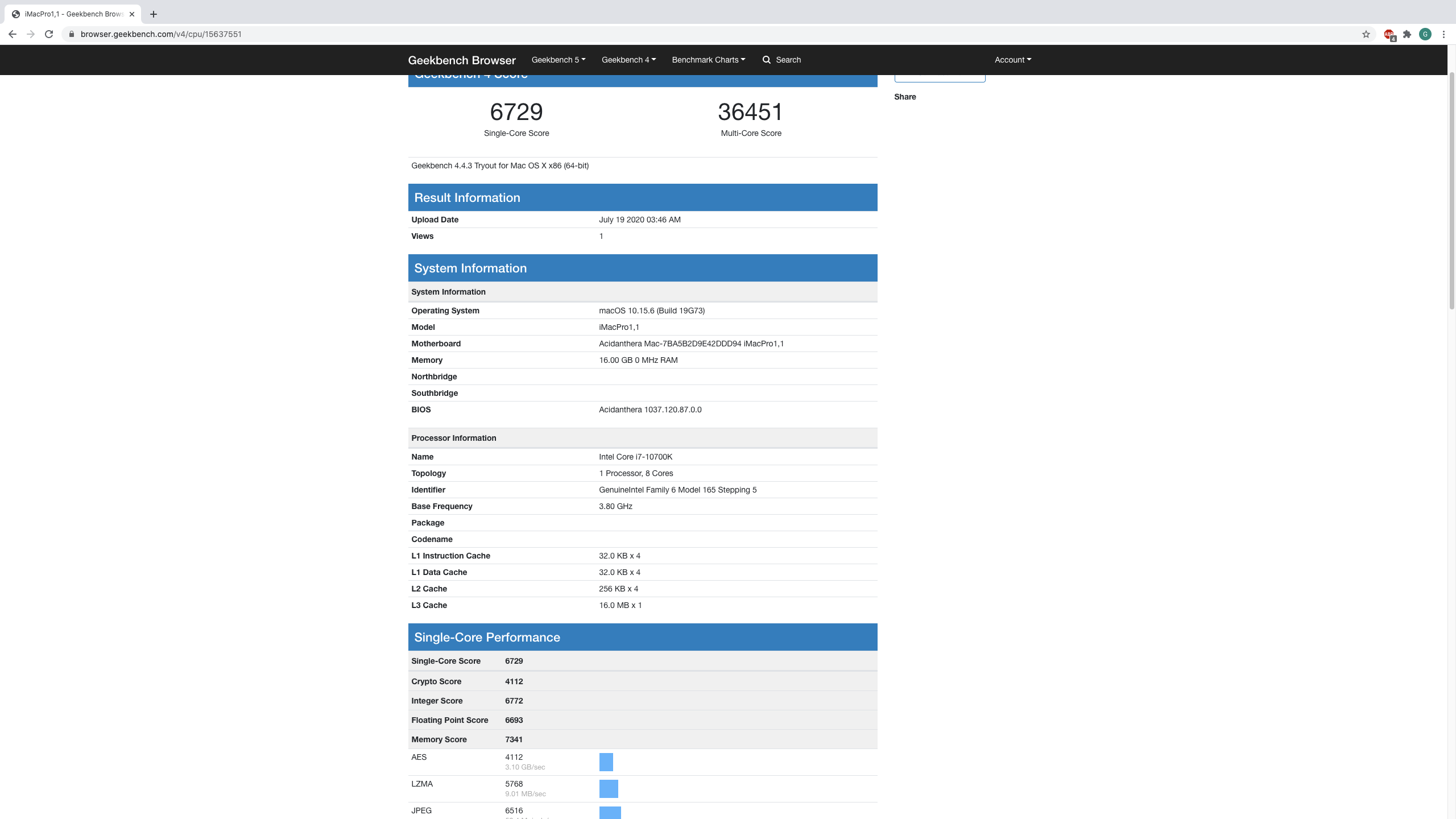

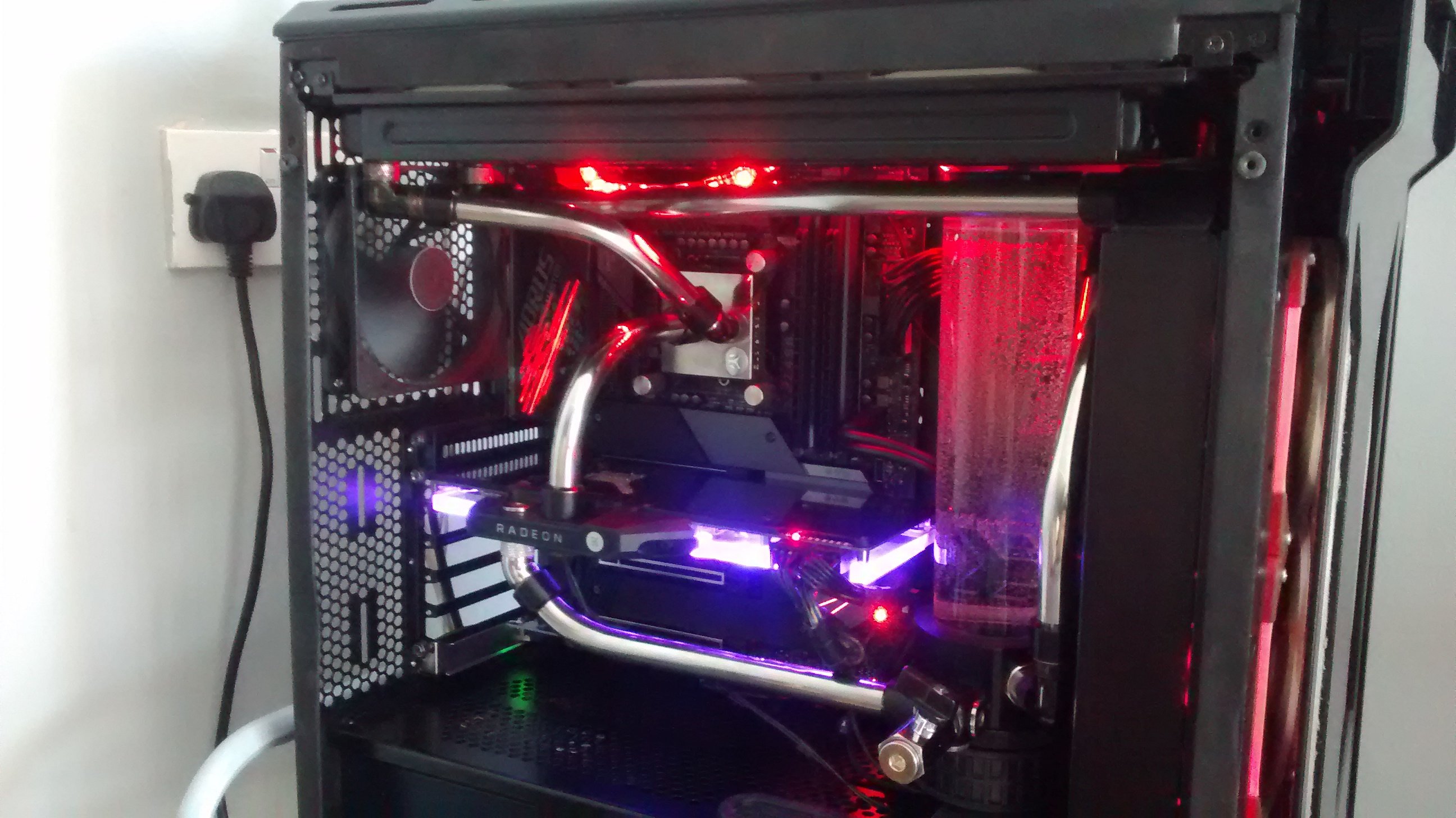

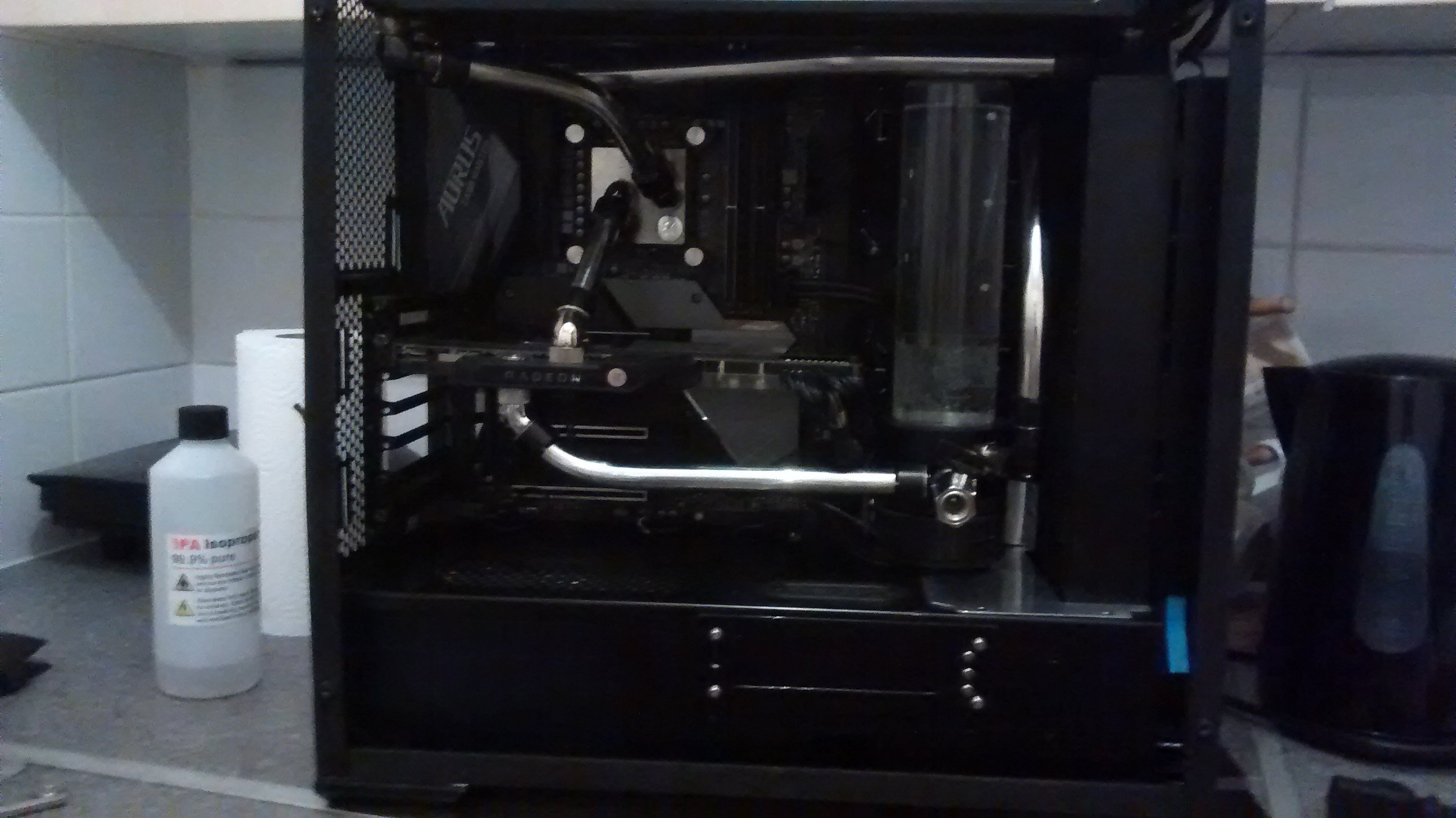

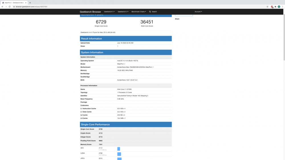

BALDY_MAN Posted July 3, 2020 Share Posted July 3, 2020 (edited) Hi all just posting my Gigabyte Master Z490. 19700k Hackintosh. im using opencore with a EFI Folder kindly given to me by MaLd0n i can see the sound icons but Sound works though Desplay port.but at the moment i dont have internet working so im writing this from windows. i have only just completed this build.over the last two days. as bending the stainless takes time. and im learning about this new bios layout hope you like the photographs 19/7/2020. now using big sur Edited July 20, 2020 by BALDY_MAN Added photograph geek bench 1 Link to comment https://www.insanelymac.com/forum/topic/344388-gigabyte-masters-z490-10700k-hackintosh/ Share on other sites More sharing options...

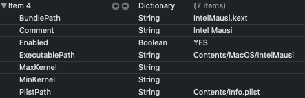

dannyboy9 Posted July 3, 2020 Share Posted July 3, 2020 (edited) For the internet, headover to your config.plist Kernel>Add>Item 4 and check if your BundlePath is the kext that must work with your board. Myself using a GB board, I went with Intel Mausi. Rename BundlePath to Quote IntelMausi.kext and also change the ExecutablePath to Quote Contents/MacOS/IntelMausi That's all! Edited July 3, 2020 by dannyboy9 Link to comment https://www.insanelymac.com/forum/topic/344388-gigabyte-masters-z490-10700k-hackintosh/#findComment-2728487 Share on other sites More sharing options...
BALDY_MAN Posted July 3, 2020 Author Share Posted July 3, 2020 1 hour ago, dannyboy9 said: For the internet, headover to your config.plist Kernel>Add>Item 4 and check if your BundlePath is the kext that must work with your board. Myself using a GB board, I went with Intel Mausi. Rename BundlePath to and also change the ExecutablePath to That's all! @dannyboy9 Thank for replying. i will give it a try. as im very new to openCore as. was using ozmosis bios on my old motherboard. thanks again Link to comment https://www.insanelymac.com/forum/topic/344388-gigabyte-masters-z490-10700k-hackintosh/#findComment-2728488 Share on other sites More sharing options...
dannyboy9 Posted July 3, 2020 Share Posted July 3, 2020 43 minutes ago, BALDY_MAN said: @dannyboy9 Thank for replying. i will give it a try. as im very new to openCore as. was using ozmosis bios on my old motherboard. thanks again No issues! I've added my screenshot for your reference. If your Ethernet kext does not look like anything that is ethernet based in item 4, then it should be the either number mentioned in the 'Add' subset. Link to comment https://www.insanelymac.com/forum/topic/344388-gigabyte-masters-z490-10700k-hackintosh/#findComment-2728490 Share on other sites More sharing options...

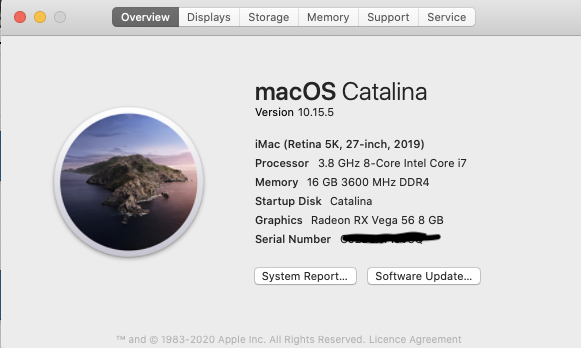

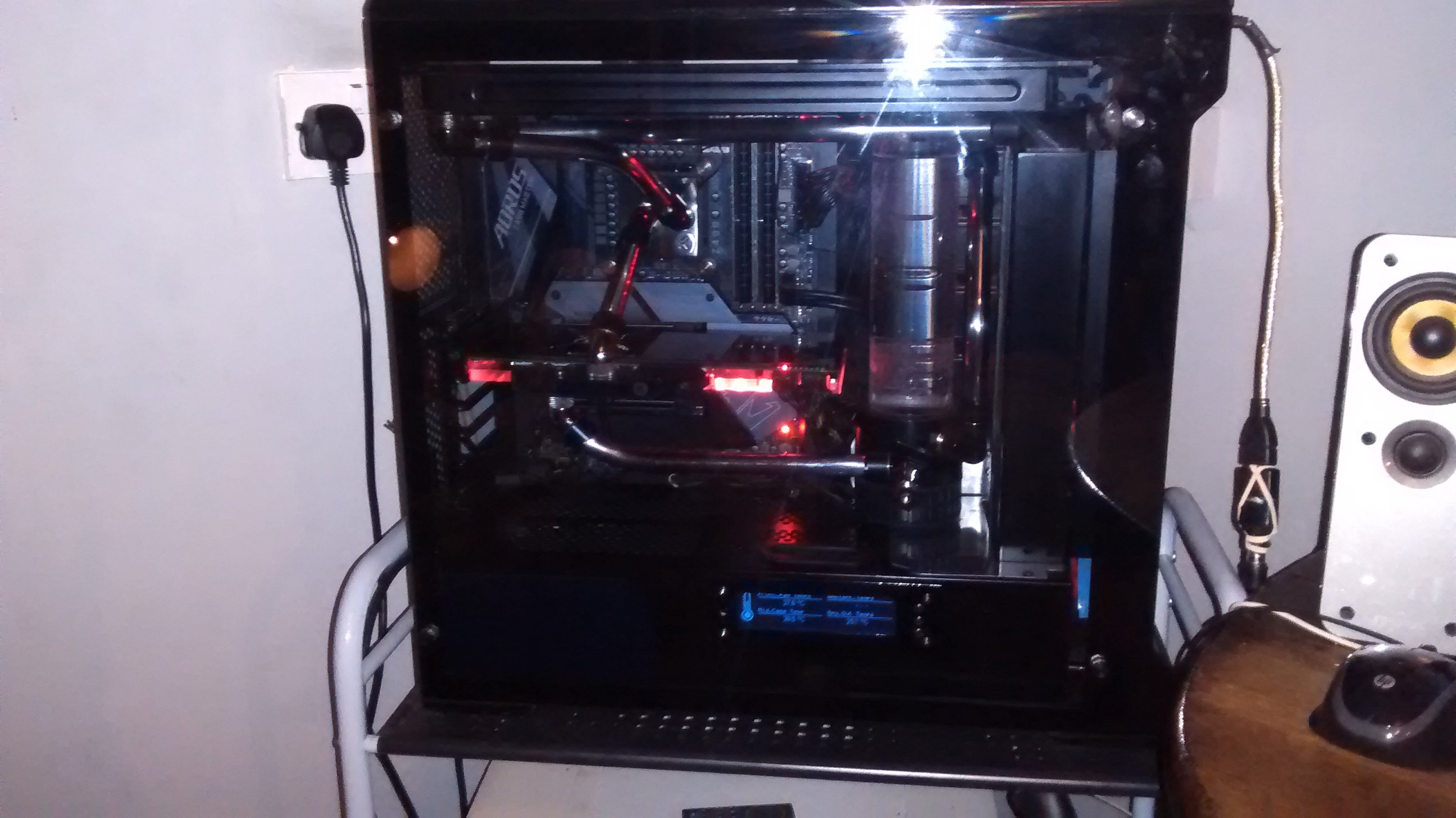

BALDY_MAN Posted July 4, 2020 Author Share Posted July 4, 2020 2 hours ago, eSaF said: @BALDY_MAN - Congrats on the new rig, looks amazing PS - I know it's only cosmetic but purely for a realistic look like a real Mac, you're missing Mac model on your pic, see examples, apart from that still looks amazing, @eSaF Thanks for comment. as i said The efi to make it possibul for me was kindly given by MaLd0n. so im still trying to get my head around things.(ie.the bois as changed alot since z97days) ive just orded a cheap usb wifi dongle. till next month and i will get a wifi card sorted.then. as i cant use macos on the internet i have to boot to windows for internet. i need to sort out some tool to build opencore.. i would like to do this in mac os. as the new on going project. for me. and it will evolve over time new on going project. and will evolve over time. Link to comment https://www.insanelymac.com/forum/topic/344388-gigabyte-masters-z490-10700k-hackintosh/#findComment-2728515 Share on other sites More sharing options...

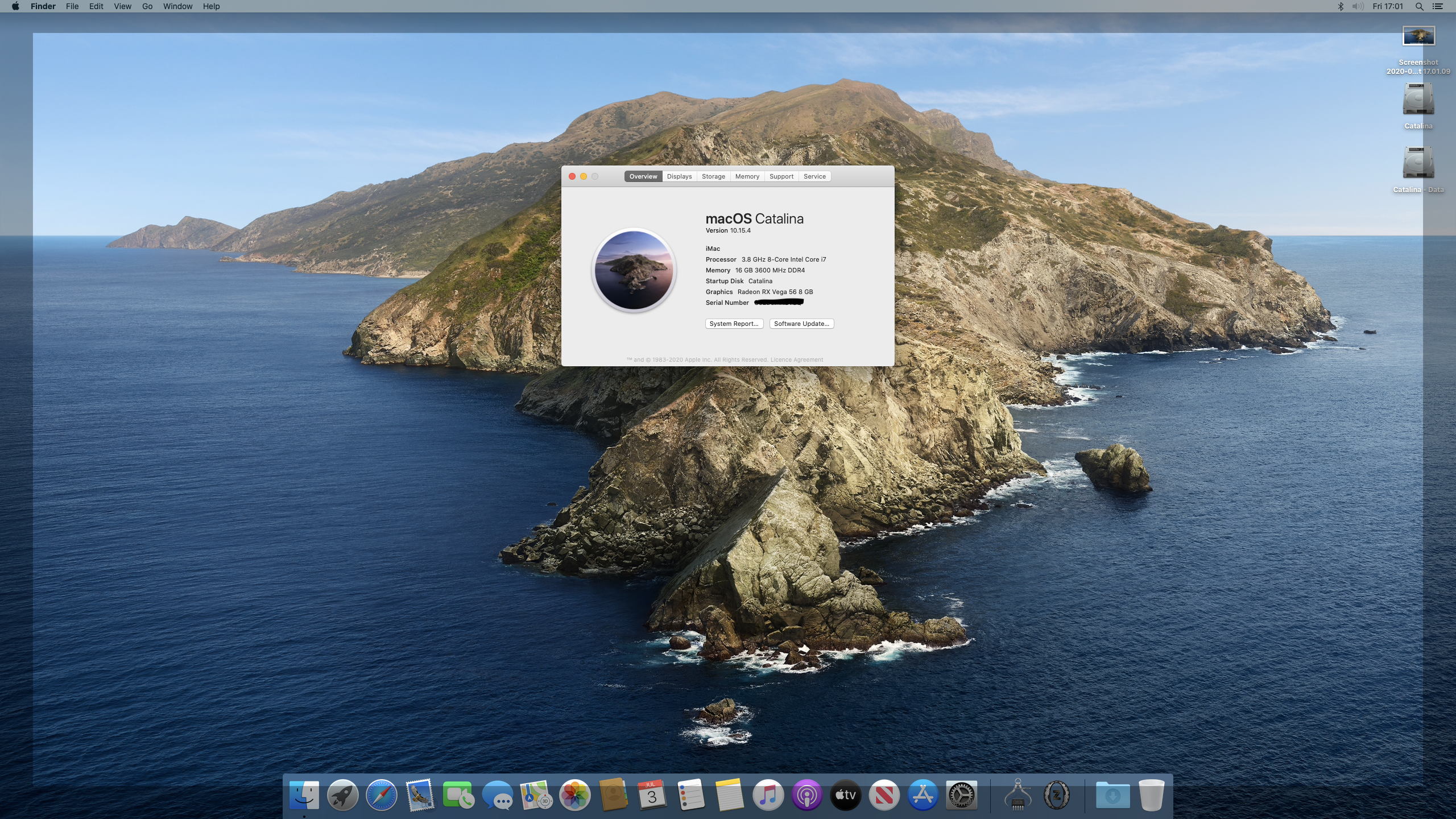

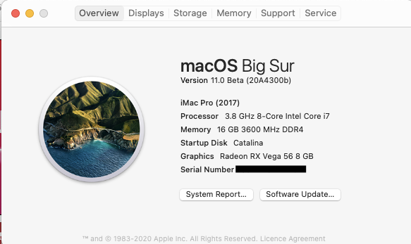

BALDY_MAN Posted July 5, 2020 Author Share Posted July 5, 2020 (edited) I Now Have internet working only from wifi but its cool for now. and sound via DESPLY port it a good start thanks for all you encouragement and help @eSaF Just updated to 10.15.5 and iMac shows up now Edited July 5, 2020 by BALDY_MAN added info Link to comment https://www.insanelymac.com/forum/topic/344388-gigabyte-masters-z490-10700k-hackintosh/#findComment-2728629 Share on other sites More sharing options...
