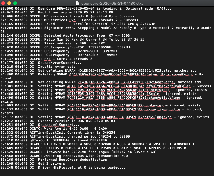

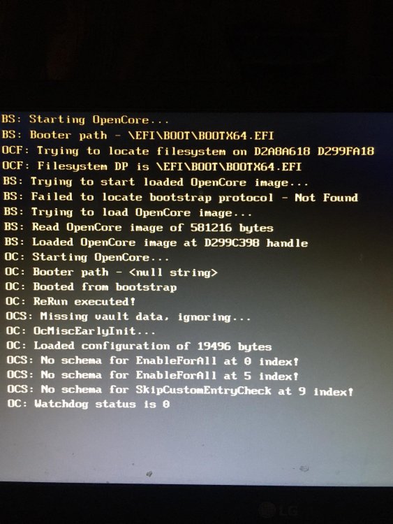

treblA Posted May 21, 2020 Share Posted May 21, 2020 (edited) Hi i'm new with opencore i followed the instructions from https://dortania.github.io/OpenCore-Desktop-Guide/ and check my config.plist via sanity checker and it says no error..can sombedy pls tell me how to fix this....thanks in advance Attached is my config.plist and log sopencore-2020-05-21-041307.txt My specs are as follows : Mobo : GA B75M-D3V Processor is 17 2600 Memmory 8gb DDR3 Graphics is Nvidia Geforce GT 710 2gb Kingston SSD 240gb Kingston SSD 120gb config.plist Edited May 21, 2020 by treblA Link to comment Share on other sites More sharing options...
MacNB Posted May 21, 2020 Share Posted May 21, 2020 14 hours ago, treblA said: Hi i'm new with opencore i followed the instructions from https://dortania.github.io/OpenCore-Desktop-Guide/ and check my config.plist via sanity checker and it says no error..can sombedy pls tell me how to fix this....thanks in advance Attached is my config.plist and log sopencore-2020-05-21-041307.txt My specs are as follows : Mobo : GA B75M-D3V Processor is 17 2600 Memmory 8gb DDR3 Graphics is Nvidia Geforce GT 710 2gb Kingston SSD 240gb Kingston SSD 120gb config.plist Your config.plist seems to from a NDK's fork of OpenCore and not the Official OC. Which OC are you using ? Your config has several errors : DeviceProperties - ig-platform-ie should be ig-platform-id Your Kexts->Add for Sensors Plugins path are incorrect Your motherboard has UEFI BIOS from Gigabyte so have checked if it has working NVRAM ? If so, then you do not need to enable NVRAM->LegacyEnable Try attached corrected config treblA-config.plist Link to comment Share on other sites More sharing options...

treblA Posted May 22, 2020 Author Share Posted May 22, 2020 6 hours ago, MacNB said: Your config.plist seems to from a NDK's fork of OpenCore and not the Official OC. Which OC are you using ? Your config has several errors : DeviceProperties - ig-platform-ie should be ig-platform-id Your Kexts->Add for Sensors Plugins path are incorrect Your motherboard has UEFI BIOS from Gigabyte so have checked if it has working NVRAM ? If so, then you do not need to enable NVRAM->LegacyEnable Try attached corrected config treblA-config.plist Sir i tried to use the config.plist that u edit but still the same error and i disable the NVRAM->Legacy but still the same error :-( hope u could help me solved my problem.... Thanks again Sir Link to comment Share on other sites More sharing options...

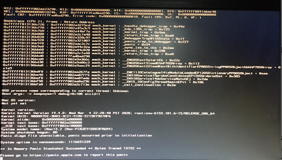

vit9696 Posted May 22, 2020 Share Posted May 22, 2020 SandyBridge CPU does not support RDRAND, so a different version of HfsPlus will be needed — HfsPlusLegacy. 1 Link to comment Share on other sites More sharing options...

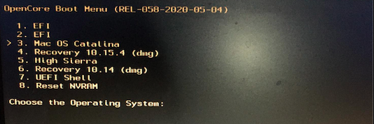

treblA Posted May 22, 2020 Author Share Posted May 22, 2020 (edited) I finally get to the picker list but another error appears What i did is used the config.plist that Sir Sage and change the following Change Nvram WriteFlash to NO Change LegacyEnable to NO Removed HfsPlus.efi to NO opencore-2020-05-22-101521.txt config.plist Edited May 22, 2020 by treblA Link to comment Share on other sites More sharing options...
treblA Posted May 22, 2020 Author Share Posted May 22, 2020 (edited) Yey Thanks everyone for the help to Sir MacNB and vit9696 my opencore installer is finally working...i used the config.plist that sir MacNB gave me and followed Sir vit9696 to download the HsfPlusLegacy.efi...again thanks everyone for your help... Thanks Insanelymac :-) Edited May 23, 2020 by treblA Link to comment Share on other sites More sharing options...
