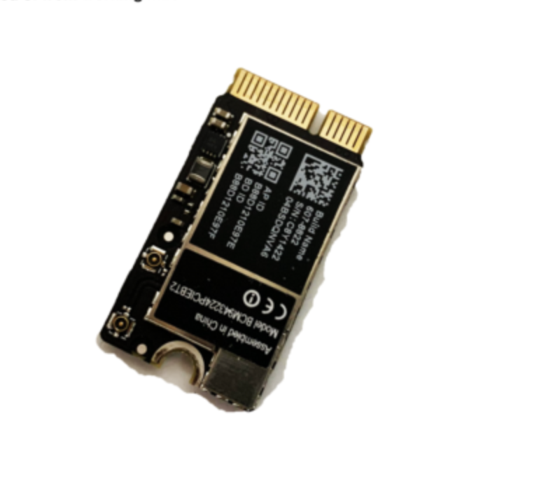

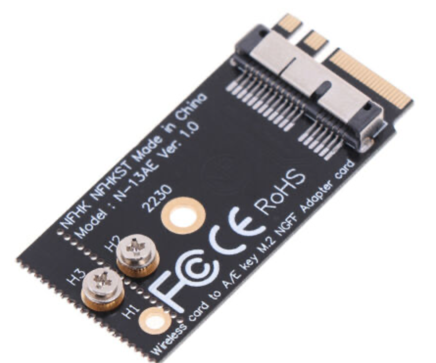

luki1979 Posted February 9, 2020 Share Posted February 9, 2020 Just want to let you know guys that it's obviously working but WIFI part needed AirportBrcmFixup.kext otherwise card wasn't recognised, Bluetooth part worked OTB. The seller swore that card is genuine. Adapter works with BCM94360CS2 and BCM943224PCIEBT2 but I had to use the latter as I have extremely small case. Link to comment https://www.insanelymac.com/forum/topic/342522-bcm943224pciebt2-macbook-air-on-m2-ngff-adapter/ Share on other sites More sharing options...

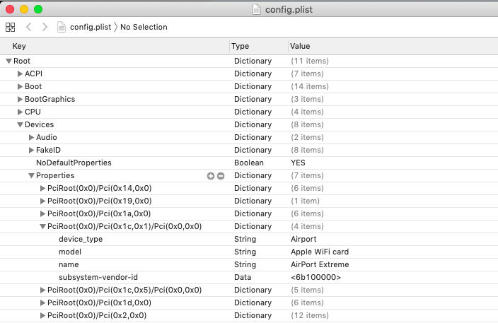

Slice Posted February 11, 2020 Share Posted February 11, 2020 I have BCM43224 on my Dell laptop. It works like a charm in 5GHz. I have to set Board-ID=Mac-2E6FAB96566FE58C and some properties for the device Lilu is not needed. 1 Link to comment https://www.insanelymac.com/forum/topic/342522-bcm943224pciebt2-macbook-air-on-m2-ngff-adapter/#findComment-2707826 Share on other sites More sharing options...
luki1979 Posted February 11, 2020 Author Share Posted February 11, 2020 Thanks guys for clearing that up for me. I was not aware of a whitelist. I’m grateful for AirportBrcmFixup kext. I don’t want to change SMBios as Mac mini is best suited for my setup. This little card has a really strong signal both Bluetooth and WiFi. Link to comment https://www.insanelymac.com/forum/topic/342522-bcm943224pciebt2-macbook-air-on-m2-ngff-adapter/#findComment-2707839 Share on other sites More sharing options...
