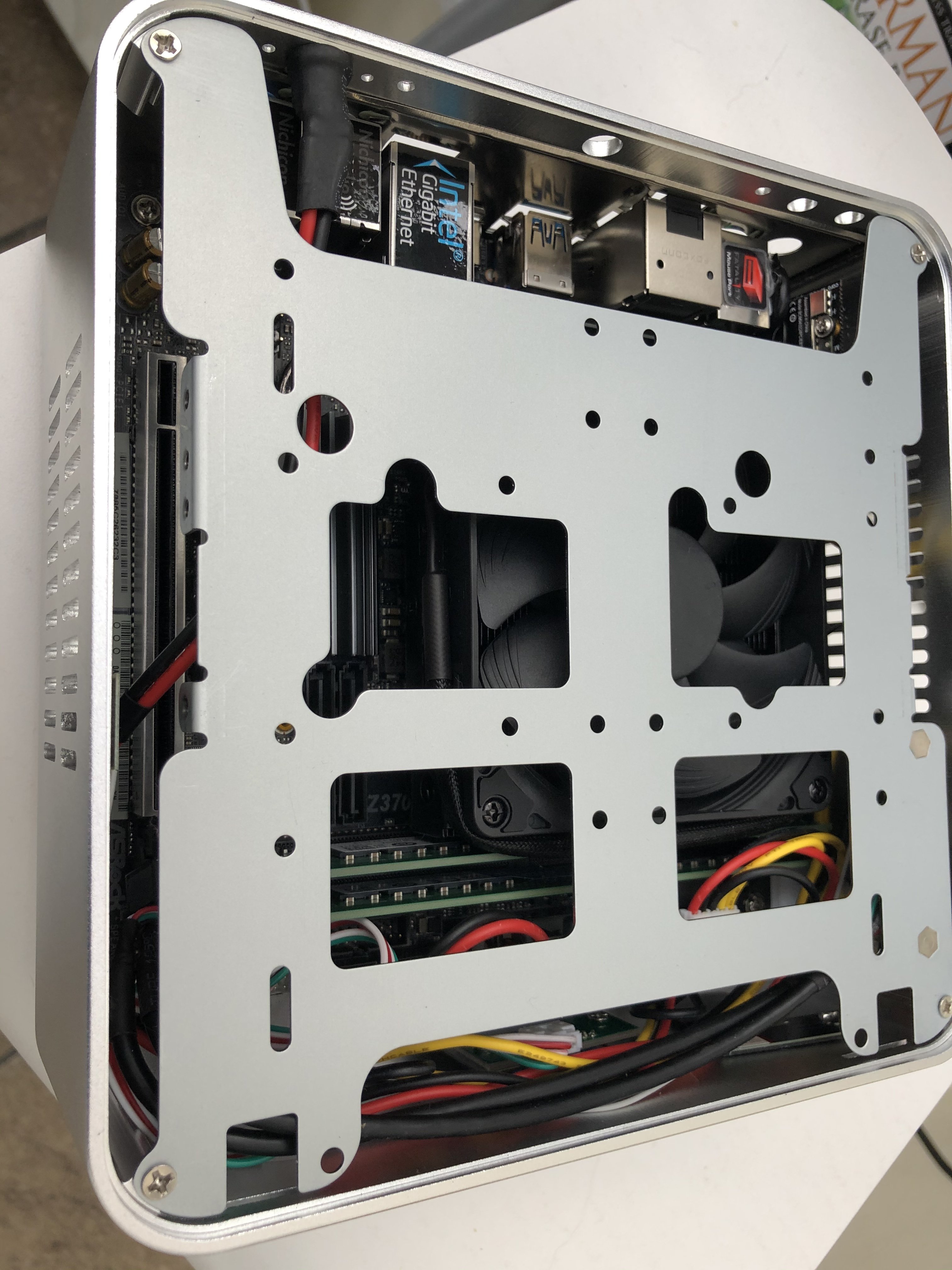

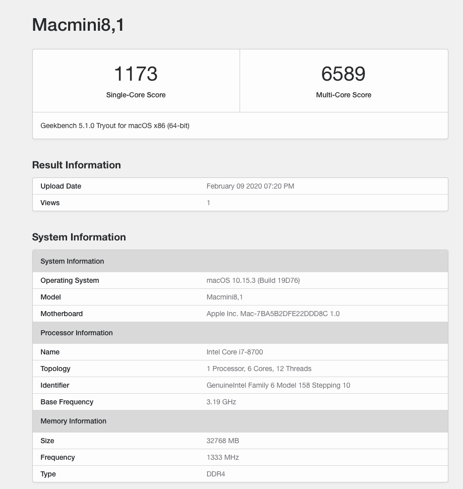

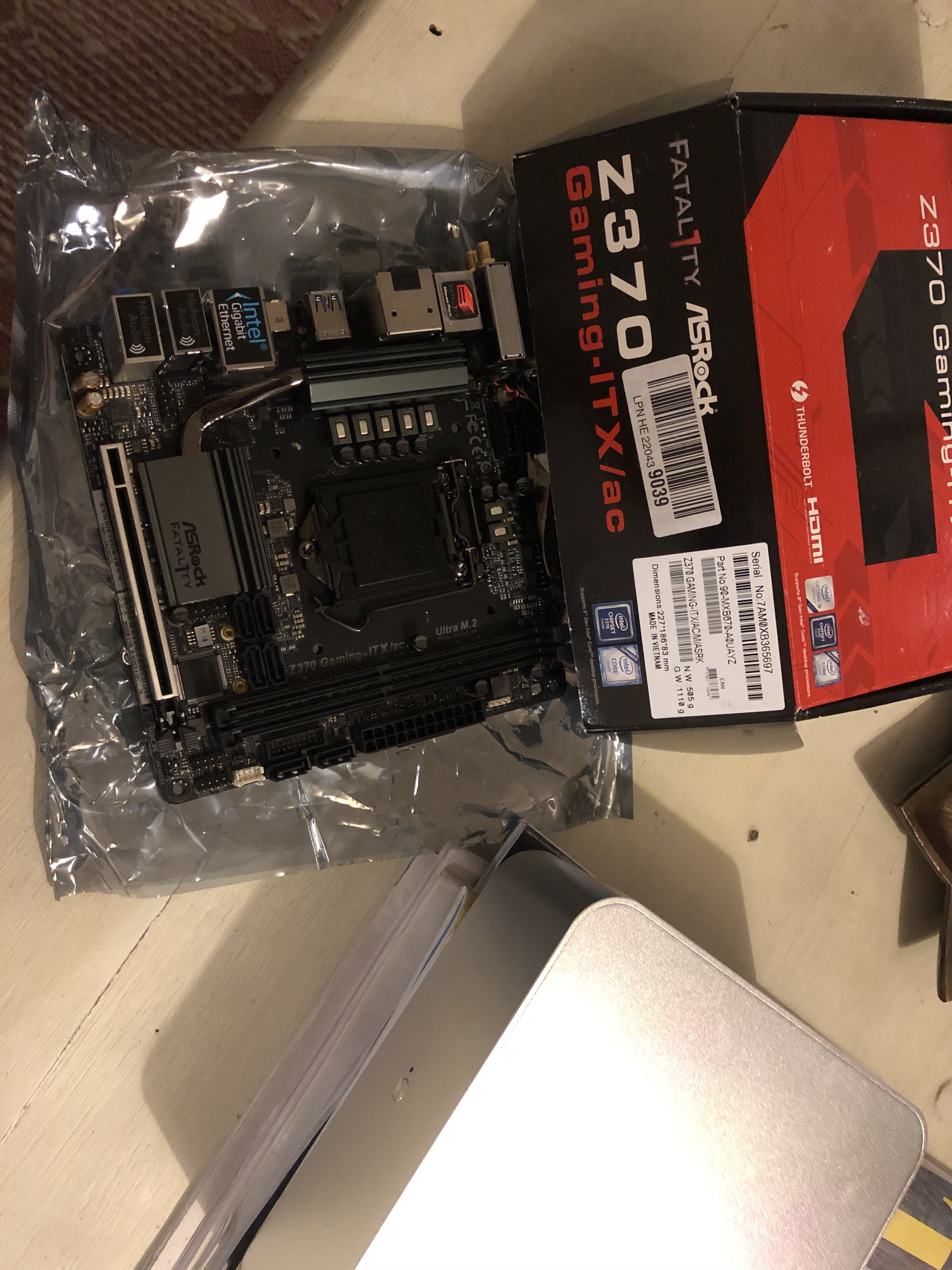

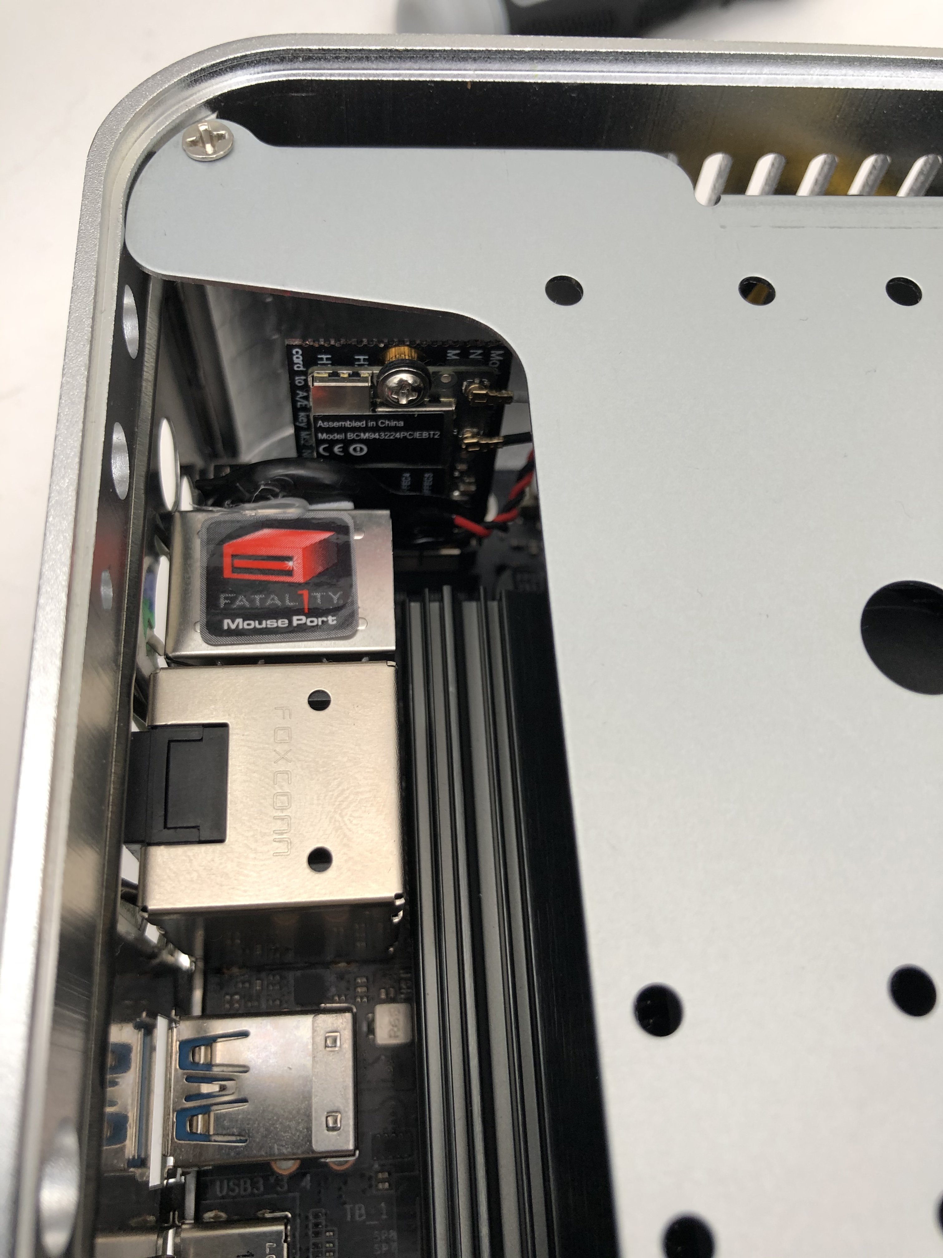

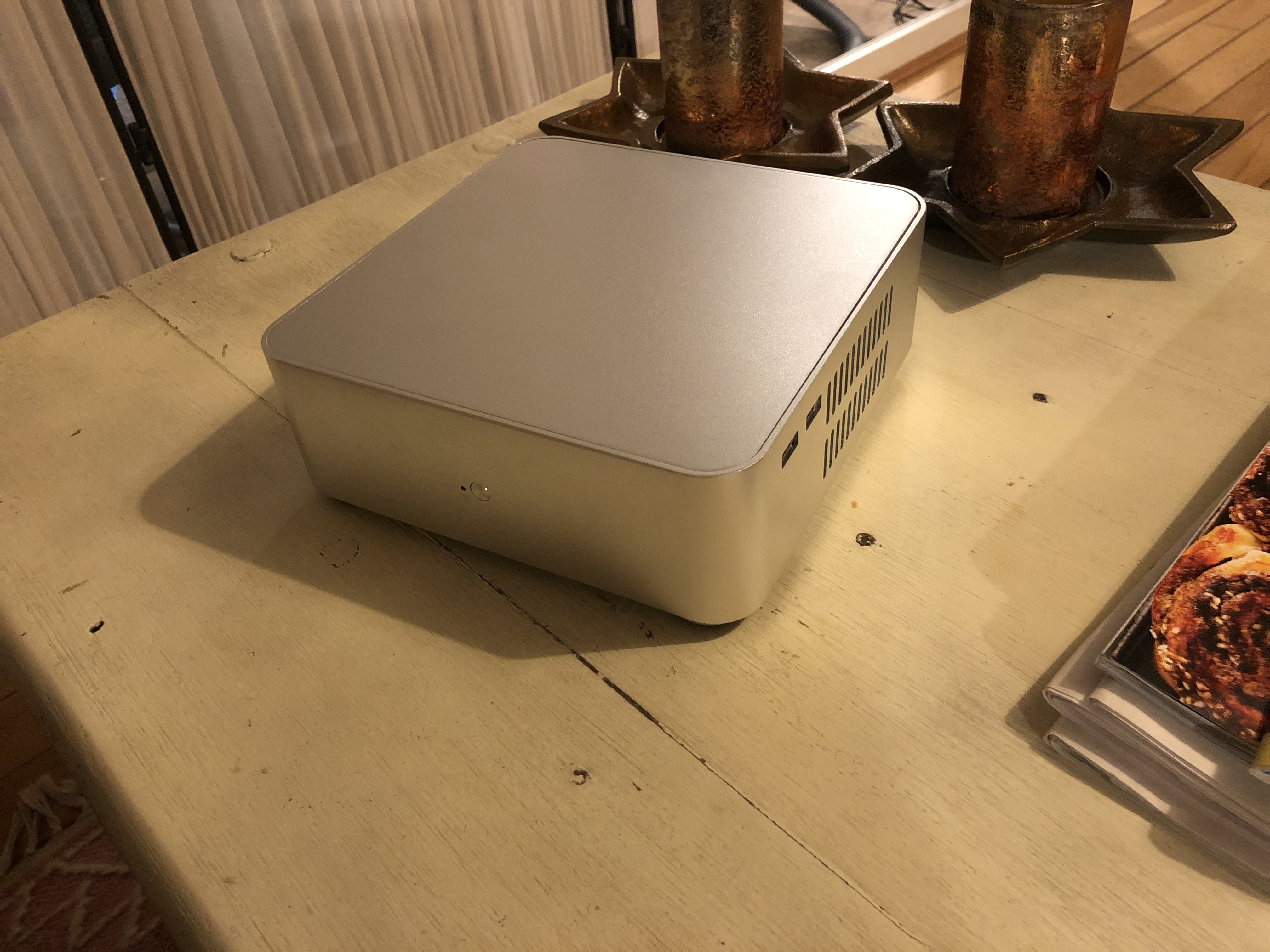

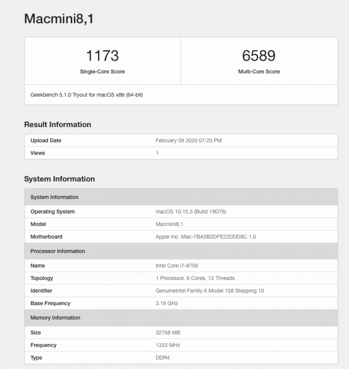

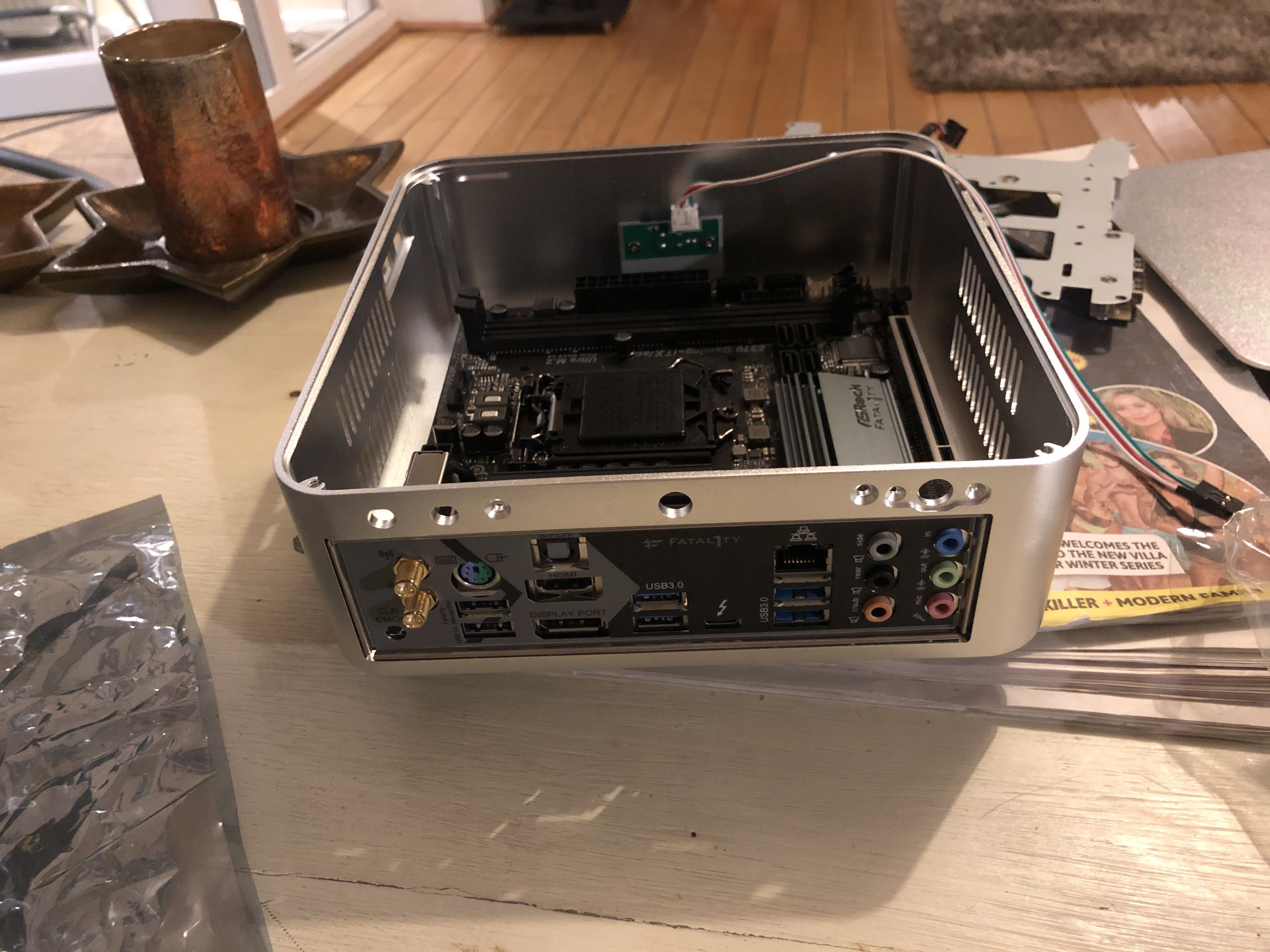

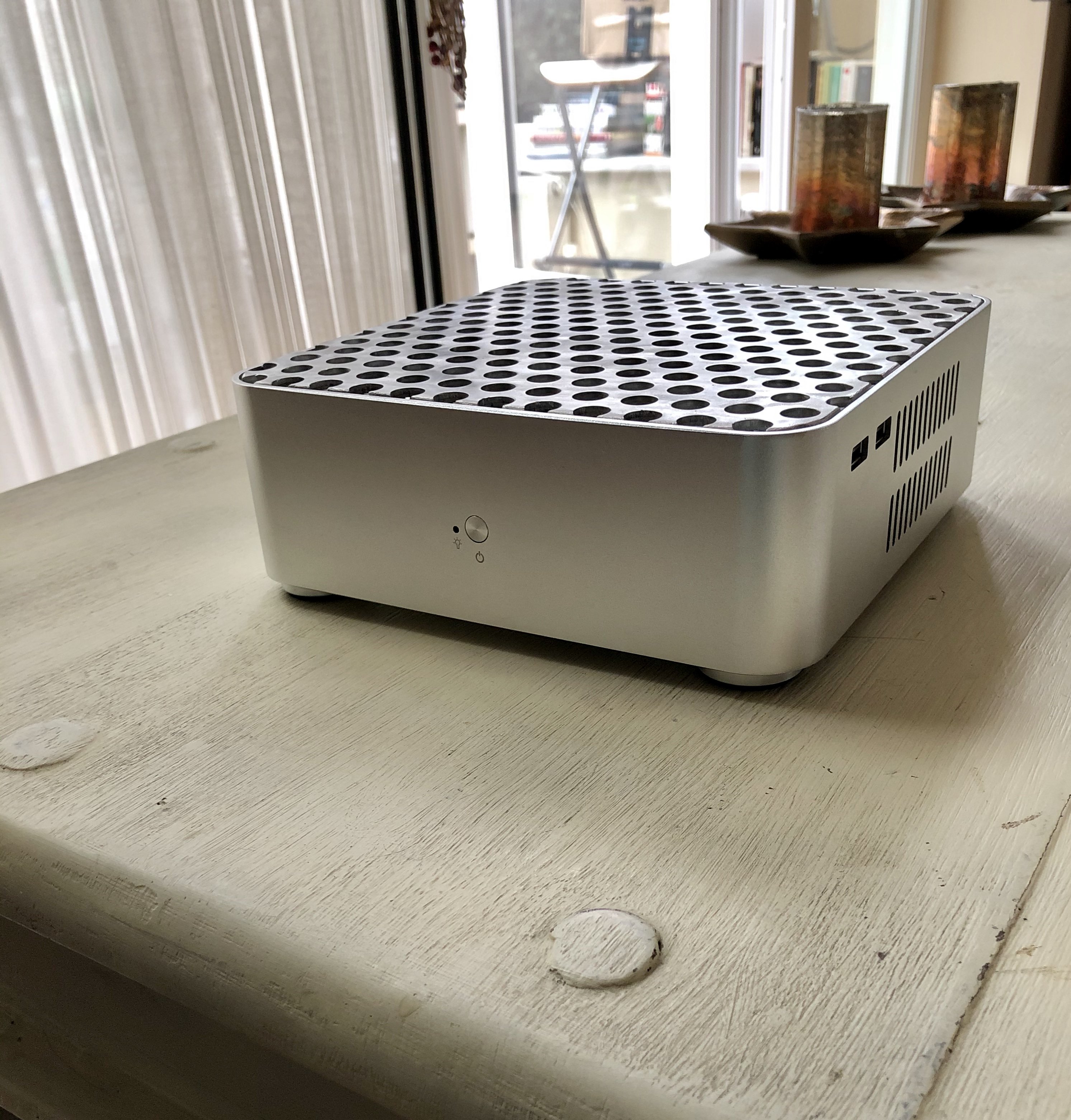

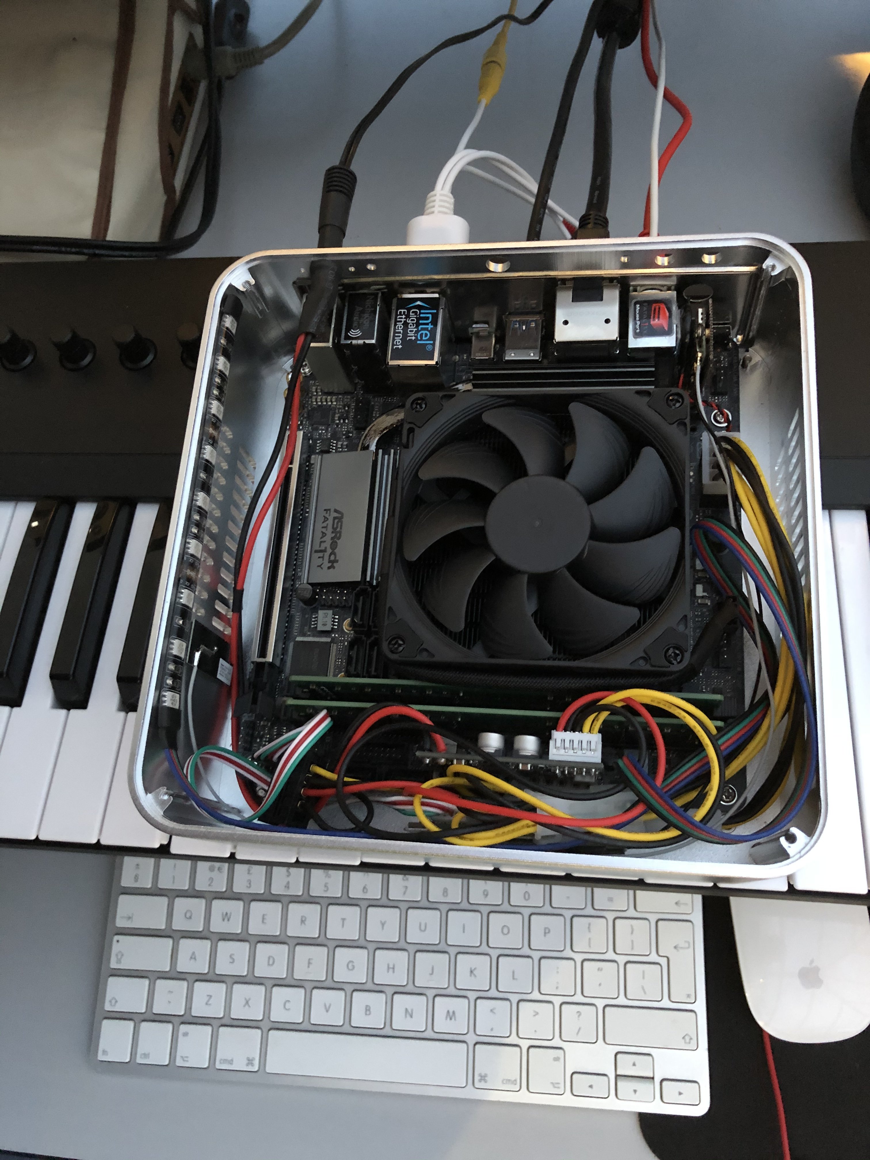

luki1979 Posted February 9, 2020 Share Posted February 9, 2020 (edited) Motherboard: ASRock Fatal1ty Z370 Gaming ITX/AC CPU: i7-8700 Cooler: Noctua NH-L9i Black Ram: 2 x 16GB Crucial 2666 PSU: Pico PSU 250W with Dell 12v 18A Brick HDD: 1TB Intel 660p Nvme SSD WIFI/BT: BCM943224PCIEBT2 on M.2 NGFF adapter Case: Chinese "Aluminium" ITX Cost is about 1/3 of similar spec Mac mini Edit. Final look: Edit 2 Changed Led to green as Apple would do Original case: Edited April 18, 2020 by luki1979 Photo added 1 Link to comment https://www.insanelymac.com/forum/topic/342521-mac-mini-pro-z370-fatal1ty-itx/ Share on other sites More sharing options...

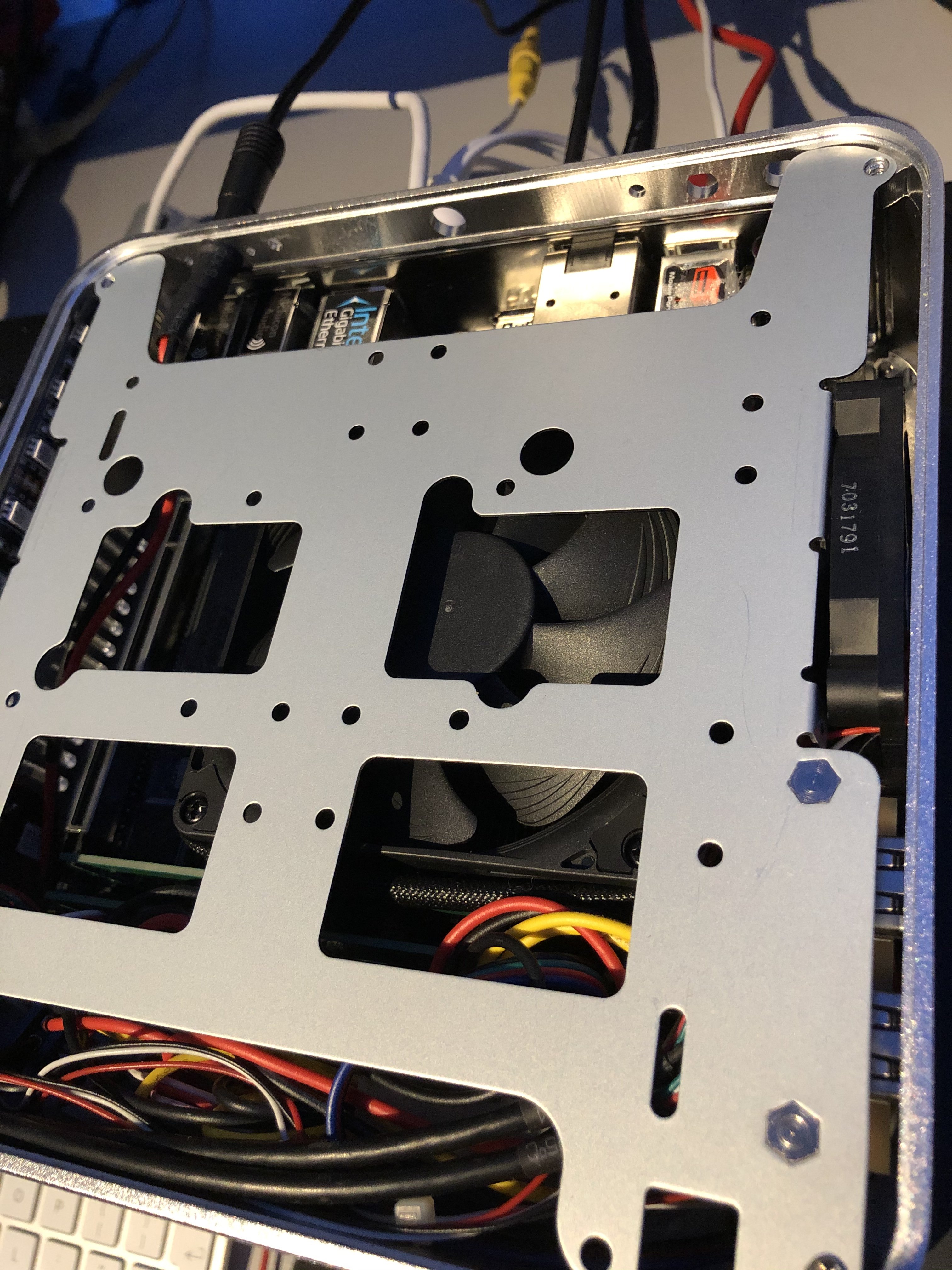

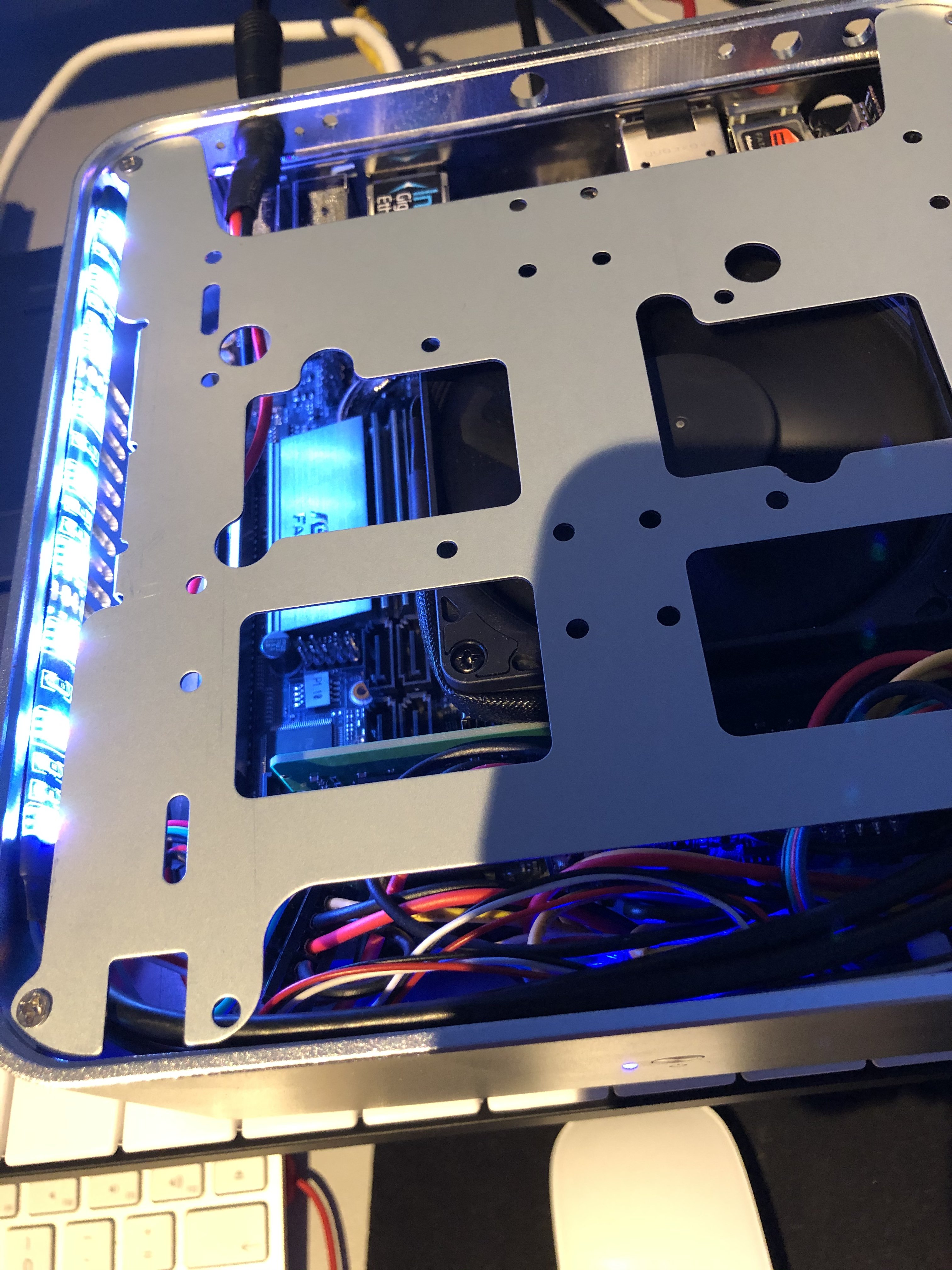

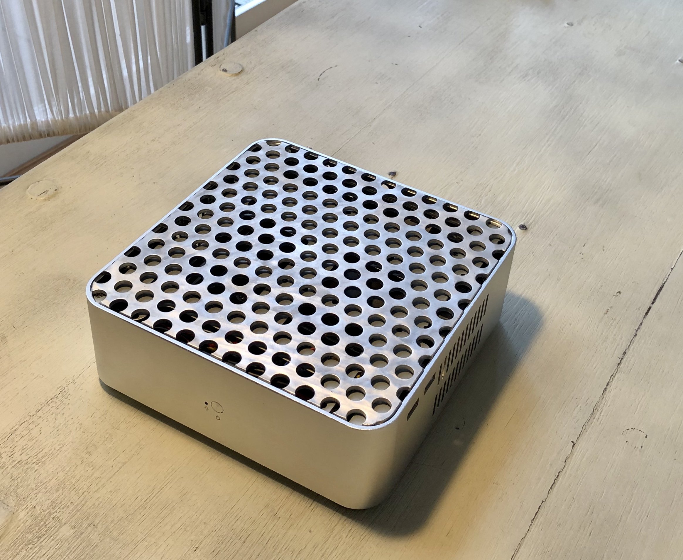

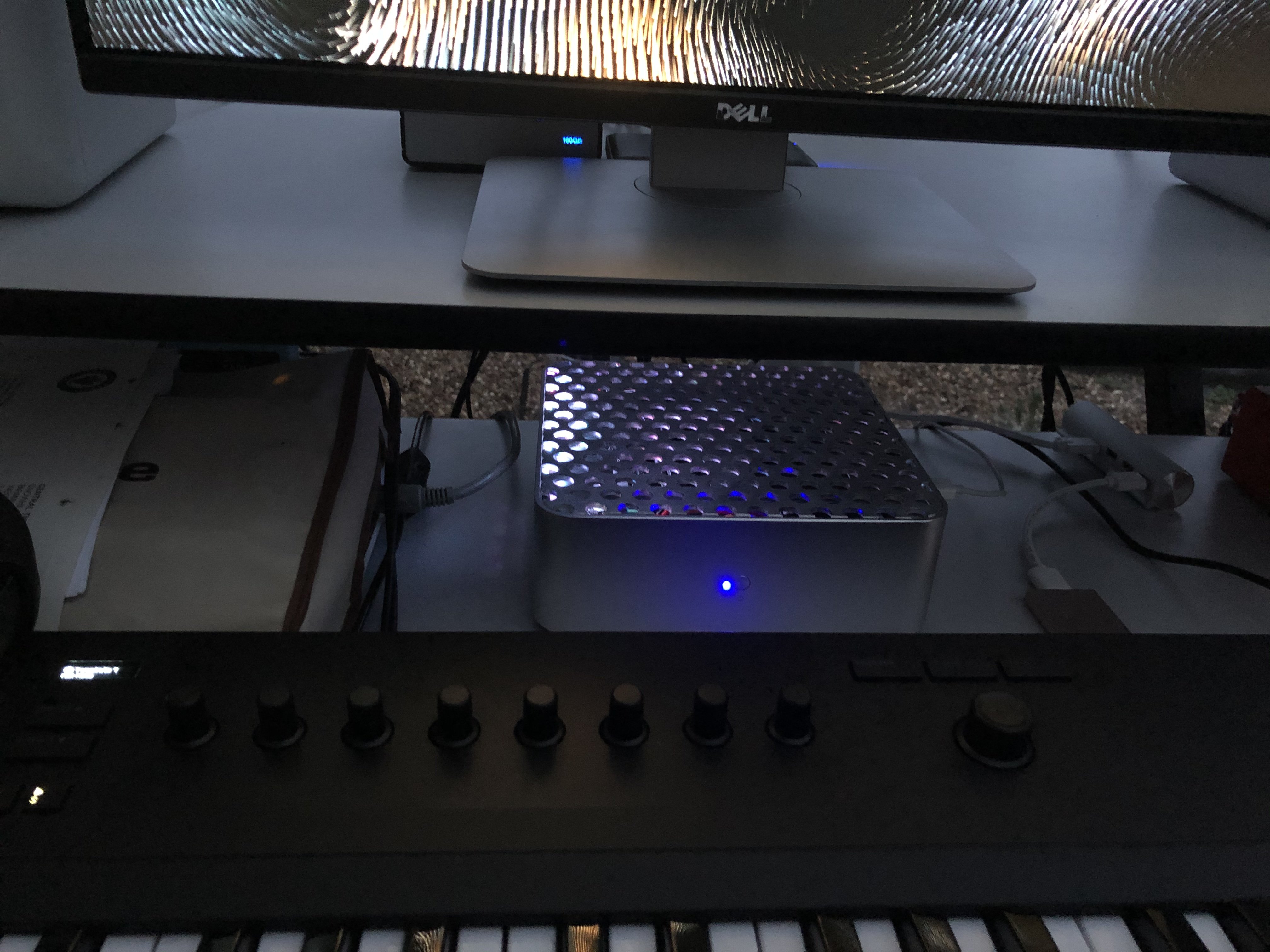

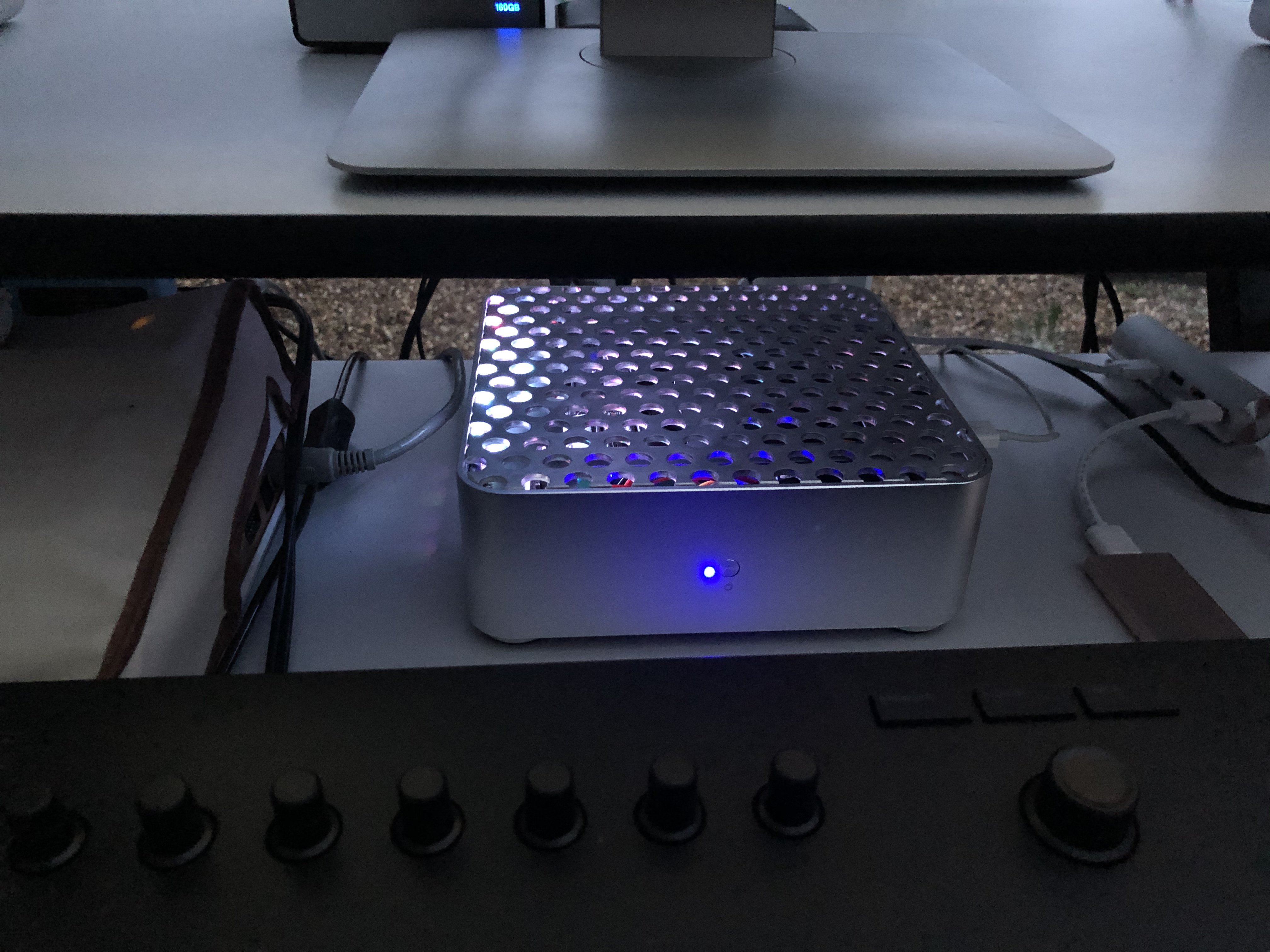

luki1979 Posted February 13, 2020 Author Share Posted February 13, 2020 (edited) Now the modding bit: after few days of usage it become apparent that thermals is such small case are not great. CPU fan just blows hot air into aluminium top and everything becomes super hot inside. I’ve added small 60x10mm fan, which was hard to find if you like quiet one but still to warm to my taste. I just ordered perforated aluminium sheet and going to replace top cover with that. Without the top CPU idle at 30 degrees Celsius and stays under 55 under heavy load. Also added RGB strip, you got to have RGB right? Edited February 13, 2020 by luki1979 Link to comment https://www.insanelymac.com/forum/topic/342521-mac-mini-pro-z370-fatal1ty-itx/#findComment-2708130 Share on other sites More sharing options...

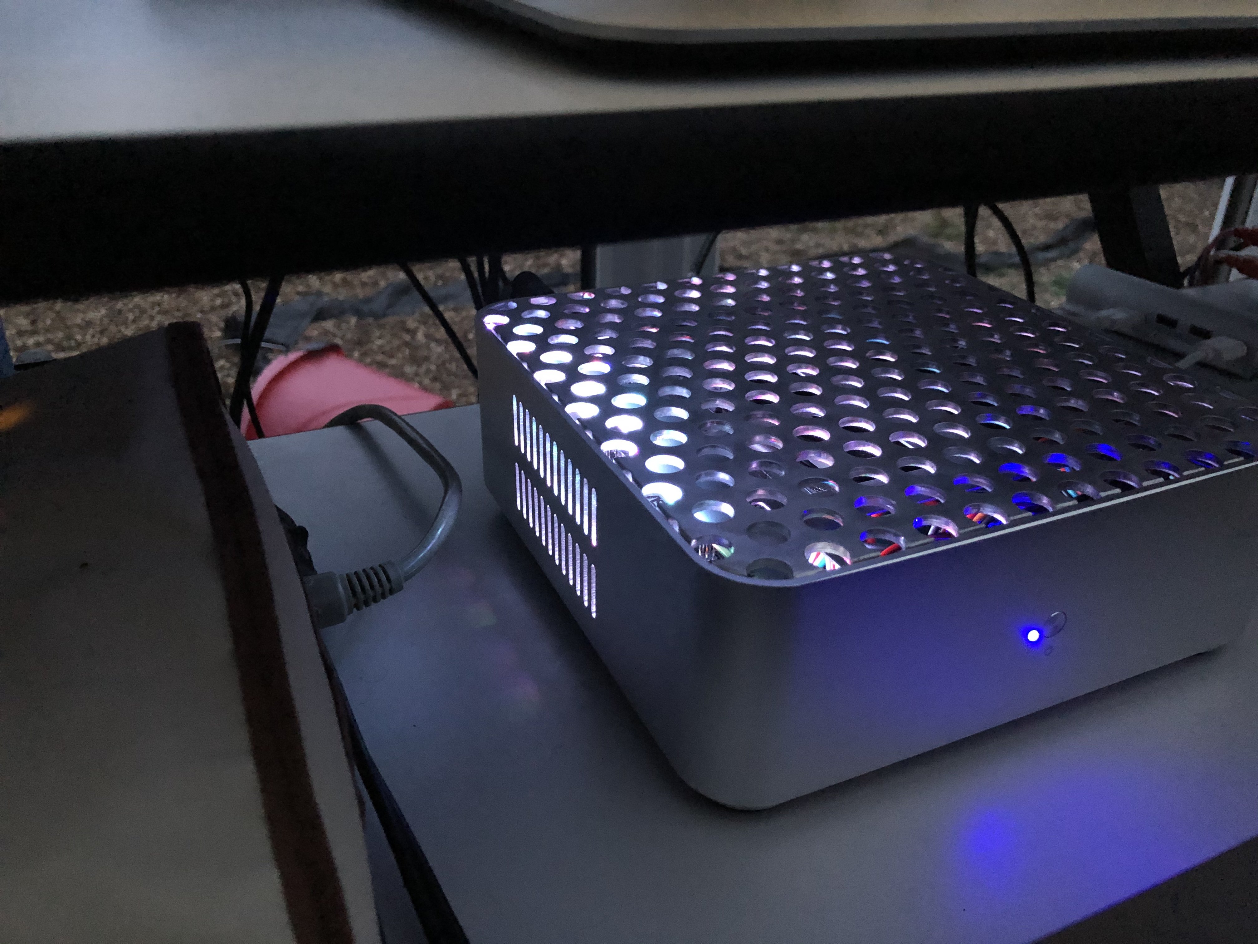

luki1979 Posted February 15, 2020 Author Share Posted February 15, 2020 (edited) The top cover finished. Edited February 15, 2020 by luki1979 1 Link to comment https://www.insanelymac.com/forum/topic/342521-mac-mini-pro-z370-fatal1ty-itx/#findComment-2708380 Share on other sites More sharing options...

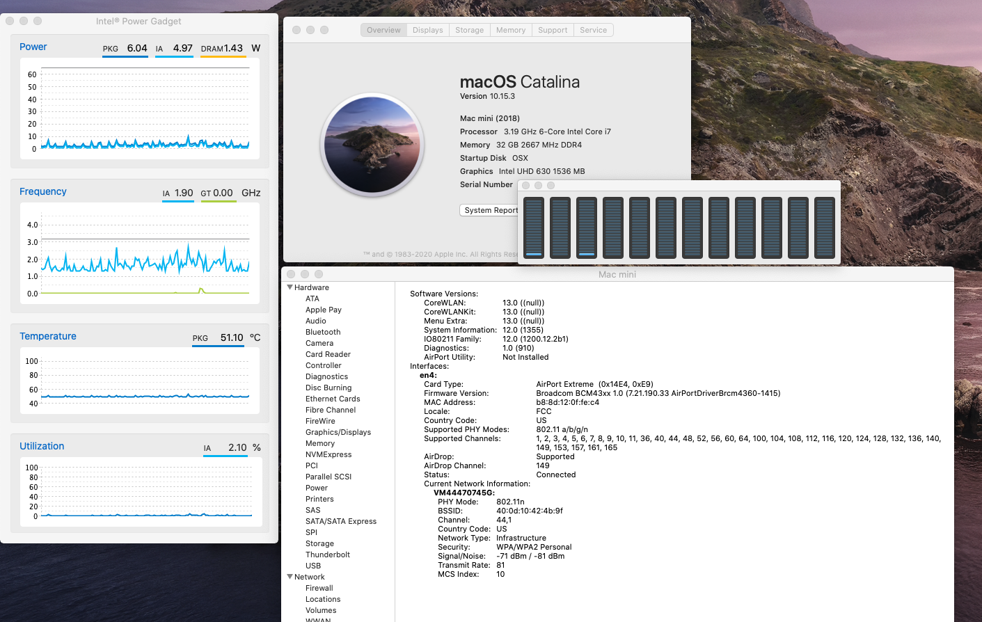

luki1979 Posted February 19, 2020 Author Share Posted February 19, 2020 CPU was not using Turbo mode much, I’ve added 8 pin adapter cable and now it does. Link to comment https://www.insanelymac.com/forum/topic/342521-mac-mini-pro-z370-fatal1ty-itx/#findComment-2709029 Share on other sites More sharing options...

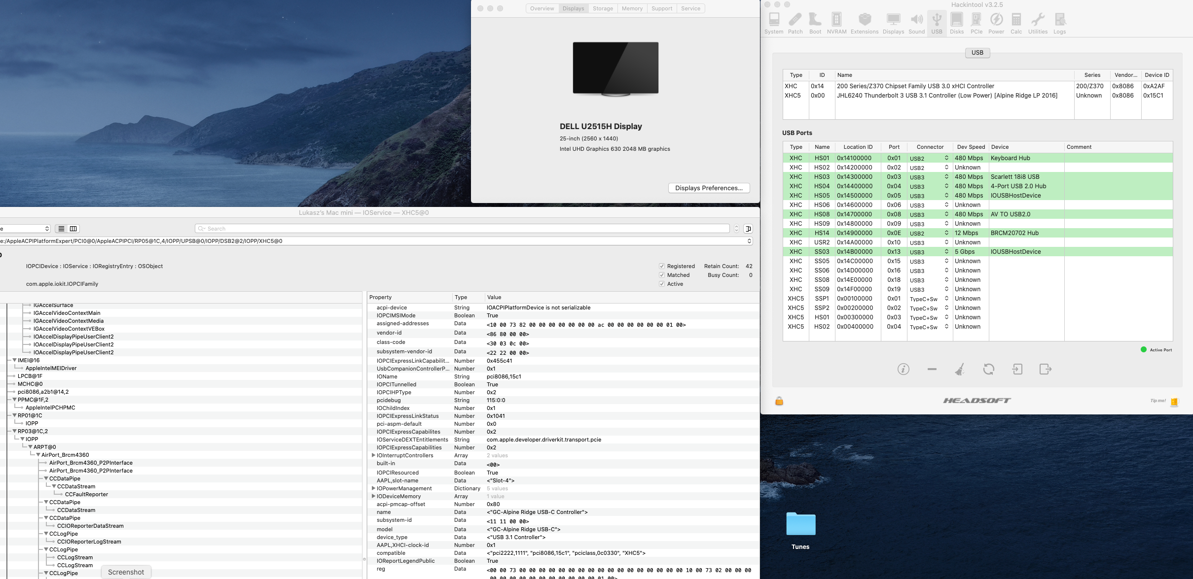

luki1979 Posted March 10, 2020 Author Share Posted March 10, 2020 Thunderbolt and Graphics are fully patched and working. Link to comment https://www.insanelymac.com/forum/topic/342521-mac-mini-pro-z370-fatal1ty-itx/#findComment-2711893 Share on other sites More sharing options...

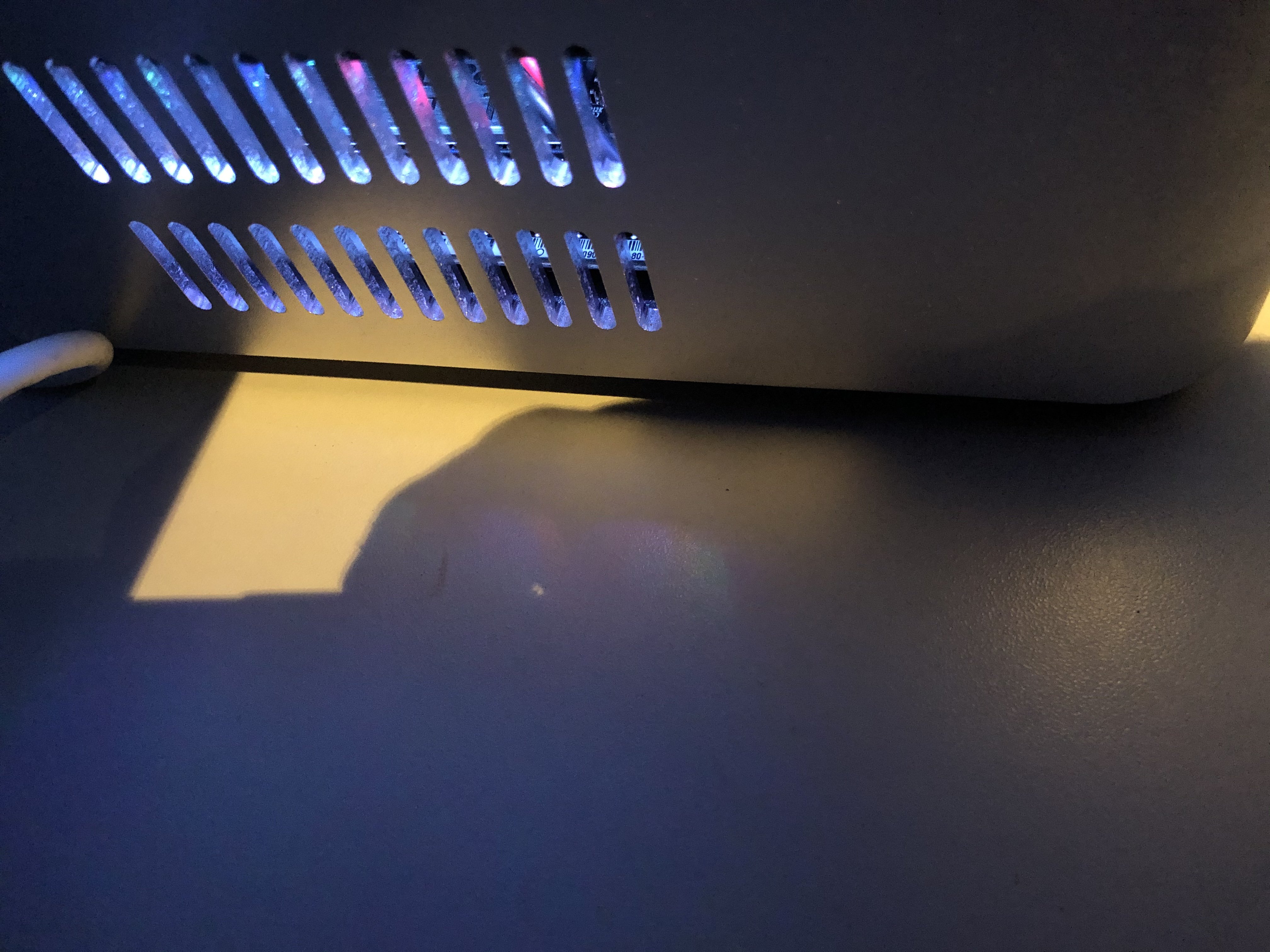

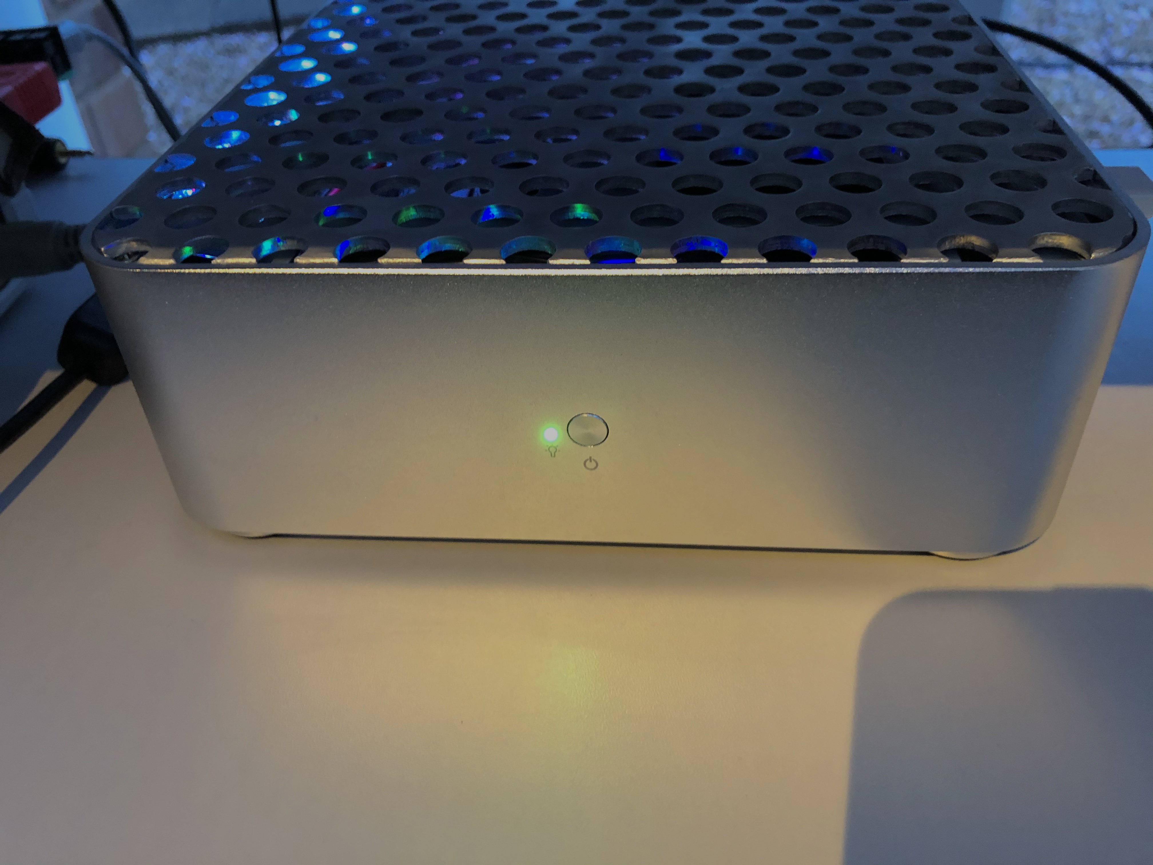

luki1979 Posted April 18, 2020 Author Share Posted April 18, 2020 Green LED Link to comment https://www.insanelymac.com/forum/topic/342521-mac-mini-pro-z370-fatal1ty-itx/#findComment-2718099 Share on other sites More sharing options...
