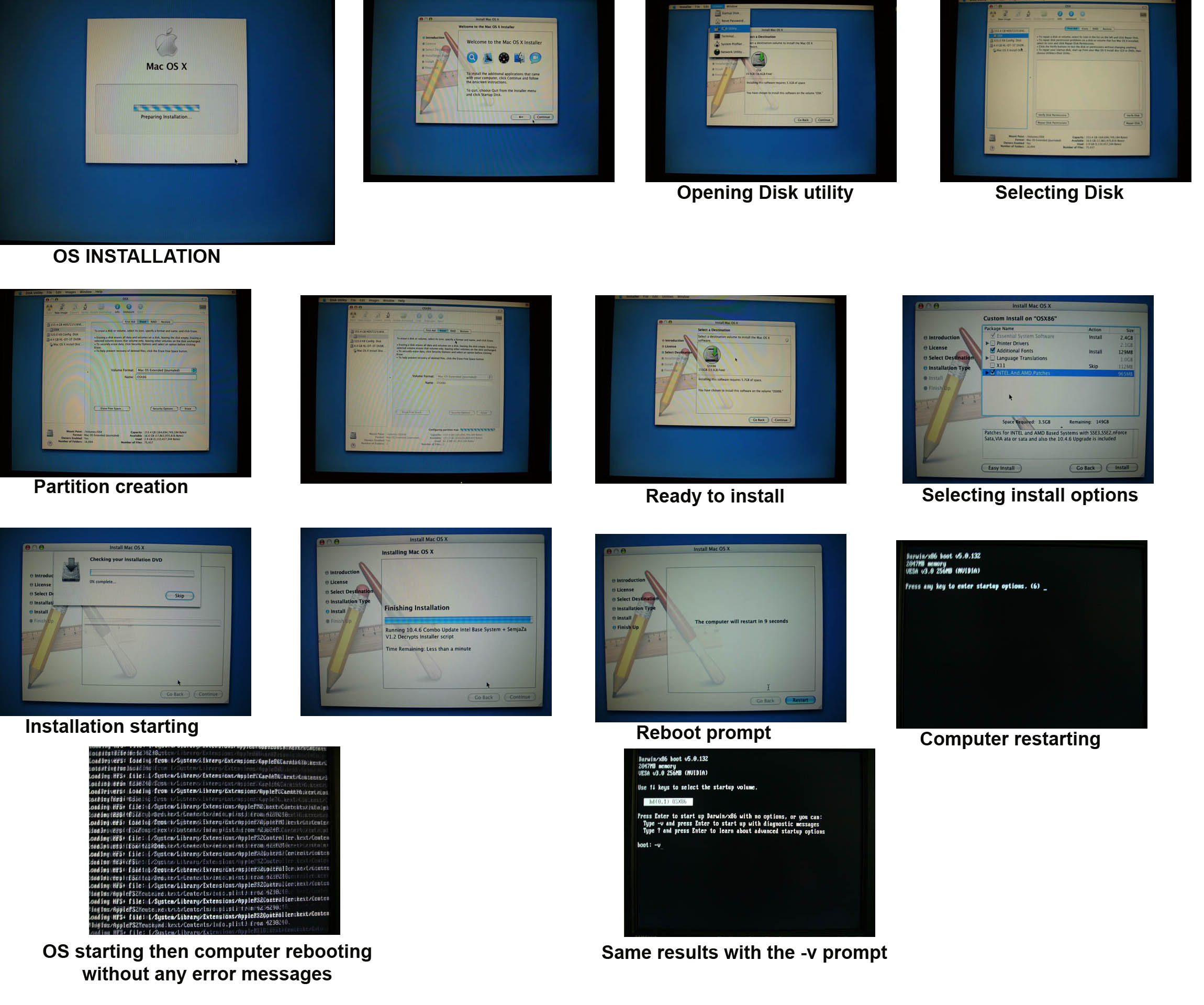

Sinrj Posted November 26, 2006 Share Posted November 26, 2006 Hello all, Thanks for your great database you're making here My Webpage However I didn't find any clue of my problems here so far. I am trying to set up MAC OSX ( I tried both JAS 10.4.6 and HOTISO patched DVD, both burned on DVD+R) as the native OS (on a separate SATA HD, the partition has been set as active) on the following system: ASUS P5W DH-DELUXE Core2Duo E6600 MSI GeForce 7900GT Corsaire 2*1Go DDR2-800 1*SATA 160Go for Mac OSX (I have tried both SATA Chipset) The installation sounds to be successful. However, after each installation I tried (I formated the partition as a MAC Extended and tried MAC Extended journaled), the system reboot and, after booting, it ask me to press F8 for start up otpion or to press any key to load OSX. 1. If I press any key or nothing within the 10seconds: the system seems to load (black screen with a lot of script lines) then, the screen turns black and the computer reboot. 2. If I select F8 and prompt the -v, the system does exactly the same thing, without giving any clue of what the problem is. Any clue? Regards Sinrj Link to comment Share on other sites More sharing options...

Rammjet Posted November 27, 2006 Share Posted November 27, 2006 Setting a partition active tells the BIOS which paritition to boot when there is more than one partition. But here we have OSX as the lone OS on a hard drive. As long as it is set to boot first, it doesn't need to be active. However, it does sound like either the DVD is still in the DVD drive throughout all of this, or the hard drive was not formatted correctly before starting. But that is potentially the minor problem when the system reboots during the boot operation. Need to fix that. Next question is what packages were chosen during the installation. When you selected the Customize window and clicked the little arrow to reveal the patches, which ones did you choose? http://forum.insanelymac.com/index.php?act...ost&id=4249 If you plan to reinstall, then try this first. Format the entire hard drive as FAT32 using a Windows/Linux disk/partition utility. Do not use Windows itself because it has a limit on the size of disk/partition that it will format as FAT32. So, use some other utility. Then when you start the installation, in Disk Utility you will see the hard drive icon and below that the primary (and only) partition on the drive. Select that partition icon and erase it as MacOS Extended Journaled. Then quit Disk Utility and finish your installation. Be sure to select the correct packages in Customize. Link to comment Share on other sites More sharing options...

Sinrj Posted November 29, 2006 Author Share Posted November 29, 2006 Thanks a lot Ramjet, to be honest, I didn't notice you can actually explode the arrow for the option list. Then, I hope my last question is Which option should I go with? Intel SSE 10.4.6 Combo update and that's it? Thanks Sinrj Link to comment Share on other sites More sharing options...
