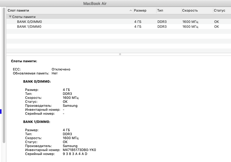

Slice Posted April 9, 2020 Share Posted April 9, 2020 I am also exploring this bug See PartNumber and SerialNumber of two DIMMs. They are were similar with old Clover. And the SerialNumber have to be char8 as in debug.log 0:100 0:000 Type 16 Index = 0 0:100 0:000 Total Memory Slots Count = 2 0:100 0:000 Type 17 Index = 0 0:100 0:000 SmbiosTable.Type17->Speed = 1600MHz 0:100 0:000 SmbiosTable.Type17->Size = 4096MB 0:100 0:000 SmbiosTable.Type17->Bank/Device = DIMM A 0:100 0:000 SmbiosTable.Type17->Vendor = Samsung 0:100 0:000 SmbiosTable.Type17->SerialNumber = 0094EA68 0:100 0:000 SmbiosTable.Type17->PartNumber = M471B5273DH0-CK0 0:100 0:000 Type 17 Index = 1 0:100 0:000 SmbiosTable.Type17->Speed = 1600MHz 0:100 0:000 SmbiosTable.Type17->Size = 4096MB 0:100 0:000 SmbiosTable.Type17->Bank/Device = DIMM B 0:100 0:000 SmbiosTable.Type17->Vendor = Samsung 0:100 0:000 SmbiosTable.Type17->SerialNumber = 9383A4AD 0:100 0:000 SmbiosTable.Type17->PartNumber = M471B5173DB0-YK0 Link to comment https://www.insanelymac.com/forum/topic/341986-c-proposition/page/26/#findComment-2716401 Share on other sites More sharing options...
