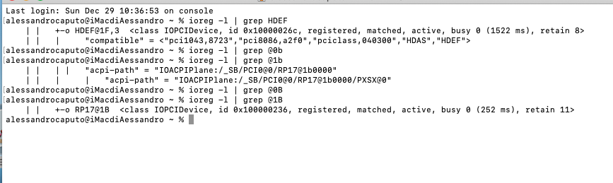

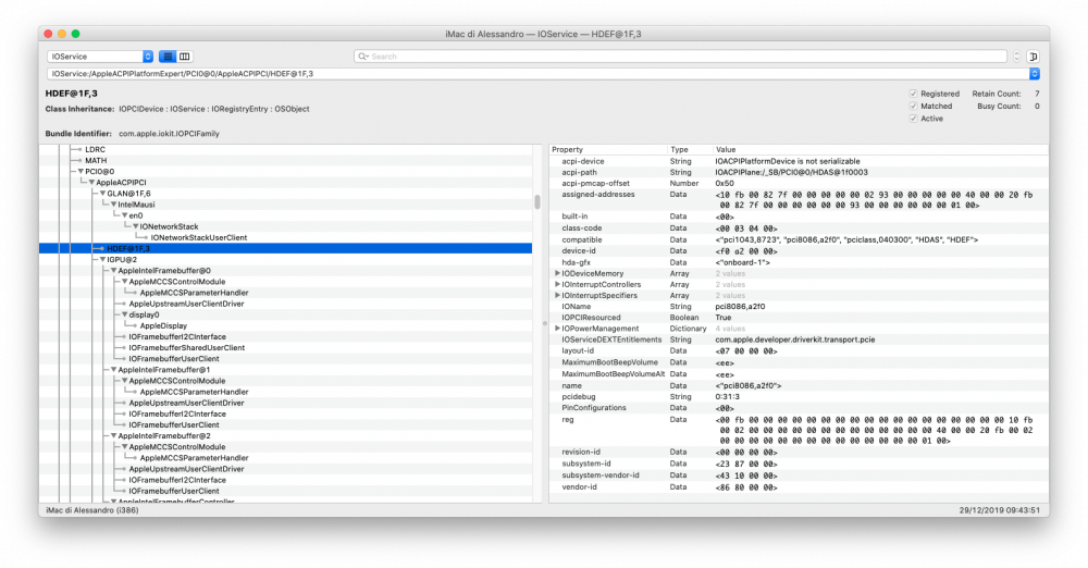

DarkAlex97 Posted December 29, 2019 Author Share Posted December 29, 2019 (edited) Where i can find the config file? Here's what i found about HDEF in the register and here's the output from the terminal I also attached the ioreg output iMac di Alessandro.ioreg As for the DSDTs i used mine without modification generated with SSDTTime And these two https://github.com/acidanthera/OpenCorePkg/blob/master/Docs/AcpiSamples/SSDT-PLUG.dsl https://github.com/acidanthera/OpenCorePkg/blob/master/Docs/AcpiSamples/SSDT-EC-USBX.dsl compiled with MaciASL Edited December 29, 2019 by DarkAlex97 Link to comment https://www.insanelymac.com/forum/topic/341944-audio-is-not-working-on-catalina-opencorevanilla/#findComment-2702118 Share on other sites More sharing options...
DarkAlex97 Posted December 29, 2019 Author Share Posted December 29, 2019 I got it! The config file on the USB, i tought i had to edit a file on the harddisk Anyway the correct address was 0x1f 0x3 Thanks Link to comment https://www.insanelymac.com/forum/topic/341944-audio-is-not-working-on-catalina-opencorevanilla/#findComment-2702123 Share on other sites More sharing options...
