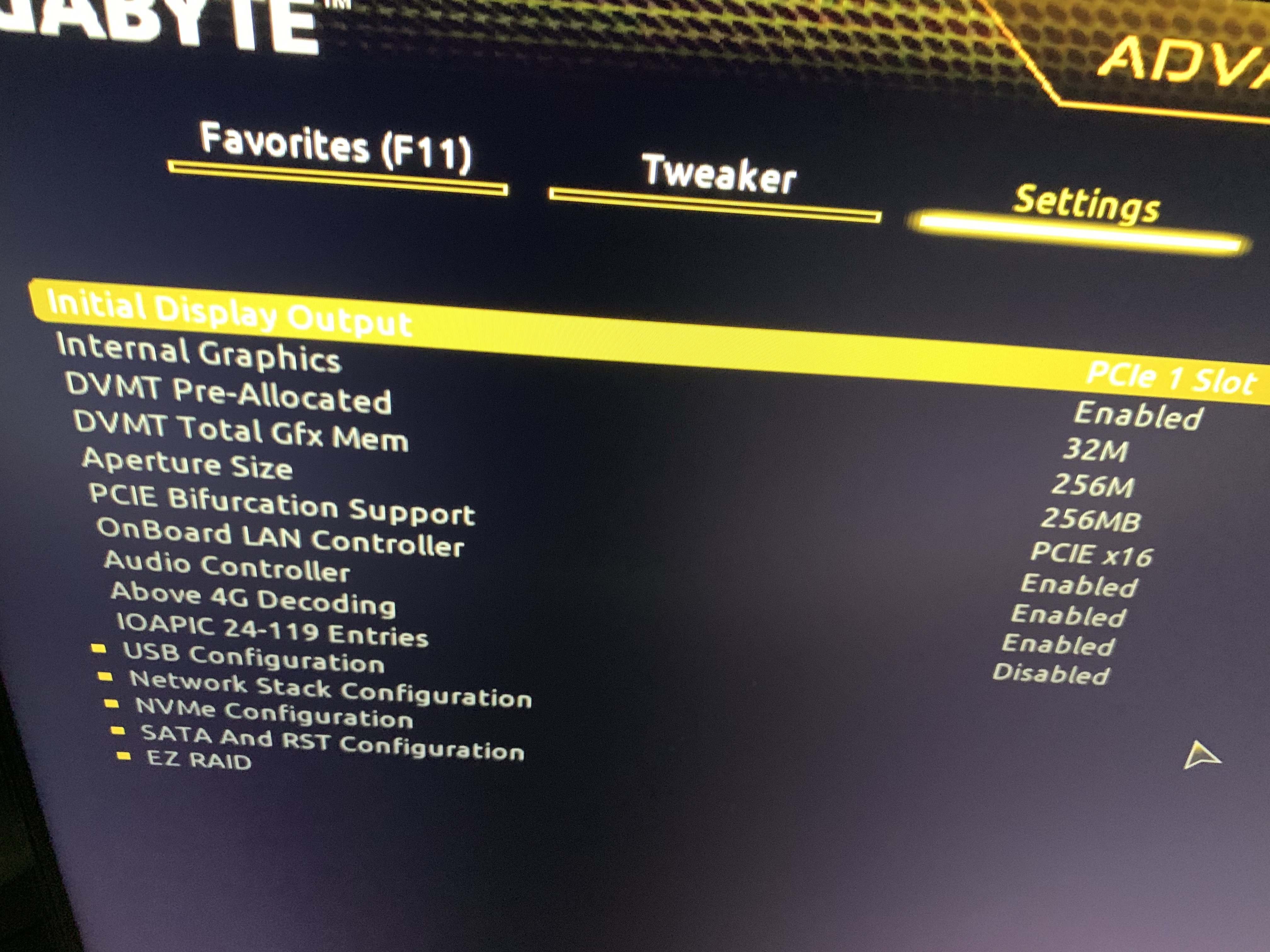

yooouuridafdssdfs Posted January 2, 2020 Share Posted January 2, 2020 (edited) Change DVMT Pre-allocated to 32M, Total Gfx Mem to something else (does not really matter). Also change slide=1 in your bootargs. Make sure your set ProvideCustomSlide to true, do the same for EnableSafeModeSlide. If you don't want the iGPU, just disable it and use slide=1. Have a Gigabyte Z390 UD, when I change the "DVMT Pre-allocated" to something else than 32M I get the "Could not allocate runtime" errors.. Don't use AptioMemoryFix, use FwRuntimeServices.efi instead. AptioMemoryFix is split into OpenCore and FwRuntimeServices.efi. Edited January 2, 2020 by yooouuridafdssdfs Link to comment Share on other sites More sharing options...
