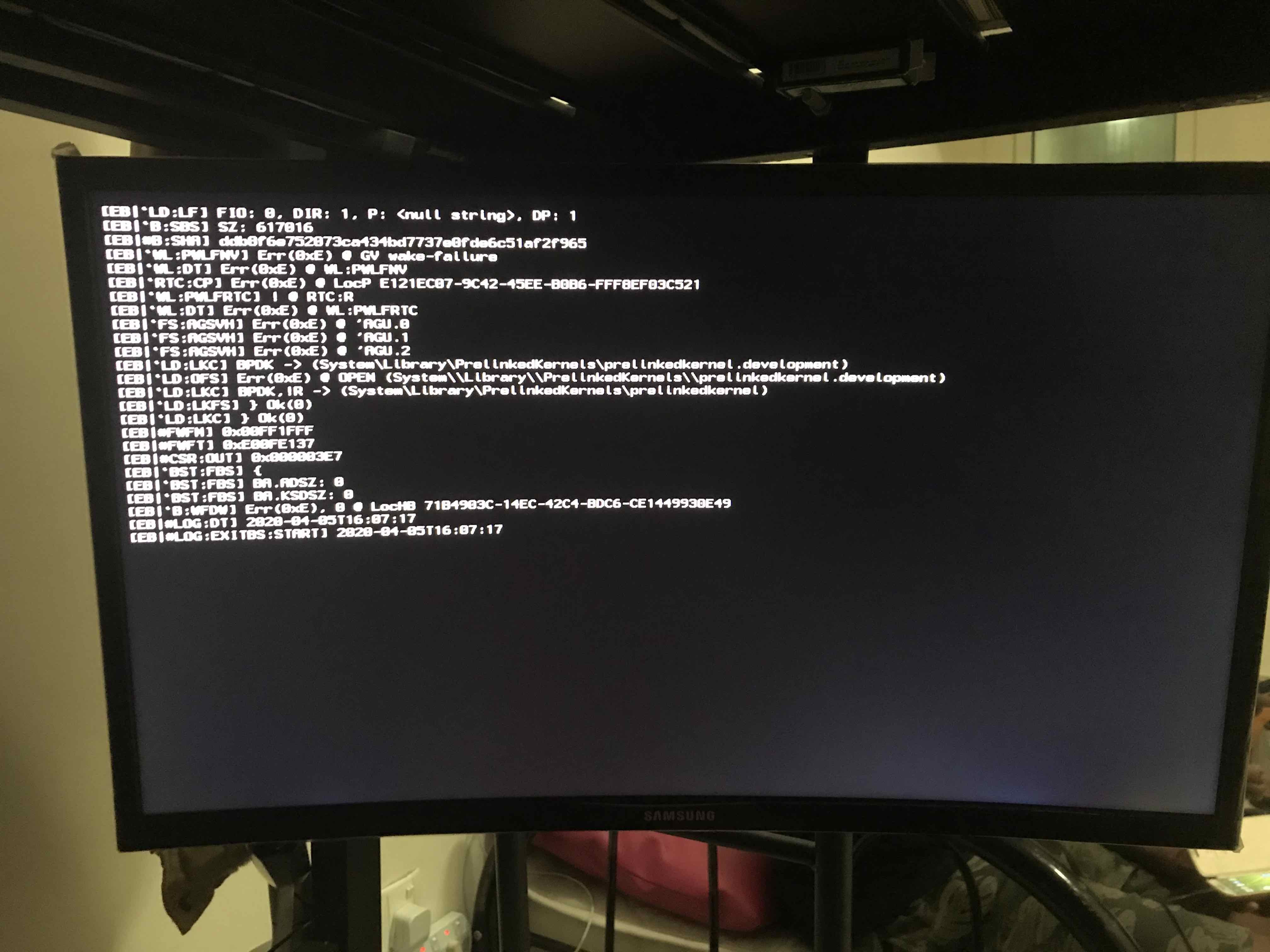

MacNB Posted April 5, 2020 Share Posted April 5, 2020 6 hours ago, Apple Hunter said: As you given i have already done i have updated to 0.5.7 with OpenRuntime.efi. no change same.. freeze on this error. opencore-2020-04-05-062046.txt You cannot use the config.plist from 0.5.6 with 0.5.7. Read the difference.pdf for the changes between the two versions. Suggest you stick with 0.5.6. Sorry but I am lost as to what is happening. Advise you post the above screenshot on the main Opencore Discussion topic and asks the devs as to what that screenshot is saying. Link to comment Share on other sites More sharing options...

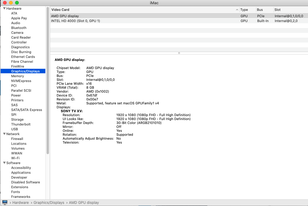

MacNB Posted April 8, 2020 Share Posted April 8, 2020 1 hour ago, pilo2300 said: Fixed it - I reversed the platform-id incorrectly (reversed the whole number, instead of reversing it in hex pairs). I should have been using 06006201 (which is 0x01620006) - this is for connector-less igpu. Hardware accelaration is now working. If you use Whatevergreen.kext, then you do not need to set any platform id's since it will do it for your based on your CPU type and also what external GPU you have. On my i7-3770K, when I enable the IGPU in BIOS, WEG.kext would set the platform id to 07006201. In fact, you do not have to set any device-properties for AMD GPU nor AMD HDMI Audio. Link to comment Share on other sites More sharing options...

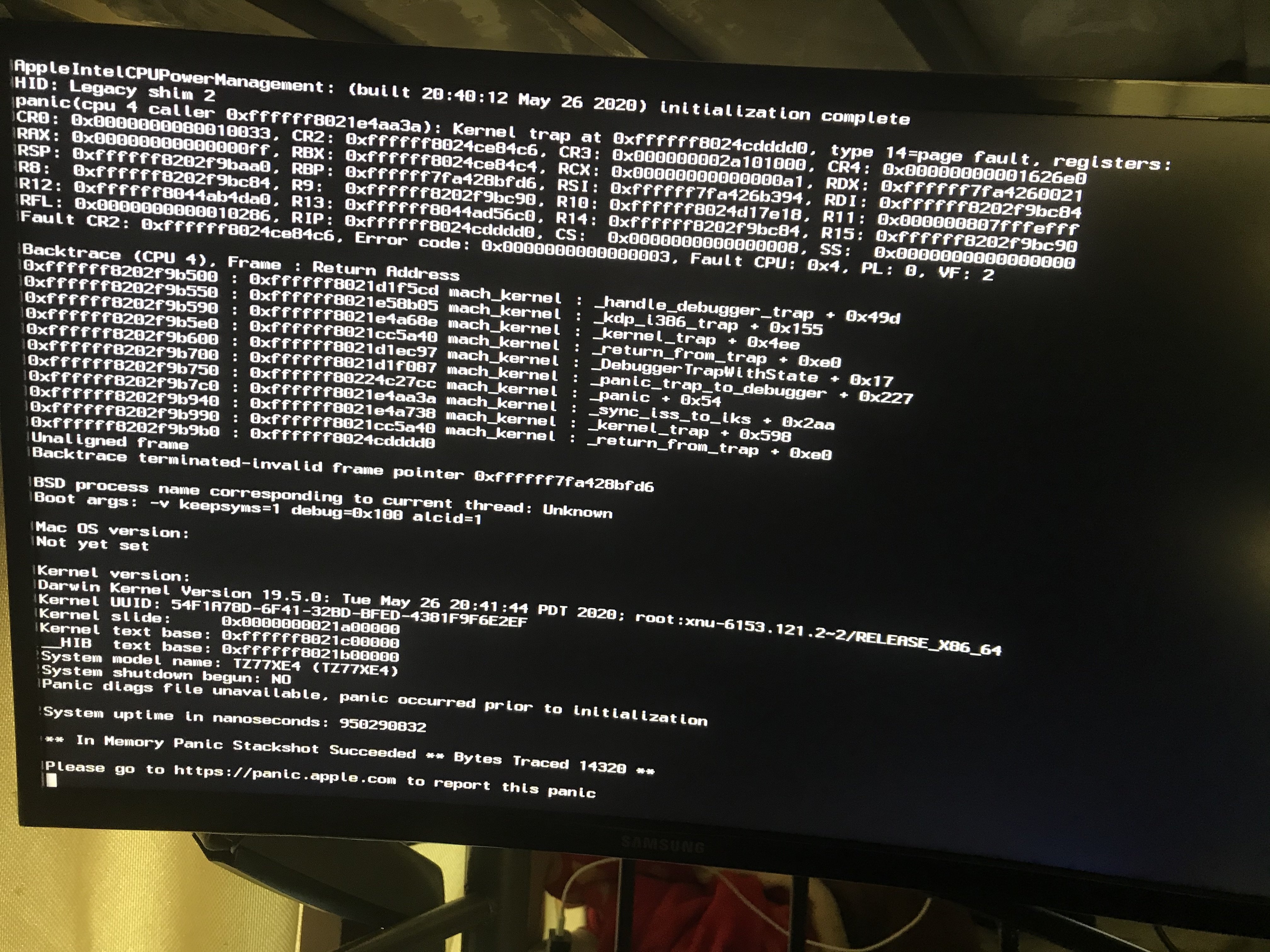

samlis Posted May 2, 2020 Share Posted May 2, 2020 hello,can help me ?i dont know,What's wrong with me。select booting mac and next reboot。opencore 0.5.7 i7-3770k z77x-Ud5h GTX660-ti this my efi flie,fist config opencore ,something understand EFI.rar Link to comment Share on other sites More sharing options...
MacNB Posted May 2, 2020 Share Posted May 2, 2020 1 hour ago, samlis said: hello,can help me ?i dont know,What's wrong with me。select booting mac and next reboot。opencore 0.5.7 i7-3770k z77x-Ud5h GTX660-ti this my efi flie,fist config opencore ,something understand EFI.rar I suggest you read through this guide thoroughly first. You have not said how you manage to build or install macOS in the first instance. You set your SMBIOS model to MacBookPro but you have a desktop. Try the attached config file with the SSDT-EC.aml (copy it to the EFI/OC/ACPI folder). samlis-config.plist SSDT-EC.aml Link to comment Share on other sites More sharing options...

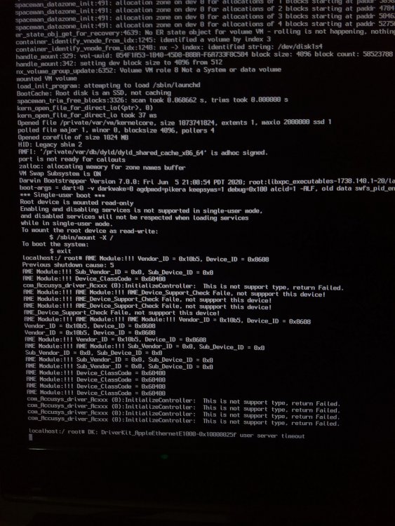

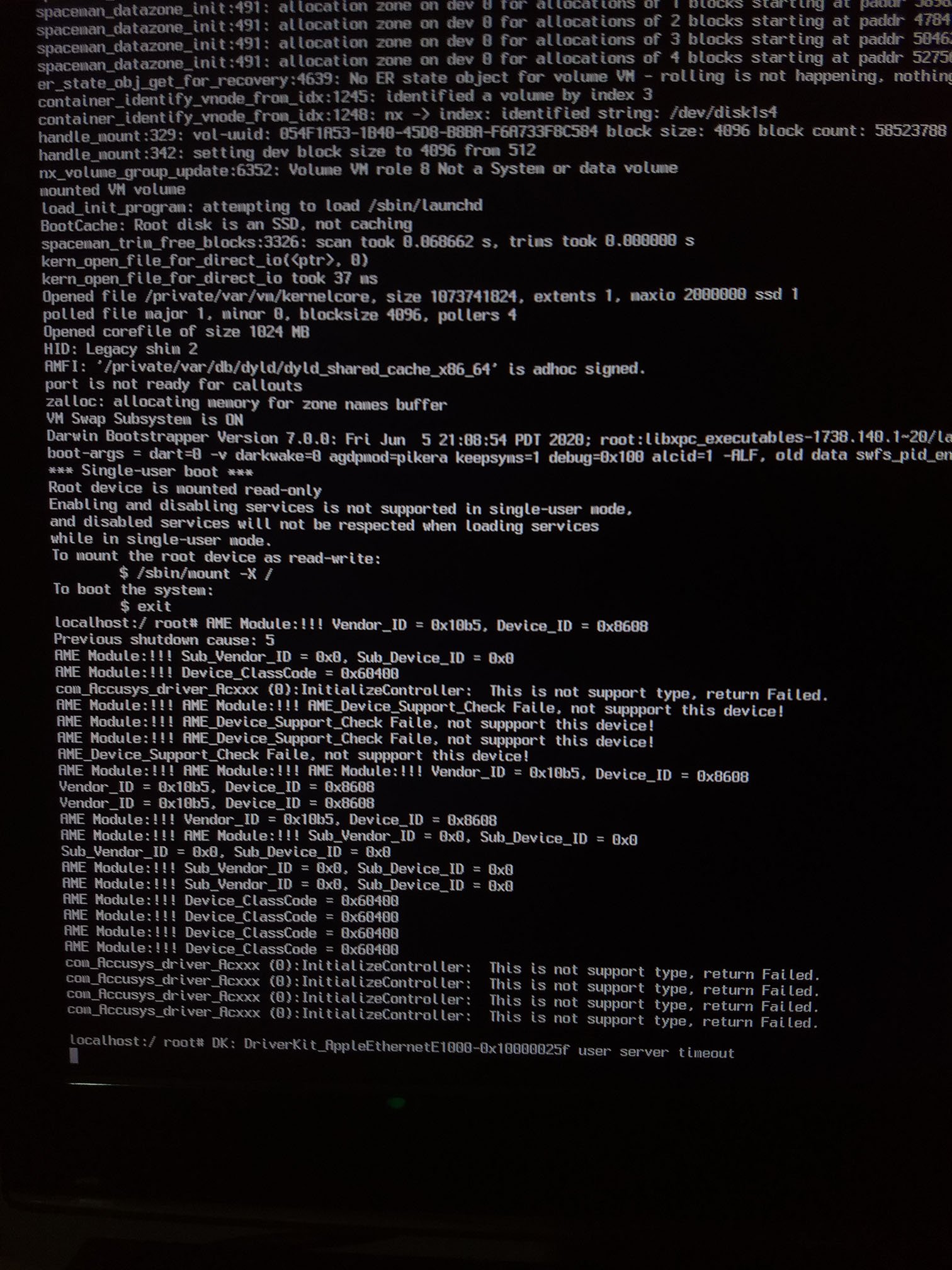

scanray Posted September 5, 2020 Share Posted September 5, 2020 Hi @jsl2000 I have the same pc, but the video is MSI RX5500XT. I am installing it on Catalina 15.6 The card works great on a GB Z390 UD, but on this one: KP. The strange thing is that it lets me install Catalina, I get to the desktop, I configure, reboot and .... KP Do you have any idea how to solve it? I read in the first post that the 580 gave you problems, maybe you can help me. Another thing, I can boot into Recovery and with -S thanks Link to comment Share on other sites More sharing options...
jsl2000 Posted September 5, 2020 Author Share Posted September 5, 2020 HI, @scanray AMD GPU need agdpmod=pikera in your boot-argument RX-580 only output from the second DP port (the top DP port was the first one) and RX-560 only output from HDMI port in my hackintosh. Your KP seems related to networking card instead of Display card. Using the latest kext for your networking card at first to debug. IntelE1000 not working any more in Catalina and Big Sur. Link to comment Share on other sites More sharing options...

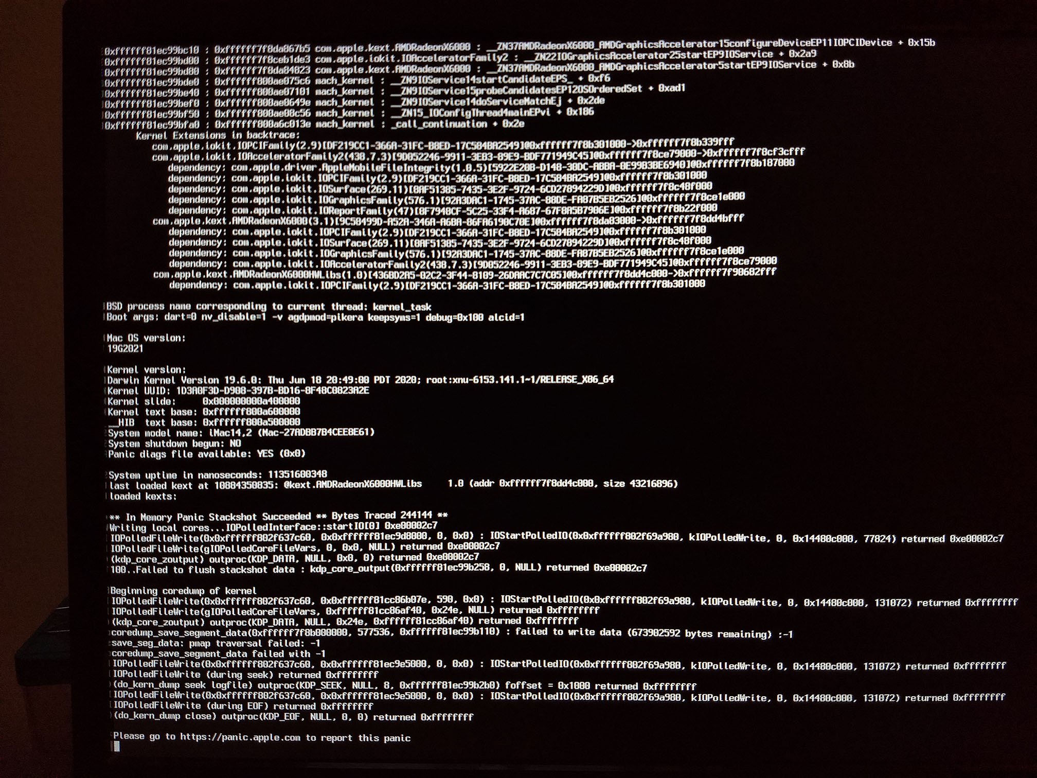

scanray Posted September 5, 2020 Share Posted September 5, 2020 (edited) Hi, @jsl2000 Im using agdpmod=pikera at boot. For network intelmausi. I have disabled all other device in bios. I have changed the video with old nvidia and nv_disable=1 at boot. I can boot. The KP is when I use the amd. What is strange is that the first boot works. Not later. Even without installing anything. I used a usb created with ##### and clover. I'm going to try creating one with OC only. The other thing I saw is that in the config.plist you put you use fakesms and not the opencore one. It's a mistake ? or if it works? thanks Edited September 5, 2020 by scanray error type Link to comment Share on other sites More sharing options...
jsl2000 Posted September 5, 2020 Author Share Posted September 5, 2020 HI, @scanray My current OC 0.6.1 config.plist for your reference and comparison. config.plist 1 Link to comment Share on other sites More sharing options...
scanray Posted September 6, 2020 Share Posted September 6, 2020 Hi, @jsl2000, Thanks for the config. I tried it last night. I searched for OC 0.6.1 but couldn't find it. There is only 0.6.0 In the same way I tried 0.6.0, I disabled everything that referred to BT, I did not find the kext, I imagine that I have to compile the sources, right? The USB works and runs the Catalina installer, but if I start Catalina, the KP panic again. In this clover config, catalina works. The only weird thing about it is that if I disable the trim the KP appears. I'm going to try activating the trim on the OC. Thanks for the help config_clover.plist Link to comment Share on other sites More sharing options...

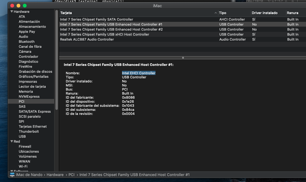

scanray Posted September 9, 2020 Share Posted September 9, 2020 Hi @jsl2000, Thanks for the config. The only way it worked was to activate the trim. If not: KP It is working very well now. A query, have you been successful configuring the USB asmedia? I have been the last 2 days trying to do a ssdt of the usb ports without good results. When I activate the patch from ehc1 to eh01 it works. If I turn ehc2 to eh02, none of the usb2 ports work. Thanks Link to comment Share on other sites More sharing options...
jsl2000 Posted September 9, 2020 Author Share Posted September 9, 2020 (edited) 2 hours ago, scanray said: Hi @jsl2000, Thanks for the config. The only way it worked was to activate the trim. If not: KP It is working very well now. A query, have you been successful configuring the USB asmedia? I have been the last 2 days trying to do a ssdt of the usb ports without good results. When I activate the patch from ehc1 to eh01 it works. If I turn ehc2 to eh02, none of the usb2 ports work. Thanks My advice is to use USBPorts.kext created by Hackintool which got least trouble on the long way. Asmedia USB was NOT supported in Mac OS X and should be disabled at BIOS. OpenCore 0.6.1 has been released. Try Google to get it ASAP ! Edited September 9, 2020 by jsl2000 Link to comment Share on other sites More sharing options...
scanray Posted September 9, 2020 Share Posted September 9, 2020 (edited) Hi @jsl2000, 11 hours ago, jsl2000 said: My advice is to use USBPorts.kext created by Hackintool which got least trouble on the long way. Asmedia USB was NOT supported in Mac OS X and should be disabled at BIOS. Yes, I already did these 2 methods 11 hours ago, jsl2000 said: OpenCore 0.6.1 has been released. When I put the previous post I had already installed V6.1 My question was only to be sure that the USB3 asmedia did not work I will continue to review the configuration and if I have any questions or problems, I will ask here again. Thank you very much for your time and help. Edited September 9, 2020 by scanray Link to comment Share on other sites More sharing options...
