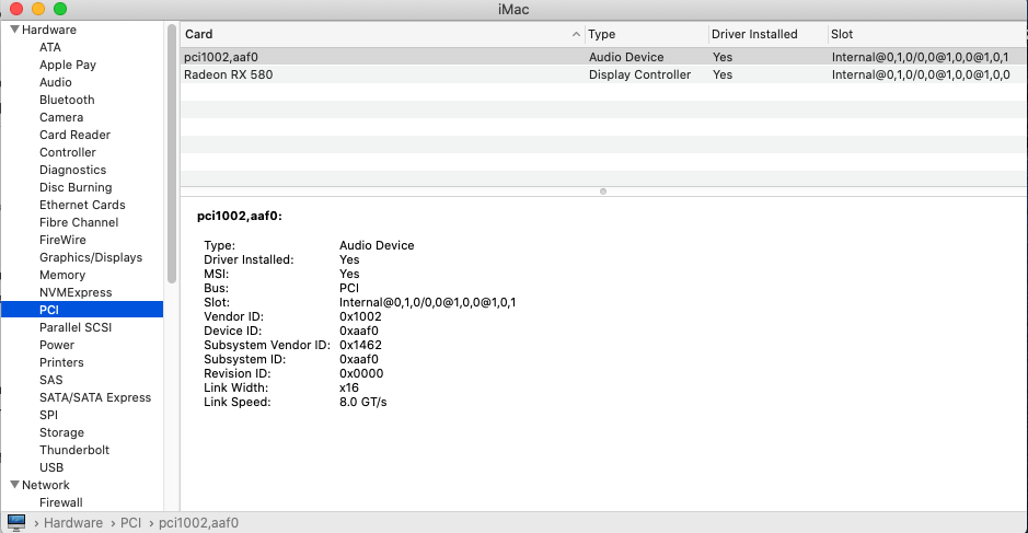

jsl2000 Posted November 23, 2019 Share Posted November 23, 2019 (edited) After many hours of try and error it worked by OpenCore at 10.12.6/10.13.6/10.14.x/10.15x in my Z77 hackintosh. The only issue was incorrect showing of PCI in System Information. config.plist Edited November 24, 2019 by jsl2000 3 1 Link to comment https://www.insanelymac.com/forum/topic/341337-working-opencore-in-z77-hackintosh/ Share on other sites More sharing options...
jsl2000 Posted November 25, 2019 Author Share Posted November 25, 2019 On 11/23/2019 at 10:08 PM, jsl2000 said: After many hours of try and error it worked by OpenCore at 10.12.6/10.13.6/10.14.x/10.15x in my Z77 hackintosh. The only issue was incorrect showing of PCI in System Information. config.plist I had fixed this issue by the new config.plist. config.plist Link to comment https://www.insanelymac.com/forum/topic/341337-working-opencore-in-z77-hackintosh/#findComment-2698614 Share on other sites More sharing options...

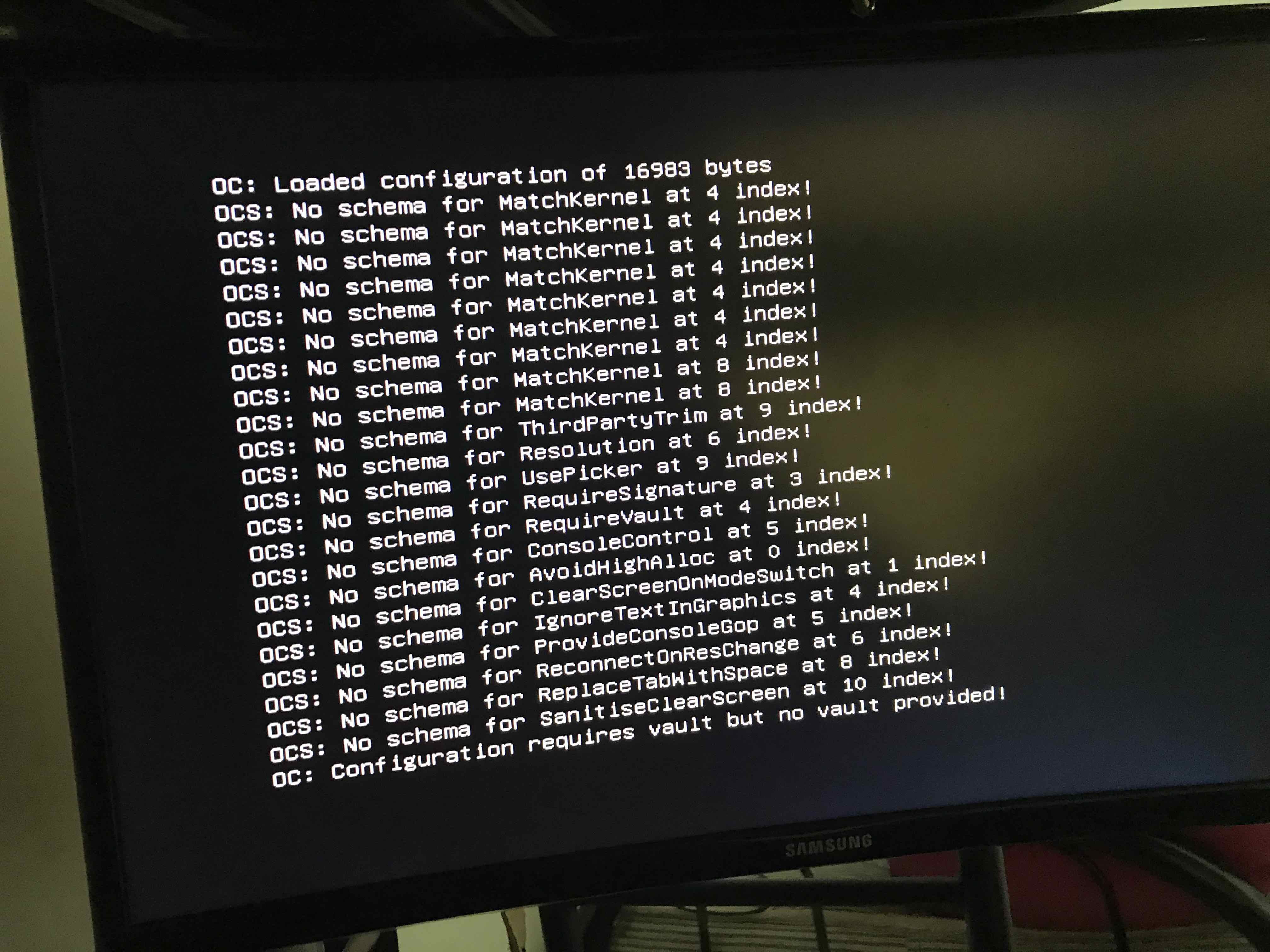

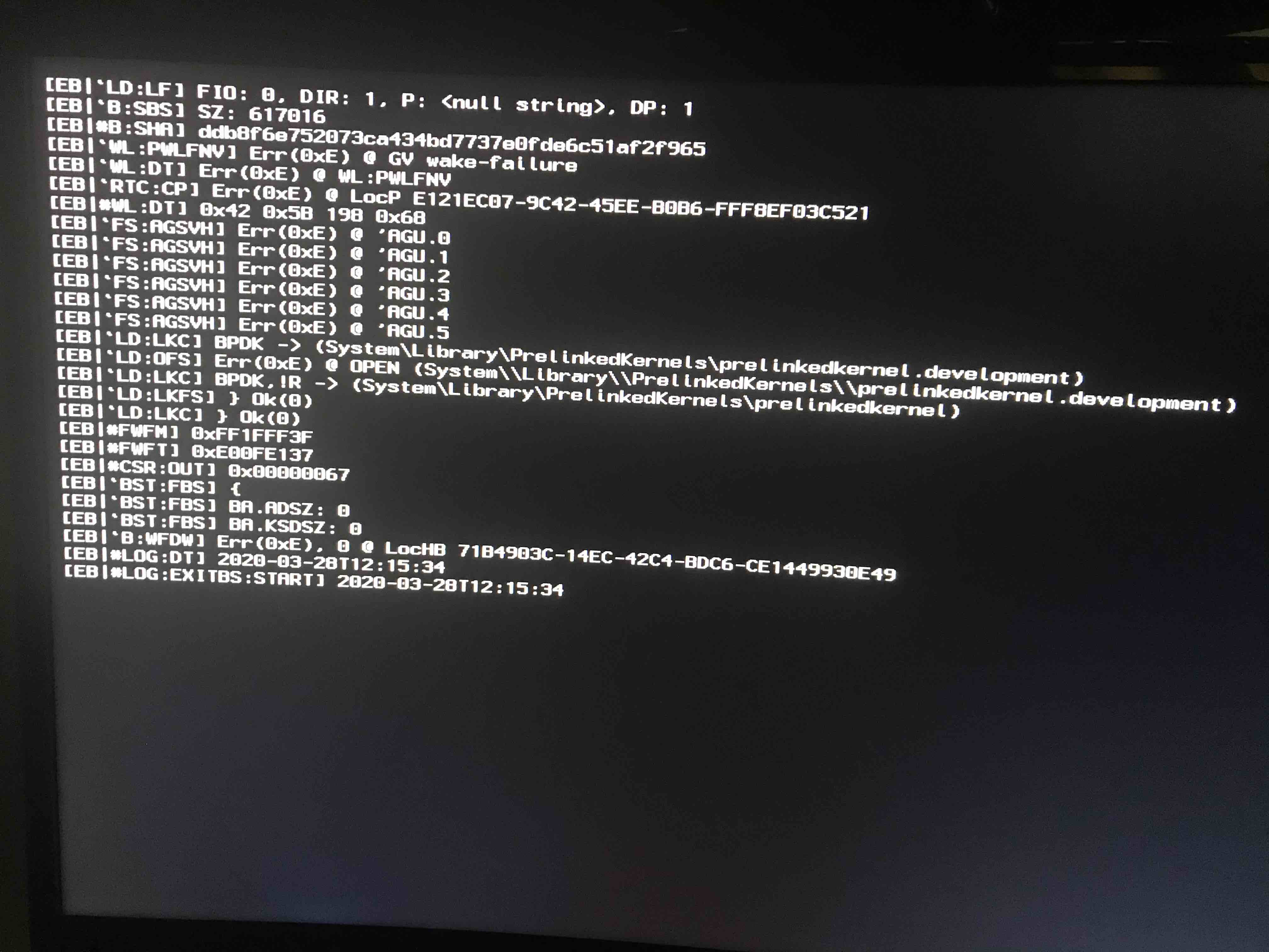

Apple Hunter Posted March 28, 2020 Share Posted March 28, 2020 (edited) 1st of all thank you for help. I have mounted EFI which you have edited and I have followed your step as you comments. But still it showing me some error like i mention in picture even opencore log report freeze. I have created DSDT now its working fine in Clover same method I have applied to Opencore but same issues. I have 1 more doubt on FwRuntimeServices.efi. I have added FwRuntimeServices.efi to clover it freeze at same loading. but AptioMemoryFix.efi works fine in Clover. I have try to add Opencore it showed nonsupporting error on startup. I have attached DSDT Working Clover And Issus Opencore. Clover.zip open.zip opencore-2020-03-28-131318.txt Edited March 28, 2020 by Apple Hunter Link to comment https://www.insanelymac.com/forum/topic/341337-working-opencore-in-z77-hackintosh/#findComment-2714266 Share on other sites More sharing options...
MacNB Posted March 30, 2020 Share Posted March 30, 2020 On 3/28/2020 at 2:04 PM, Apple Hunter said: 1st of all thank you for help. I have mounted EFI which you have edited and I have followed your step as you comments. But still it showing me some error like i mention in picture even opencore log report freeze. I have created DSDT now its working fine in Clover same method I have applied to Opencore but same issues. I have 1 more doubt on FwRuntimeServices.efi. I have added FwRuntimeServices.efi to clover it freeze at same loading. but AptioMemoryFix.efi works fine in Clover. I have try to add Opencore it showed nonsupporting error on startup. I have attached DSDT Working Clover And Issus Opencore. Clover.zip open.zip opencore-2020-03-28-131318.txt The first screenshot is normal - except the line about ConsoleControl. It's not important but just delete the ConsoleControl entry in your config.plist. The second screenshot I do not recognise. I do not see it and don't recognise anything. You say that you have created a DSDT.aml but in the folder "with DSDT", the config.plist does not use it (you have not added it as an entry in ACPI->Add) so it is not being used. You also should not need it or any of those patches that you added. It may well be an issue to FwRuntimeservice.efi on your motherboard. In config.plist try setting: ACPI->Quirks->NormalizeHeaders=true and ACPI->Quirks->RebaseRegions=true (with any DSDT.aml) Also, you have not stated where your monitor is connected (motherboard or the AMD graphics card). It should be connected to the AMD GPU. If not, did you check that if you have any output on any of the AMD ports and the system is not really frozen ? Link to comment https://www.insanelymac.com/forum/topic/341337-working-opencore-in-z77-hackintosh/#findComment-2714639 Share on other sites More sharing options...

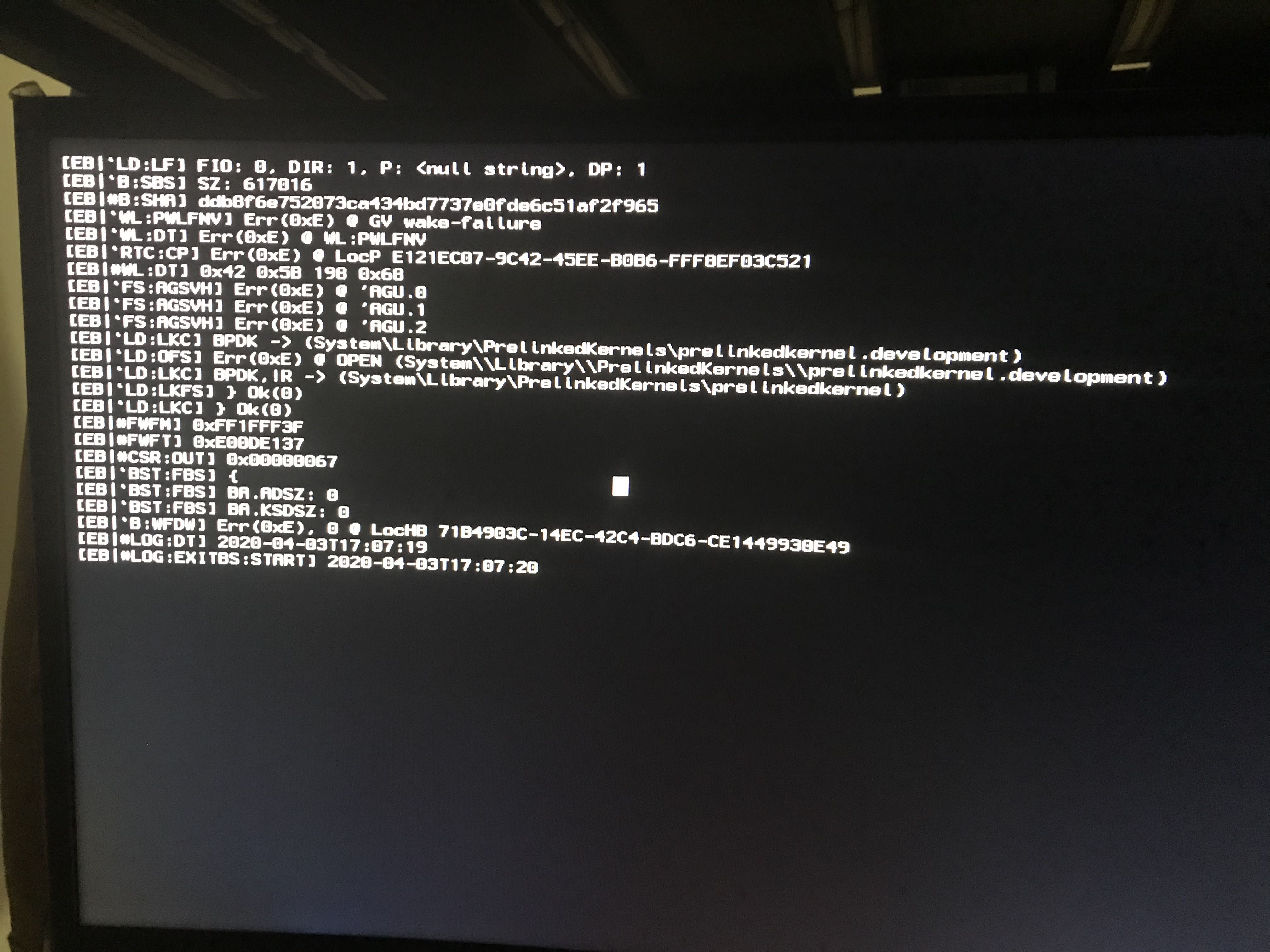

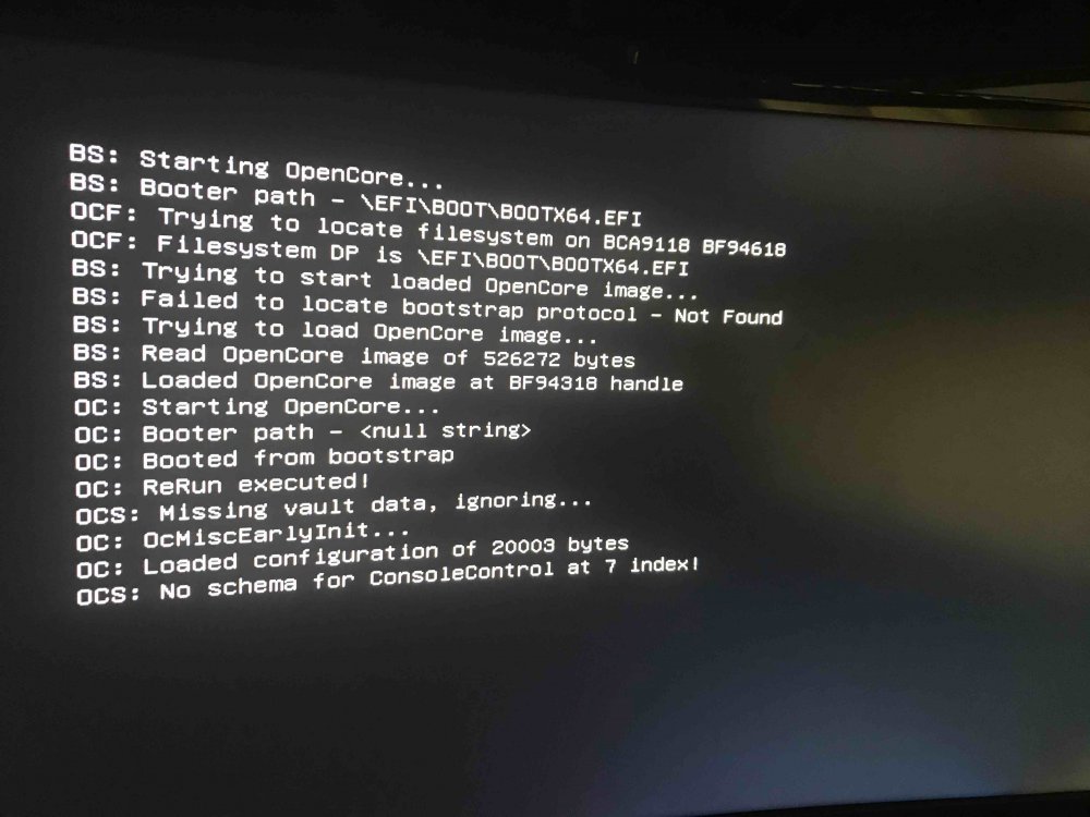

Apple Hunter Posted April 1, 2020 Share Posted April 1, 2020 I have Added FwRuntimeServices.efi to Clover. boot error is show like this. may be FwRuntimeServices.efi file need to update. IMG_5929.mp4 Link to comment https://www.insanelymac.com/forum/topic/341337-working-opencore-in-z77-hackintosh/#findComment-2714989 Share on other sites More sharing options...
MacNB Posted April 1, 2020 Share Posted April 1, 2020 4 hours ago, Apple Hunter said: My onboard iGPU is enabled. should i disable that. So your is connected to AMD GPU all the time ?? You can try and disable your iGPU (in BIOS) but I think it will not make a big difference on your system. I disable it because I use iMacPro1,1 as the SMBIOS model ID (not iMac13,2) so that I can use the AMD GPU for encoding/decoding video. I would not use Fwruntimeservices.efi with clover. There some problems with it but that's for the newer Z370 & 390 motherboards. If your system boots with Clover, post your IOREG file. Link to comment https://www.insanelymac.com/forum/topic/341337-working-opencore-in-z77-hackintosh/#findComment-2715011 Share on other sites More sharing options...

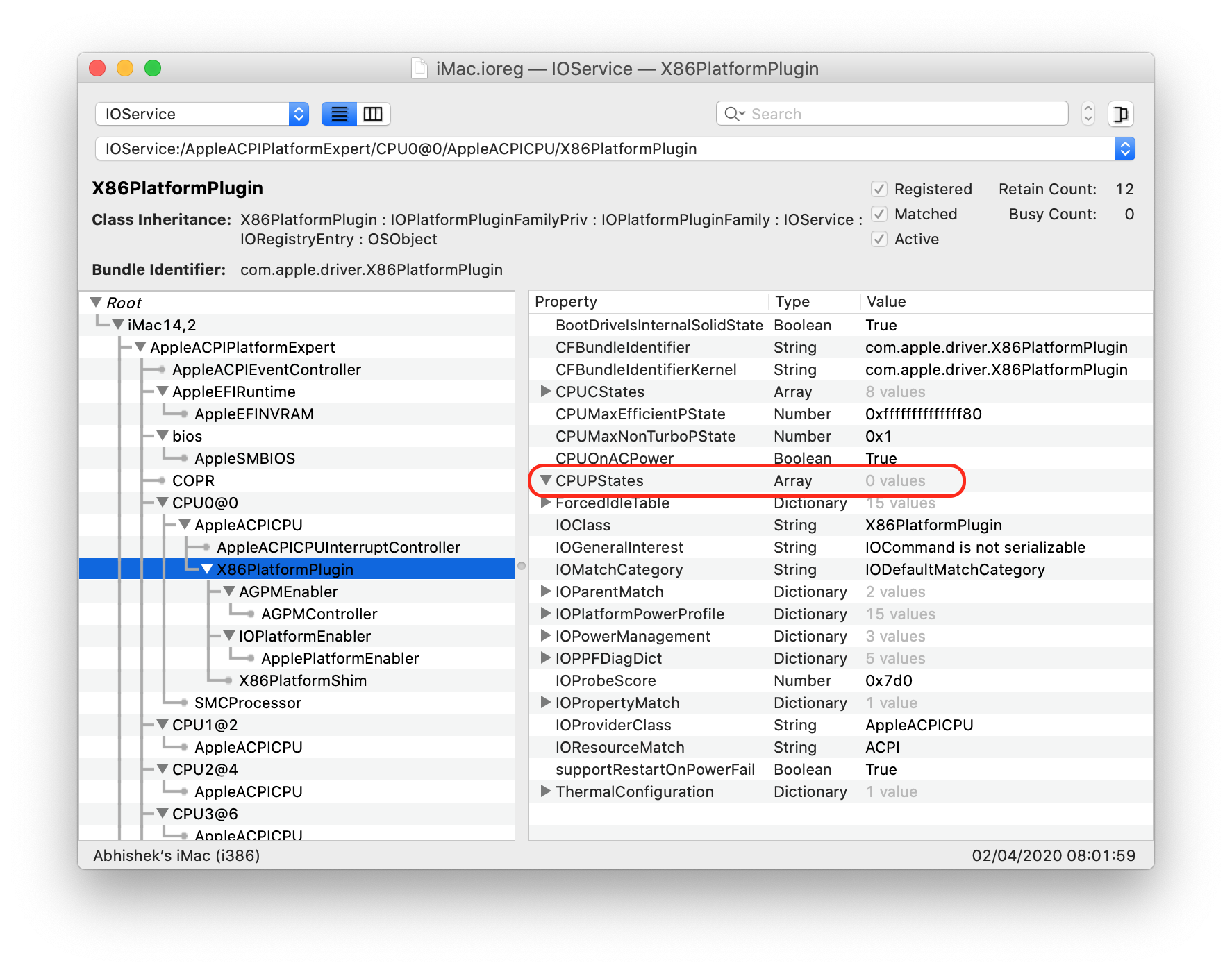

MacNB Posted April 2, 2020 Share Posted April 2, 2020 8 hours ago, Apple Hunter said: My IOREG FILE.. iMac.ioreg Your IOREG shows that the IGPU is in headless mode which should be the same when booting with OC (as long as Whatevergreen.kext is used). Did you do this following as I had suggested ??? : ACPI->Quirks->NormalizeHeaders=true and ACPI->Quirks->RebaseRegions=true BTW, your IOREG shows that you do not have proper CPU power management. That is, your SSDT.aml is not being used as you have know P-States: Link to comment https://www.insanelymac.com/forum/topic/341337-working-opencore-in-z77-hackintosh/#findComment-2715112 Share on other sites More sharing options...
Apple Hunter Posted April 5, 2020 Share Posted April 5, 2020 On 4/2/2020 at 8:09 PM, MacNB said: Your IOREG shows that the IGPU is in headless mode which should be the same when booting with OC (as long as Whatevergreen.kext is used). Did you do this following as I had suggested ??? : ACPI->Quirks->NormalizeHeaders=true and ACPI->Quirks->RebaseRegions=true BTW, your IOREG shows that you do not have proper CPU power management. That is, your SSDT.aml is not being used as you have know P-States: i have not added ssdt in shortlist now i checked its showing. iMac.ioreg Link to comment https://www.insanelymac.com/forum/topic/341337-working-opencore-in-z77-hackintosh/#findComment-2715472 Share on other sites More sharing options...

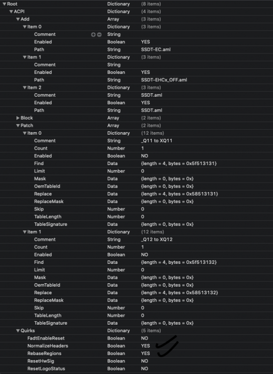

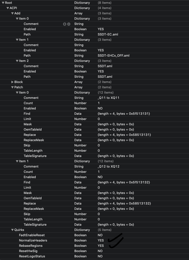

MacNB Posted April 5, 2020 Share Posted April 5, 2020 6 hours ago, Apple Hunter said: i have not added ssdt in shortlist now i checked its showing. iMac.ioreg You do not seem to follow any suggestions Did you do this following as I had suggested ??? : ACPI->Quirks->NormalizeHeaders=true and ACPI->Quirks->RebaseRegions=true Link to comment https://www.insanelymac.com/forum/topic/341337-working-opencore-in-z77-hackintosh/#findComment-2715515 Share on other sites More sharing options...
Apple Hunter Posted April 5, 2020 Share Posted April 5, 2020 (edited) As you given i have already done e Still same Result i have updated to 0.5.7 with OpenRuntime.efi. no change same.. freeze on this error. opencore-2020-04-05-062046.txt Edited April 5, 2020 by Apple Hunter Link to comment https://www.insanelymac.com/forum/topic/341337-working-opencore-in-z77-hackintosh/#findComment-2715554 Share on other sites More sharing options...
