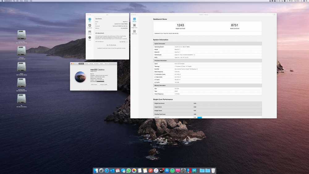

Bios-PC Posted November 12, 2019 Share Posted November 12, 2019 hello Everybody I use Hackintosh many years , I enjoy building system that work smooth and stable with this config , all the time I have freezing system once a day or once in 3 days its random no solution found to fix the problem , start to check for hardware failure but that was not the problem and after many hours spending to fix the problem , i start everything from scratch step by step from bios config to post install remove all DSDT and Clean Clover , For 2 Days it works stable and also Apple TV+ start working Also Geekbeench Score better than iMac 19,1 no need to inject intel hd connector just full graphic and GVA working I will upload later full instruction of install , and post install for now one problem with smbios Mac Pro 7.1 , After login system alert say the misconfigured memory still working on it best regards Link to comment https://www.insanelymac.com/forum/topic/341128-success-mac-pro-71-i9-9900k-aorus-extrem-z390-rx580/ Share on other sites More sharing options...

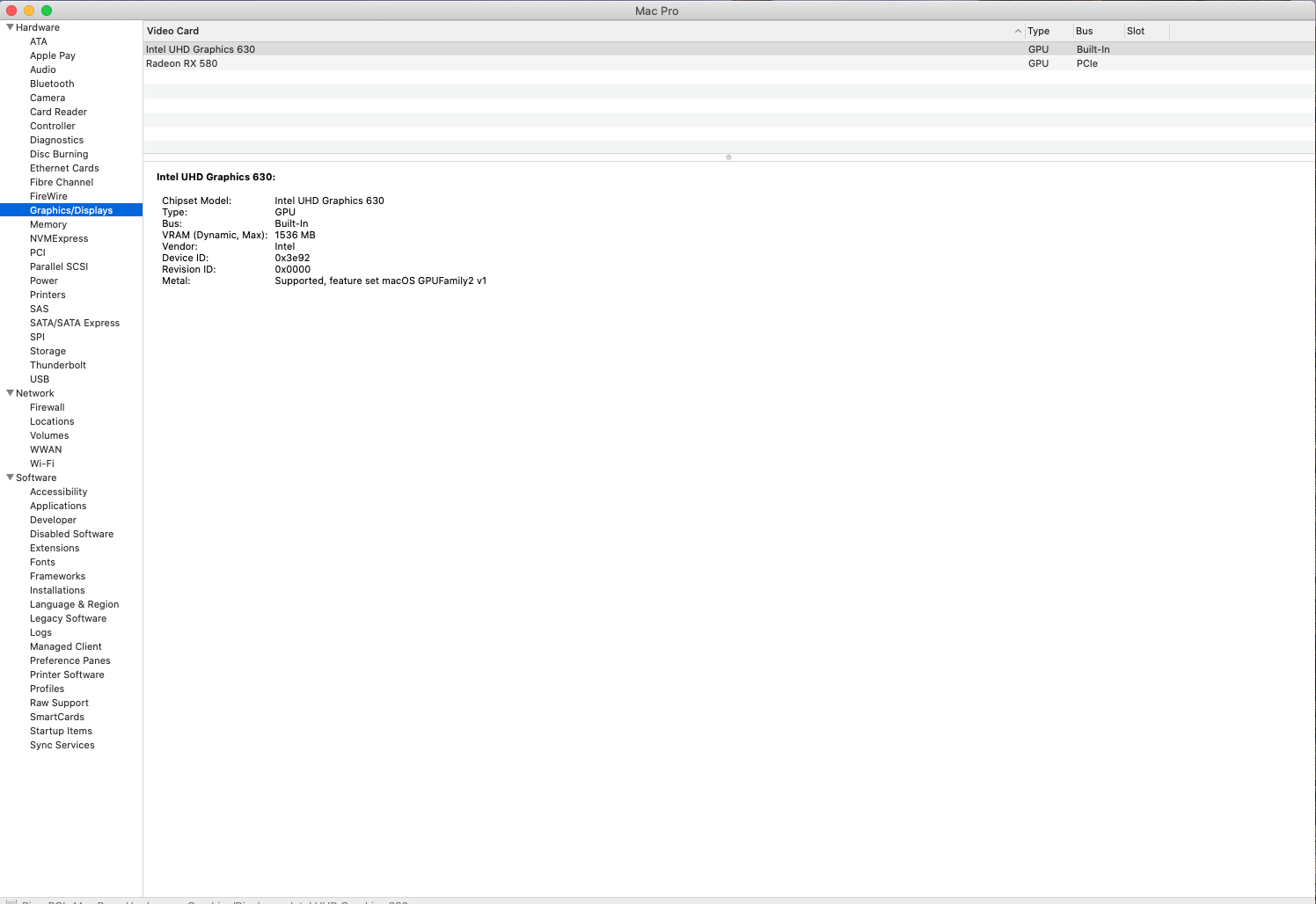

Bios-PC Posted November 26, 2019 Author Share Posted November 26, 2019 (edited) Hello [Success] Catalina 10.15.2 Gigabyte Z390 Aorus Extreme, i9 9900K and Asus Strix Rog RX580 Hardware: Processor : Intel Core i9-9900K Motherboard : Gigabyte Z390 Aorus Extrem Rev 1 RAM : 32GB DDR4 PC3000 GPU : Radeon RX580 8GB Asus Strix Rog IGPU : Intel UHD630 graphics 630 Storage : Samsung Evo960 NVME 256GB Ethernet : Intel I219V Ethernet Gigabit Port Aquantia AQC107 10Gbit Wifi : Broadcom BCM43xx 1.0 USB : Intel Chipset Audio Codec : ALC1200 Display Size : Philips Ultraclear Brilliance 28 inch Monitor Resolution : Full HD 3840 x 2160 Boot Mode : UEFI SMBIOS : Mac Pro 7.1 everything is working , smbios 7.1 solve freezing issue with rx580 . also Apple TV+ work without any problem with DRM not work: trim for SATA not work but for NVME is working restart some time not woking , still working on it memory error , but the system is stable and show the correct memory. EFI.zip Edited November 26, 2019 by Bios-PC Link to comment https://www.insanelymac.com/forum/topic/341128-success-mac-pro-71-i9-9900k-aorus-extrem-z390-rx580/#findComment-2698723 Share on other sites More sharing options...

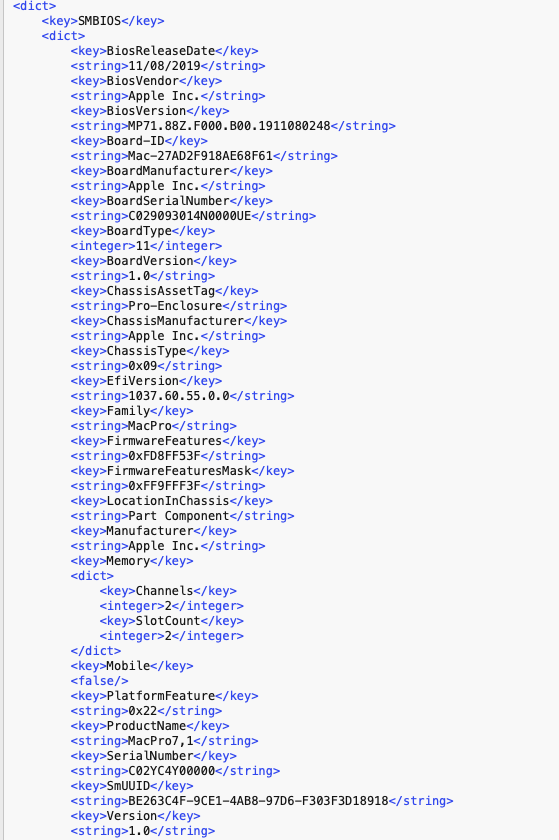

Matgen84 Posted November 30, 2019 Share Posted November 30, 2019 (edited) 2 hours ago, Bios-PC said: help with DSDT and memory issue? For DSDT, you've got this topic to request a DSDT Few week ago, I read some post for your memory issue but I don't remember where in this forum. Take a look in your config.plist, specially <key>Memory</key> (SMBIOS section) maybe For example, below Edited November 30, 2019 by Matgen84 Link to comment https://www.insanelymac.com/forum/topic/341128-success-mac-pro-71-i9-9900k-aorus-extrem-z390-rx580/#findComment-2699202 Share on other sites More sharing options...
Bios-PC Posted November 30, 2019 Author Share Posted November 30, 2019 I did read this post about memory and tried a lot of config on clover but still the same problem. Link to comment https://www.insanelymac.com/forum/topic/341128-success-mac-pro-71-i9-9900k-aorus-extrem-z390-rx580/#findComment-2699212 Share on other sites More sharing options...
#McFly Posted June 25, 2020 Share Posted June 25, 2020 Hi guys, for fix this, try to use this kext on EFI -> Clover -> Kexts -> otherMac Pro Memory Notification Disabler (github) Go to release and download the last kext. Link to comment https://www.insanelymac.com/forum/topic/341128-success-mac-pro-71-i9-9900k-aorus-extrem-z390-rx580/#findComment-2726916 Share on other sites More sharing options...
