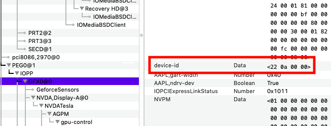

iCanaro Posted November 15, 2019 Share Posted November 15, 2019 @foskvs dove hai guardato in ioreg per capire che lui ha ---> 0x10de0a22 (GT216) Link to comment https://www.insanelymac.com/forum/topic/340903-problema-scheda-video-geforce-310/#findComment-2697487 Share on other sites More sharing options...
foskvs Posted November 15, 2019 Share Posted November 15, 2019 1 hour ago, iCanaro said: @foskvs dove hai guardato in ioreg per capire che lui ha ---> 0x10de0a22 (GT216) 1 Link to comment https://www.insanelymac.com/forum/topic/340903-problema-scheda-video-geforce-310/#findComment-2697508 Share on other sites More sharing options...
iCanaro Posted November 15, 2019 Share Posted November 15, 2019 OK @foskvs ma che conversione si fa? da ---> a Link to comment https://www.insanelymac.com/forum/topic/340903-problema-scheda-video-geforce-310/#findComment-2697522 Share on other sites More sharing options...
foskvs Posted November 15, 2019 Share Posted November 15, 2019 Ho messo insieme id produttore e id dispositivo. 10de = Nvidia, 0a22 è il suo modello di 315. Link to comment https://www.insanelymac.com/forum/topic/340903-problema-scheda-video-geforce-310/#findComment-2697527 Share on other sites More sharing options...
