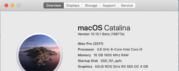

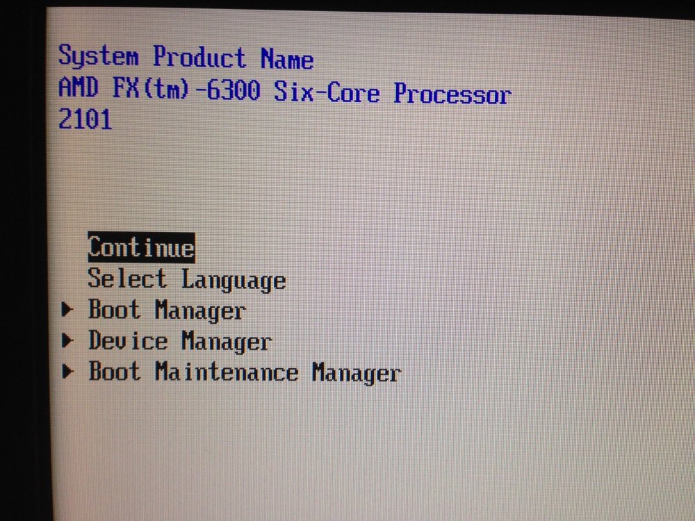

jsl2000 Posted October 19, 2019 Share Posted October 19, 2019 (edited) Clover boot of FX-6300 hackintosh at 10.13.6, 10.14.6, & 10.15.0 all working, but try to boot by Legacy OpenCore got booting error immediately. [Solved] It's only booted by SSD/HDD and can not boot by USB-Flash. Edited October 28, 2019 by jsl2000 Link to comment Share on other sites More sharing options...
Slice Posted October 19, 2019 Share Posted October 19, 2019 What is the boot file? It is compiled specially for OC or just copy from Clover? Link to comment Share on other sites More sharing options...
jsl2000 Posted October 19, 2019 Author Share Posted October 19, 2019 (edited) On 10/20/2019 at 3:16 AM, Slice said: What is the boot file? It is compiled specially for OC or just copy from Clover? It was built by boot install.command advised by OC guide: https://khronokernel-2.gitbook.io/opencore-vanilla-desktop-guide/extras/legacy No any error during its execution of this terminal command. Could it be only applicable to HDD/SSD only ? I'm applied this in an USB. [ALL SOLVED] 1. It actually applied to HDD/SSD only, invalid for USB. 2. Unable to reboot Thanks for Heckintosh Slav's advice which solved this reboot issue . 3. Poor audio quality from HDMI of RX-560 Following Shaneee's advice I can get correct CPU frequency now. Please check my config.plist for those who need Legacy Boot of FX-6300 or FX-8xxx hackintoshs. [Edit] New OpenCore 0.5.8 config.plist config.plist Edited May 18, 2020 by jsl2000 Link to comment Share on other sites More sharing options...

jsl2000 Posted April 29, 2020 Author Share Posted April 29, 2020 (edited) On 4/29/2020 at 10:13 AM, 08impreza said: Same thing happened to me. Hoping OP replies At post#1 here I have said that [Solved] It's only booted by SSD/HDD and can not boot by USB-Flash. All my legacy OpenCore worked by HDD or SSD only without exception in my 5 hackintoshs: P6TSE, P5Q PRO, GA-965P, Asus M3N, and M5A (FX-6300). USB Flash or external HDD only worked by UEFI OpenCore booting ! [Edit] My mistake ! Need edit BIOS for USB Legacy from AUTO to Enabled, then it can boot by USB Flash now. Edited May 12, 2020 by jsl2000 Link to comment Share on other sites More sharing options...

jsl2000 Posted May 10, 2020 Author Share Posted May 10, 2020 (edited) On 5/7/2020 at 4:58 PM, alfonsohuang said: USB can not use for boot this is totally wrong I use a SD card 512 MB, or usb drive 256MB, both can boot Catalina with legacy bios. My mistake. I have to edit my BIOS to set USB Legacy Enabled instead of AUTO. Then it can be booted by USB Flash now. Attached new config.plist for M5A FX-6300 hackintosh booted by OpenCore 0.5.8 successfully ! config.plist SSDT-EC-AMD.aml SSDT-ZPTS.aml Edited May 18, 2020 by jsl2000 Link to comment Share on other sites More sharing options...
sam298 Posted May 20, 2020 Share Posted May 20, 2020 I am stuck as well. Tried bootinstall in opencore, recognizes usb as boot drive but goes to blank screen with cursor and stops Tried clover legacy boot file with opencore efi folder, boots with clover but goes to white bios screen shown in OP Tried uefi and non-uefi options in bios. Clover legacy usb boots fine but can't boot OC from usb. Tried different config plist as well. Different usb sticks, different ports, same result. I am using 0.5.8. May be try older versions? Link to comment Share on other sites More sharing options...
