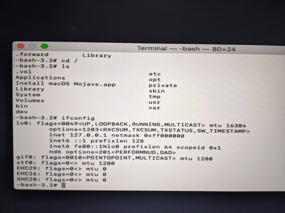

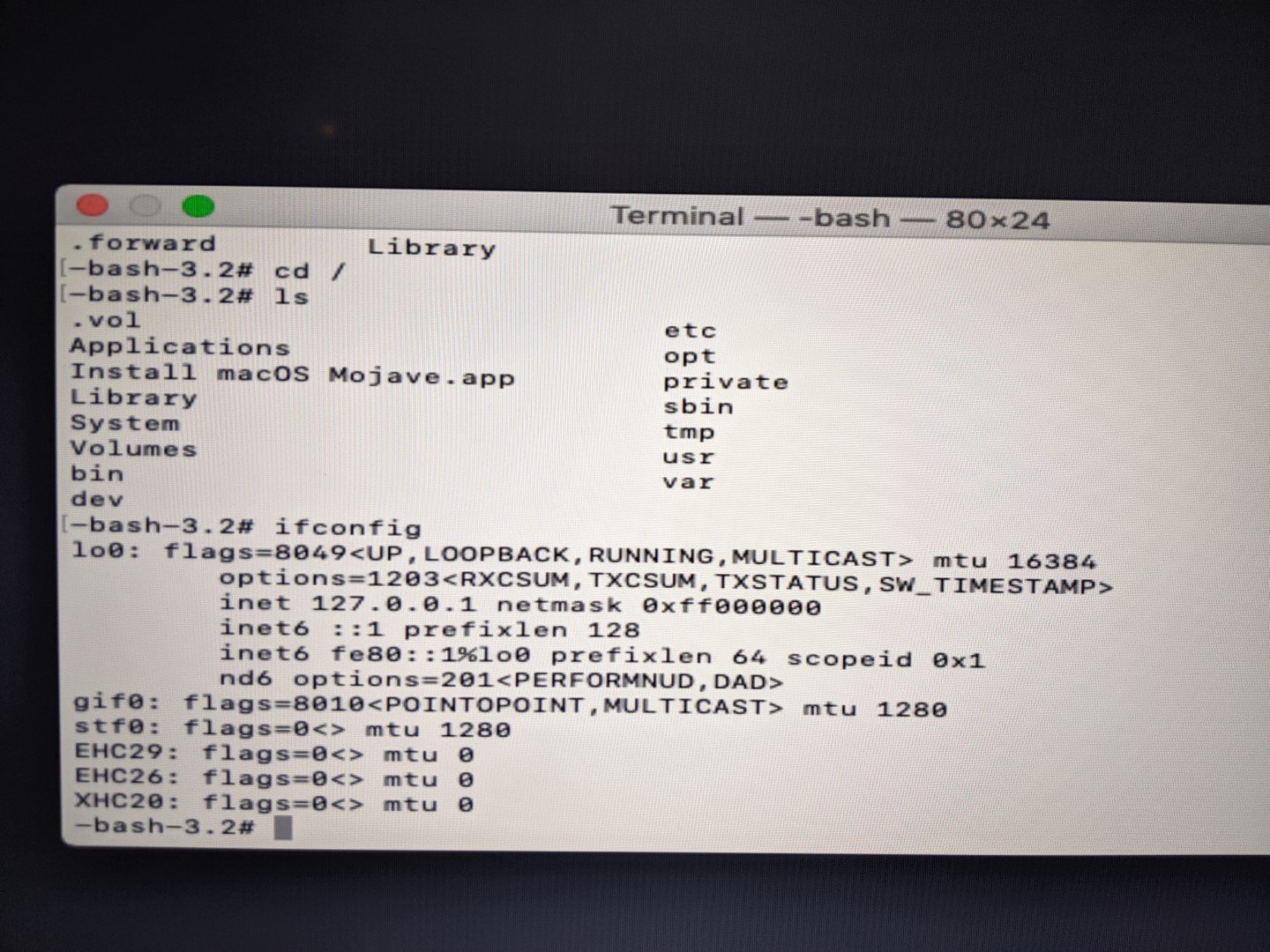

NOTORIOUS VR Posted October 3, 2019 Share Posted October 3, 2019 Hi all, After some trial and error and much reading I was finally able to make it into the installer. Unfortunately for whatever reason I cannot get my NIC working so I cannot continue the installation. It doesn't recognize the NIC at all - It's a Realtek 8168 which should be supported especially with Mieze's Realtek GbE driver kext which I have the latest version of. I have also tried many other kexts without success. The NIC works fine under Win10. I'm wondering if anyone has suggestions on what to try next. Attached is my config.plist - maybe there is something in there that I am missing as well? config.plist Link to comment Share on other sites More sharing options...

NOTORIOUS VR Posted October 6, 2019 Author Share Posted October 6, 2019 (edited) I have seen it, but I have no idea what to do with the files from your github That said I have finally found out how to get a log/debug file going... And I see that it is skipping the kext injection for the NIC. Why I have no idea.. searching for the issue gets me no where unfortunately except for people saying I shouldn't used Detect for injection but set to Yes. That didn't work either though. snippet of log: 21:813 0:024 Preparing kexts injection for arch=x86_64 from EFI\CLOVER\kexts\Other 21:833 0:019 Extra kext: EFI\CLOVER\kexts\Other\AtherosE2200Ethernet.kext (v.2.2.2) 21:845 0:011 Skipping kext injection by OSBundleRequired : EFI\CLOVER\kexts\Other\AtherosE2200Ethernet.kext 21:854 0:009 Extra kext: EFI\CLOVER\kexts\Other\WhateverGreen.kext (v.1.2.7) 21:905 0:050 Extra kext: EFI\CLOVER\kexts\Other\RealtekRTL8111.kext (v.2.2.2) 21:917 0:012 Skipping kext injection by OSBundleRequired : EFI\CLOVER\kexts\Other\RealtekRTL8111.kext 21:926 0:008 Extra kext: EFI\CLOVER\kexts\Other\Lilu.kext (v.1.3.5) 21:956 0:029 Extra kext: EFI\CLOVER\kexts\Other\FakeSMC.kext (v.3.5.2) complete debug log is attached as well debug.log Edited October 6, 2019 by NOTORIOUS VR Link to comment Share on other sites More sharing options...

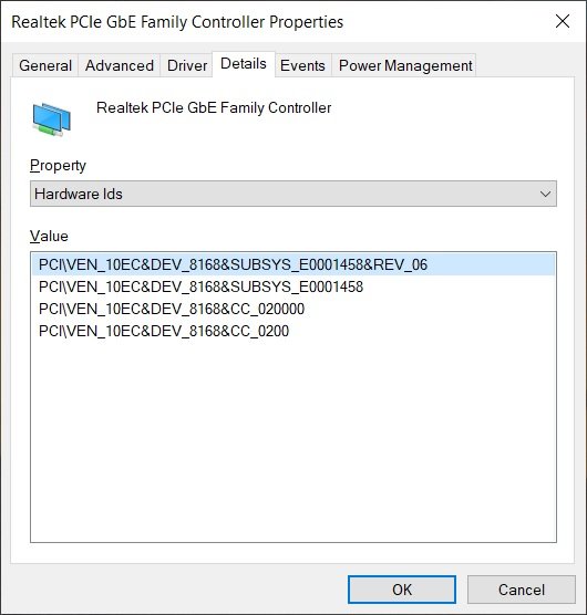

NOTORIOUS VR Posted October 6, 2019 Author Share Posted October 6, 2019 (edited) 1 hour ago, Mieze said: This is not a driver issue because the driver doesn't load at all. There are several possible causes why this might happen, for example: Driver not properly installed or another version of the driver is installed in /L/E or /S/L/E NIC disabled in BIOS I was starting to think that it's simply skipping the kext because it doesn't see the NIC physically, why that I have no idea. NIC is enabled in the BIOS (and working perfectly in Win10), and the only Realtek kext installed under EFI/CLOVER/kexts/other is currently yours (although I've tried almost all the ones online that I can find). I'm not sure what /L/E or /S/L/E means I think that might have to do with an installed MacOS system? this is not the case here, I'm not even able to get the installer to go because it doesn't see the NIC. Looking at the debug.log two things stand out out me 1. it see's the NIC's MAC address correctly: 8:577 0:905 === [ GetMacAddress ] ===================================== 8:917 0:340 MAC address of LAN #0= 94:DE:80:61:40:64: 2. the NIC is being detected along with the correct HW ID: 0:102 0:000 PCI (00|03:00.00) : 10EC 8168 class=020000 0:102 0:000 - LAN: 0 Vendor=Realtek I just do not understand why it would skip loading the kext in this case, it seems like your driver is looking for the string above is it not? <key>Driver_Version</key> <string>2.3.0d5</string> <key>IOClass</key> <string>RTL8111</string> <key>IOPCIMatch</key> <string>0x816810ec 0x81681186 0x250210ec 0x260010ec</string> Edited October 6, 2019 by NOTORIOUS VR Link to comment Share on other sites More sharing options...

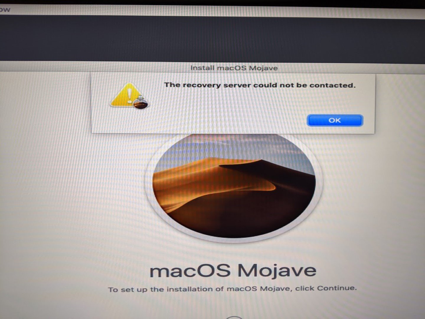

NOTORIOUS VR Posted October 6, 2019 Author Share Posted October 6, 2019 1 hour ago, Mieze said: Install without the driver. Once the system is up and running, it'll be easier to find out what is going on. Again I seem to be missing something here. How do I install Mojave without an internet connection? I cannot get any further than the initial menu when tells me it cannot connect to the servers. Link to comment Share on other sites More sharing options...
