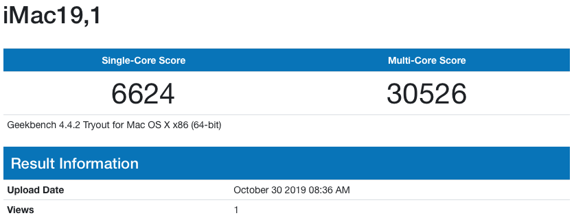

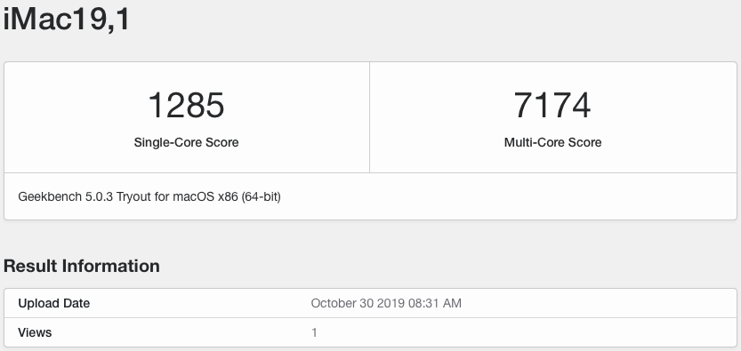

psedog Posted November 11, 2019 Share Posted November 11, 2019 Make sure you are comparing the same generation Geekbench. With Geekbench 5 benchmarks are about 4x less than Geekbench 4. Here are back to back benchmarks on the same setup. Link to comment Share on other sites More sharing options...
