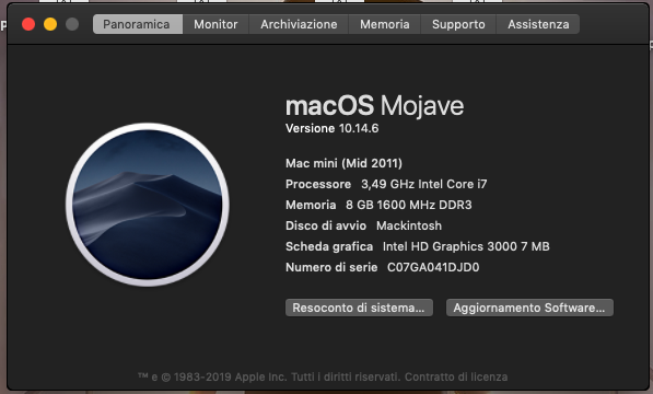

thunder94 Posted September 4, 2019 Share Posted September 4, 2019 Hi everyone, I need a hand on my hackintosh. My pc is made up of an i7 2700k, Asus P8H61M-LX, 8GB DDR3 RAM and the integrated Intel HD 3000 graphics card. I managed to install Mac OS Mojave 10.14.6, everything works except the video card which is recognized as HD 2000 with 7mb. I have followed several guides but without success. I am not a very experienced hackintosh user but I hope to find someone to help me. Link to comment Share on other sites More sharing options...

thunder94 Posted September 9, 2019 Author Share Posted September 9, 2019 chris1111 thanks but I have already tried and nothing to do, set the config.plist with injectintel, ig platform and also another device ID but nothing, at most I recognize the HD 3000 but always with 7mb of VRAM. Basically the Device id of my graphics card is 0x0122, the only one that works is putting 0x0126 but nothing always 7mb Link to comment Share on other sites More sharing options...

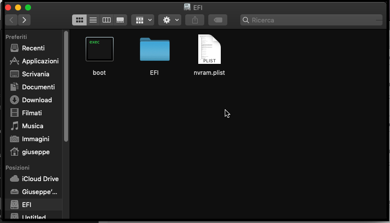

thunder94 Posted September 10, 2019 Author Share Posted September 10, 2019 (edited) I send the screen that shows the EFI partition, the screen that shows the information of the system and I send the link to download the EFI folder of that partition. However, I've tried other guides as well as this one so you could tell me how to uninstall all the kext I tried to do a clean installation of yours? Ah i would like to point out that the connection with the monitor is via RGB cable as the motherboard has only that output Link EFI folder: http://www.mediafire.com/file/bd42emn5jx6a3m7/EFI.zip/file Edited September 10, 2019 by thunder94 Link to comment Share on other sites More sharing options...

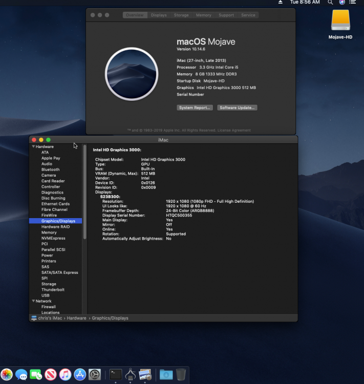

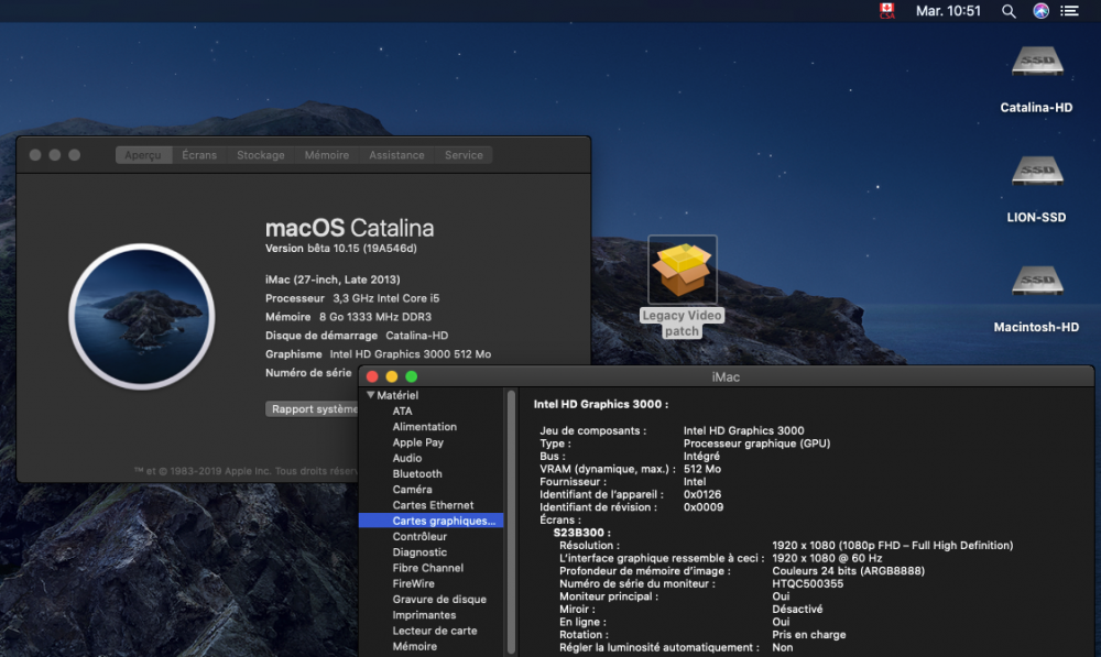

chris1111 Posted September 10, 2019 Share Posted September 10, 2019 (edited) 16 minutes ago, Hervé said: One can easily be confused by the graphics settings of your posted config @chris1111... No confusion This config works for Intel HD 3000 and the GeForce 210 on Dell Optiplex 790 I just test new Framworks from AsentientBot For Mac OS Catalina See result Tomorow I will put my Geforce 210 on the PC because I iiil go to work now ➜ Patch Update here Edited September 10, 2019 by chris1111 1 Link to comment Share on other sites More sharing options...

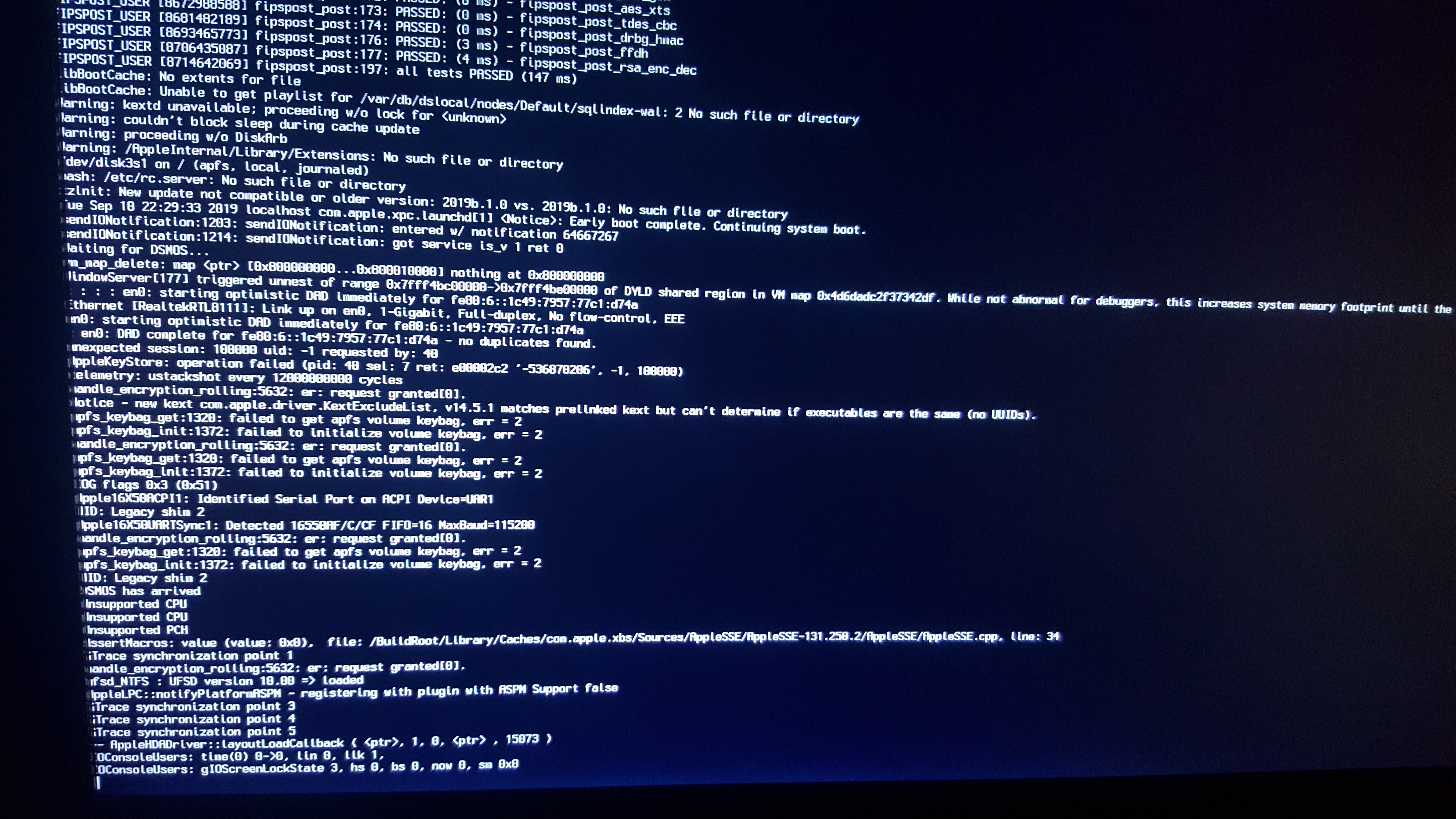

Guest ricoc90 Posted September 11, 2019 Share Posted September 11, 2019 Since your main question in that topic is about your graphics, for which you already created this topic, may I ask why you've created it? According to your last picture your system does start, but the iGPU doesn't do its job. Most likely due to the fact that the needed kexts/frameworks aren't (correctly) installed or due to a faulty config. Link to comment Share on other sites More sharing options...
