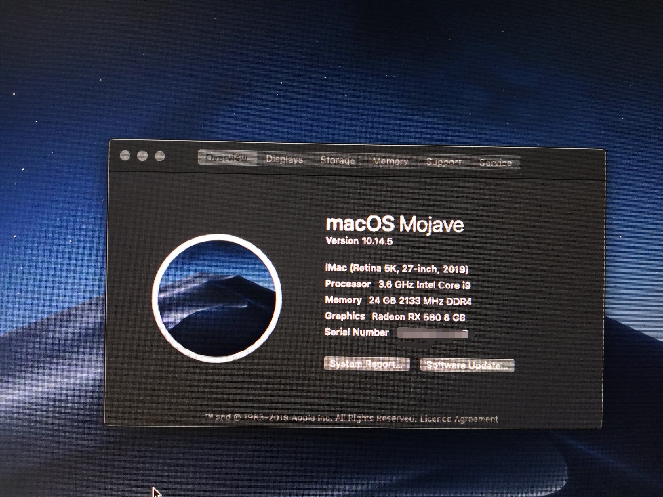

Pamu Praneeth Posted August 6, 2019 Share Posted August 6, 2019 Hii am new to mac, i installed mac os mojave 10.14.5 in my new pc hackintosh. Am facing a issue of not able to access my wifi, as my motherboard has a in built wifi slot. Please help me with the issue. My specs are: Intel I7 9th gen Z390 auros pro wifi Sapphire radeon rx 580 8gb Link to comment Share on other sites More sharing options...
gengik84 Posted August 6, 2019 Share Posted August 6, 2019 Wifi Intel = not compatible You need to replace with compatible Broadcom or use wifi usb. Link to comment Share on other sites More sharing options...
