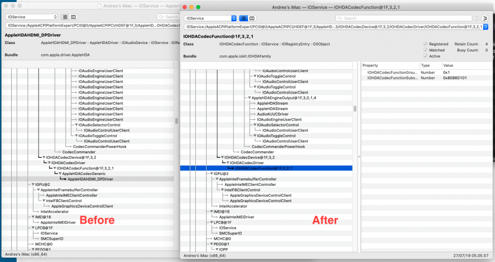

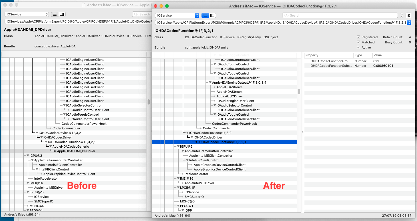

Andres ZeroCross Posted July 26, 2019 Share Posted July 26, 2019 (edited) So, i have wake issue in Catalina from DP 3 (Second Wake always Fail), but now in DP 4 i always get Kernel panic after wake about "AppleHDA HDMI_DP Driver fail to set power 0 -> 1." But i thought i get solution now. First take a look at this _DSM of HDEF in real iMac18,3. Device (HDEF) { Name (_ADR, 0x001F0003) // _ADR: Address OperationRegion (HDAR, PCI_Config, Zero, 0x60) Field (HDAR, WordAcc, NoLock, Preserve) { VID0, 16, DID0, 16 } Method (_DSM, 4, NotSerialized) // _DSM: Device-Specific Method { If (Arg0 == ToUUID ("a0b5b7c6-1318-441c-b0c9-fe695eaf949b")) { If ((VID0 & 0xFFFF) != 0xFFFF) { Local0 = Package (0x04) { "No-hda-gfx", Buffer (0x08) { 0x00, 0x00, 0x00, 0x00, 0x00, 0x00, 0x00, 0x00 /* ........ */ }, "No-idle-support", Buffer (0x02) { "0" } } DTGP (Arg0, Arg1, Arg2, Arg3, RefOf (Local0)) Return (Local0) } } Return (0x80000002) } } And if you check for IGPU device in Real iMac 18,3 you won't found "hda gfx" properties too. I am sure, it because Real iMac18,3 didn't use HDMI Audio from IGPU (HDAU), just HDAU (HDMI audio) from AMD GPU only. Then both GFX0 and HDAU of Real iMac18,3 use this properties, "hda-gfx", Buffer (0x0A) { "onboard-1" } So i have added this code below and remove "hda-gfx onboard-1" properties from my HDEF device, and change "onboard-2" in my GFX0 and HDAU (AMD Graphics) to "onboard-1". "No-hda-gfx", Buffer (0x08) { 0x00, 0x00, 0x00, 0x00, 0x00, 0x00, 0x00, 0x00 /* ........ */ }, "No-idle-support", Buffer (0x02) { "0" } Then problem is gone. I can sleep and wake my Hackintosh PC for more then 10 times without Kernel Panic or Freeze. Take a look different in IOREG Conclusions is "you need to disable your HDMI Audio of IGPU" if you don't use it (connector-less ig-platform-id). I don't know if people with multiple monitor from IGPU and EGPU still need to disable HDMI Audio in Catalina". My computer specifications is in my signature Edited July 26, 2019 by Andres ZeroCross 5 1 Link to comment https://www.insanelymac.com/forum/topic/339695-fix-kernel-panic-freeze-because-hdmi_dp-applehda-after-wake-in-catalina-with-connectorless-ig-platfrom-id-of-igpu-supported-egpu/ Share on other sites More sharing options...
tyufhl Posted July 29, 2019 Share Posted July 29, 2019 @Andres ZeroCross iMac — fw (3).zip I disable it through the iDisplay Audio Disconnect variable and the device turns off completely. Like in Apple. 1 Link to comment https://www.insanelymac.com/forum/topic/339695-fix-kernel-panic-freeze-because-hdmi_dp-applehda-after-wake-in-catalina-with-connectorless-ig-platfrom-id-of-igpu-supported-egpu/#findComment-2683340 Share on other sites More sharing options...

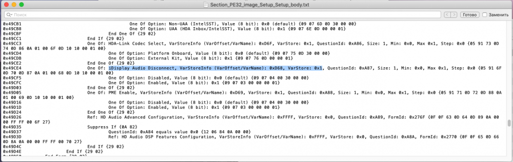

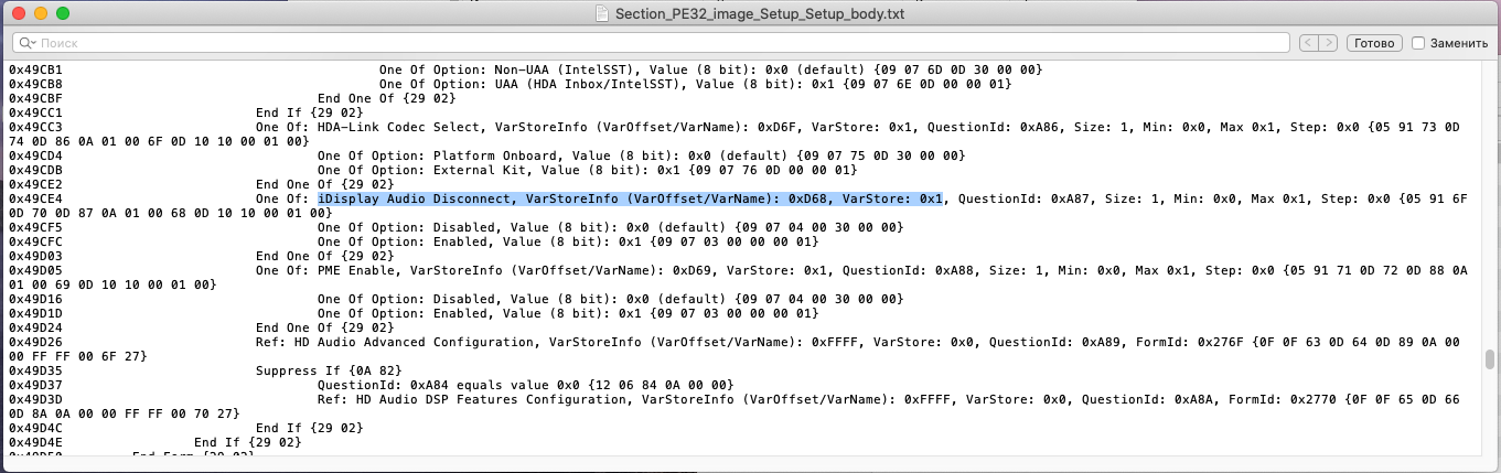

tyufhl Posted July 29, 2019 Share Posted July 29, 2019 (edited) as an example https://github.com/acidanthera/AptioFixPkg#verifymsre2 But for accessing variables, I use RU.efi http://ruexe.blogspot.com PS. in pdf showed how to do it.iDisplay Audio Disconnect.zip Edited August 10, 2019 by tyufhl 2 Link to comment https://www.insanelymac.com/forum/topic/339695-fix-kernel-panic-freeze-because-hdmi_dp-applehda-after-wake-in-catalina-with-connectorless-ig-platfrom-id-of-igpu-supported-egpu/#findComment-2683351 Share on other sites More sharing options...

tyufhl Posted September 17, 2019 Share Posted September 17, 2019 @DearTanker can show ioreg? Link to comment https://www.insanelymac.com/forum/topic/339695-fix-kernel-panic-freeze-because-hdmi_dp-applehda-after-wake-in-catalina-with-connectorless-ig-platfrom-id-of-igpu-supported-egpu/#findComment-2690370 Share on other sites More sharing options...
DearTanker Posted September 17, 2019 Share Posted September 17, 2019 7 hours ago, tyufhl said: @DearTanker can show ioreg? IOREG&BIOS_setup_body.zip Link to comment https://www.insanelymac.com/forum/topic/339695-fix-kernel-panic-freeze-because-hdmi_dp-applehda-after-wake-in-catalina-with-connectorless-ig-platfrom-id-of-igpu-supported-egpu/#findComment-2690405 Share on other sites More sharing options...

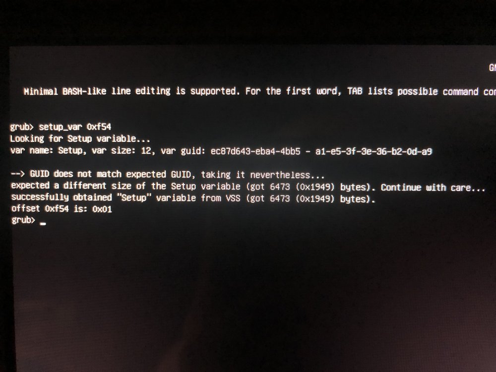

tyufhl Posted September 17, 2019 Share Posted September 17, 2019 @DearTanker can show a photo of the page "Setup" with the offset 0xF54? Link to comment https://www.insanelymac.com/forum/topic/339695-fix-kernel-panic-freeze-because-hdmi_dp-applehda-after-wake-in-catalina-with-connectorless-ig-platfrom-id-of-igpu-supported-egpu/#findComment-2690444 Share on other sites More sharing options...
DearTanker Posted September 17, 2019 Share Posted September 17, 2019 (edited) 16 minutes ago, tyufhl said: @DearTanker can show a photo of the page "Setup" with the offset 0xF54? I have set it to 0x1, and I have check two times to make sure I was right. I will take the photo for u ... Edited September 17, 2019 by DearTanker Link to comment https://www.insanelymac.com/forum/topic/339695-fix-kernel-panic-freeze-because-hdmi_dp-applehda-after-wake-in-catalina-with-connectorless-ig-platfrom-id-of-igpu-supported-egpu/#findComment-2690447 Share on other sites More sharing options...
tyufhl Posted September 17, 2019 Share Posted September 17, 2019 48 minutes ago, DearTanker said: I have set it to 0x1, and I have check two times to make sure I was right. I will take the photo for u ... can you change CFG Lock? Link to comment https://www.insanelymac.com/forum/topic/339695-fix-kernel-panic-freeze-because-hdmi_dp-applehda-after-wake-in-catalina-with-connectorless-ig-platfrom-id-of-igpu-supported-egpu/#findComment-2690450 Share on other sites More sharing options...
DearTanker Posted September 18, 2019 Share Posted September 18, 2019 19 hours ago, tyufhl said: can you change CFG Lock? I have already done that. Link to comment https://www.insanelymac.com/forum/topic/339695-fix-kernel-panic-freeze-because-hdmi_dp-applehda-after-wake-in-catalina-with-connectorless-ig-platfrom-id-of-igpu-supported-egpu/#findComment-2690557 Share on other sites More sharing options...
tyufhl Posted September 18, 2019 Share Posted September 18, 2019 3 hours ago, DearTanker said: I have already done that. I can't help you. long ago you unlocked CFG? Link to comment https://www.insanelymac.com/forum/topic/339695-fix-kernel-panic-freeze-because-hdmi_dp-applehda-after-wake-in-catalina-with-connectorless-ig-platfrom-id-of-igpu-supported-egpu/#findComment-2690574 Share on other sites More sharing options...
DearTanker Posted September 18, 2019 Share Posted September 18, 2019 1 hour ago, tyufhl said: I can't help you. long ago you unlocked CFG? No, just do that. any idea? Link to comment https://www.insanelymac.com/forum/topic/339695-fix-kernel-panic-freeze-because-hdmi_dp-applehda-after-wake-in-catalina-with-connectorless-ig-platfrom-id-of-igpu-supported-egpu/#findComment-2690580 Share on other sites More sharing options...
