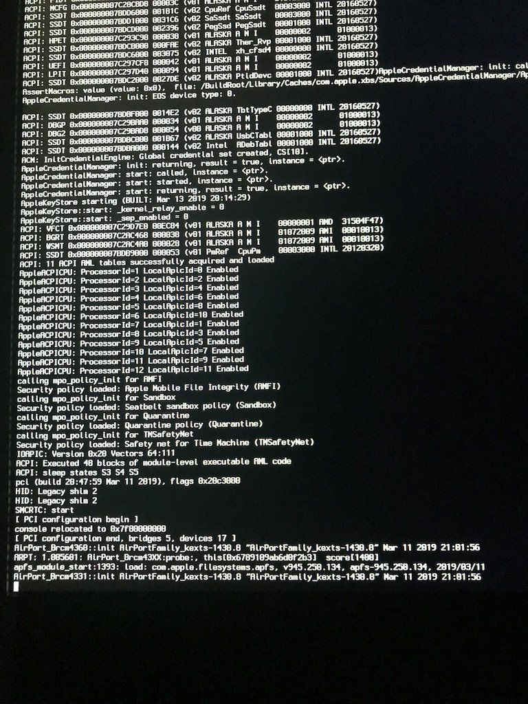

Oschly Posted April 7, 2019 Share Posted April 7, 2019 Hi! I have a problem with 10.14.4 on booting stage (photo). My specs: MOBO: Z390 MAG Tomahawk CPU: i7-8700k GPU: RX 580 Nitro+ Wifi: BCM4331CD RAM: Corsair Vengeance LPX 3000MHz 16CL I've updated every kext and driver (clover version too) and only difference is that I don't have lines informing about not loading kexts (common issue here as I see). Link to comment Share on other sites More sharing options...
Oschly Posted April 7, 2019 Author Share Posted April 7, 2019 I found a problem. It's MSI's BIOS caused it. Flashing from 150 (newest from April) to 120 fixed it, 130 and 140 has same problem, so I don't recommend to update BIOS. Now everything's fine. Link to comment Share on other sites More sharing options...
