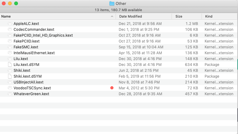

iCanaro Posted February 7, 2019 Share Posted February 7, 2019 remove .dSYM remove shiki AzulPatcher4600 Superseded by WhateverGreen AppleBacklightFixup Superseded by WhateverGreen EnableLidWake Superseded by WhateverGreen BrcmWLFixup Superseded by AirportBrcmFixup CoreDisplayFixup Superseded by WhateverGreen IntelGraphicsDVMTFixup Superseded by WhateverGreen IntelGraphicsFixup Superseded by WhateverGreen NvidiaGraphicsFixup Superseded by WhateverGreenShiki Superseded by WhateverGreen Link to comment https://www.insanelymac.com/forum/topic/337536-usb-30-not-working-with-different-cpu-in-mojave/#findComment-2663022 Share on other sites More sharing options...

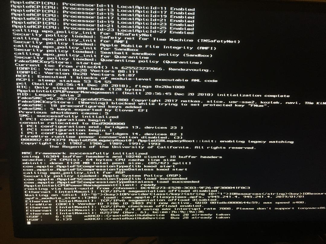

macattackjack Posted February 7, 2019 Author Share Posted February 7, 2019 I tried removing both Lilu.dSYM, shiki and shiki.dSYM. If that's what you meant by "remove .dSYM." USB 3.0 however still not working. As I said, I have a USB 3.0 PCI-E card installed in both computers, and they both work. It's the internal USB 3 that isn't working. I tried once booting the SSD with the motherboard USB 3.0, in verbose mode and while the Ports were loading the boot froze, which I take to mean that the ports became disabled by the OS as it was loading. It's doing something that is actively shutting off those ports. Link to comment https://www.insanelymac.com/forum/topic/337536-usb-30-not-working-with-different-cpu-in-mojave/#findComment-2663030 Share on other sites More sharing options...
iCanaro Posted February 7, 2019 Share Posted February 7, 2019 test: mXHCD.kext remove USBinjectall and GenericUSB patch port limit x macOS to use pendrive emergency for KP sorry my english Link to comment https://www.insanelymac.com/forum/topic/337536-usb-30-not-working-with-different-cpu-in-mojave/#findComment-2663033 Share on other sites More sharing options...
macattackjack Posted February 7, 2019 Author Share Posted February 7, 2019 (edited) 5 hours ago, iCanaro said: test: mXHCD.kext remove USBinjectall and GenericUSB patch port limit x macOS to use pendrive emergency for KP sorry my english that made it freeze during boot I noticed too, the cpu threat count is 27. Shouldn't it be 0 to 23 for the 12 core? Voodoosync is set to 23. Edited February 7, 2019 by macattackjack I am human. Link to comment https://www.insanelymac.com/forum/topic/337536-usb-30-not-working-with-different-cpu-in-mojave/#findComment-2663093 Share on other sites More sharing options...
