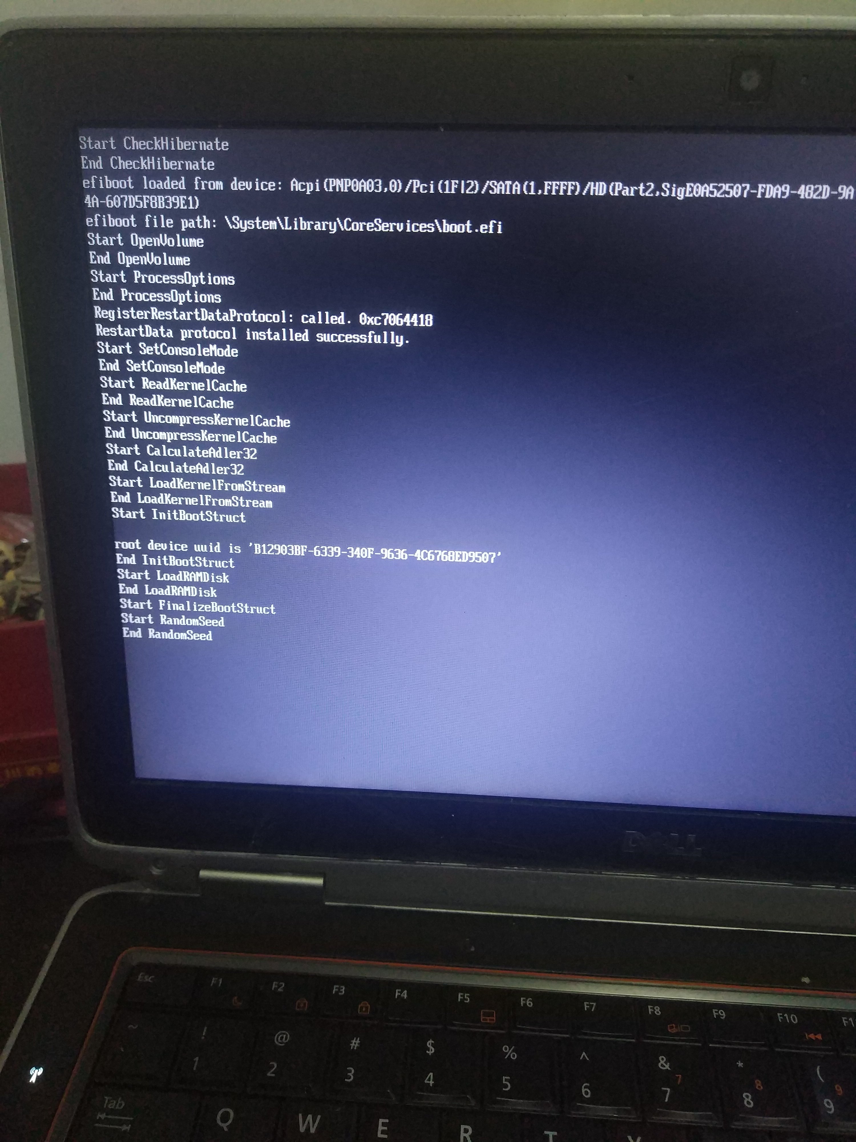

jaccky8 Posted February 3, 2019 Share Posted February 3, 2019 (edited) Previously installed 10.13.6 everything is normal, due to wake up after the card is stuck, restart until the battery is used up, the boot prompts end randomseed, the cursor below has been flashing. Everything is done, change the memory stick, change the macos version and clover, configuration files and other methods, the problem remains. Please help me, be grateful! Drawings and preboot preboot.log Quote VID_20190201_004938.mp4 Edited June 4, 2019 by Slice use english Link to comment https://www.insanelymac.com/forum/topic/337487-install-macosx-clover-stuck-in-end-randomseed%E2%80%9Dand-restart-after-10-minutes/ Share on other sites More sharing options...
Slice Posted February 3, 2019 Share Posted February 3, 2019 1. Your Clover is old by 200 revisions. 2. Your AptioFix is wrong 0:143 0:000 Loading OsxAptioFixDrv256m-64.efi status=Success Use OsxAptioFix3Drv or AptioMemoryFix with native NVRAM support. 3. Dell Latitude E6320 is a well known laptop and you may find ready-to-use solution for it. And more. Something is wrong on your drive, partitions configuration 3:184 0:000 - [04]: 'win10' 3:210 0:026 - [05]: 'b ' 3:224 0:013 - [08]: 'Install macOS Mojave' 3:248 0:024 AddLoaderEntry for Volume Name=Install macOS Mojave 3:269 0:021 - [09]: 'soft' 3:301 0:031 - [10]: 'doc' 3:343 0:042 - [11]: 'other' 3:383 0:039 - [13]: ';¡≈:Uÿ' 3:478 0:094 - [14]: 'USMEFI' I am not sure, may be this is your choice. Link to comment https://www.insanelymac.com/forum/topic/337487-install-macosx-clover-stuck-in-end-randomseed%E2%80%9Dand-restart-after-10-minutes/#findComment-2662556 Share on other sites More sharing options...
Slice Posted February 3, 2019 Share Posted February 3, 2019 ... At last. Your computer, your graphics HD3000 is not compatible with macOS Mojave. Your last chance is 10.13.6. Link to comment https://www.insanelymac.com/forum/topic/337487-install-macosx-clover-stuck-in-end-randomseed%E2%80%9Dand-restart-after-10-minutes/#findComment-2662557 Share on other sites More sharing options...
jaccky8 Posted February 3, 2019 Author Share Posted February 3, 2019 Thank you for your reply, but before 13.6, you suddenly couldn't get into the system, and you stuck "end random seed" all the time, without any response. 10.14.3 is just testing clover, but the problem is still "end random seed" stuck, cursor flashing, no error prompts. Any clover version is a hint. I don't know what the problem is. Link to comment https://www.insanelymac.com/forum/topic/337487-install-macosx-clover-stuck-in-end-randomseed%E2%80%9Dand-restart-after-10-minutes/#findComment-2662592 Share on other sites More sharing options...
Slice Posted February 3, 2019 Share Posted February 3, 2019 5 hours ago, jaccky8 said: Thank you for your reply, but before 13.6, you suddenly couldn't get into the system, and you stuck "end random seed" all the time, without any response. 10.14.3 is just testing clover, but the problem is still "end random seed" stuck, cursor flashing, no error prompts. Any clover version is a hint. I don't know what the problem is. I already proposed a problem in my first reply. Link to comment https://www.insanelymac.com/forum/topic/337487-install-macosx-clover-stuck-in-end-randomseed%E2%80%9Dand-restart-after-10-minutes/#findComment-2662649 Share on other sites More sharing options...
