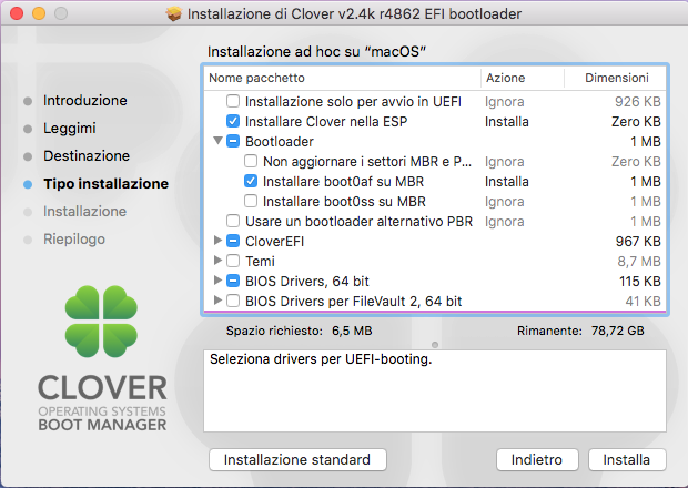

lollized Posted January 30, 2019 Share Posted January 30, 2019 (edited) Hi all, I started working on this pc during last days and finally, it's working. Specs: Intel i3 550 - 3.20Ghz Ram: 4GB Graphics: Nvidia GeForce GT 710M. (Integrated works with LiLu + WhateverGreen, but I couldn't get full display resolution). WiFi: TL-WN727N (rev 03) Motherboard: MSI 2a9c. (no UEFI) 1) Creating bootable Mojave USB. To create a Mojave USB installer, I red the apple wiki, works just fine. 2) Installing Clover. Clover must be installed in Legacy Mode. See the screenshot above for installation. 3) Copying necessary kext into clover and add config.plist. We will need those kexts (download "kexts" in attachments): -VirtualSMC -com.apple.telemetry.plugin (I extracted the kext from high Sierra) -NullCPUPowerManagement -USBInjectAll Just copy them into EFI://Clover/kexts/Other/. Warning: only copy LiLu and WhatEvergreen only if you're booting with integrated graphics. Now, download config.plist in attachments and replace with clover's default. Note 1: I used SMBIOS from iMac 13.3 because using 11.2 block the installer, as the iMac 11.2 doesn't officially support Mojave. You can change it to 11.2 whenever you want post-install. Note 2: The default boot flags are "-no_compat_check -v". This allow to boot normally. Without the first bootflag, we should obtain a message that says "This version of MacOS is not supported on this platform". 4) Booting and installing. Now, just boot and install. I selected Guid partition map and APFS file system. 5) Installing WiFi just download any version of BearExtender (make sure to follow the instructions in the package) and install the kext RT2870USBWirelessDriver.kext which I attached under "wifi.zip". 6) Installing Audio To make the audio works, I just installed VoodooHDA. Just pick the last version of it from here and install (I prefer kext utility), then, repair the permissions and reboot. many thanks to @Baio77 and @Hervé, who helped me during the first phase. config.plist.zip kexts.zip wifi.zip Edited January 31, 2019 by lollized Switched graphics to NVIDIA 1 Link to comment https://www.insanelymac.com/forum/topic/337431-success-hp-pavilion-p6619it-mojave/ Share on other sites More sharing options...

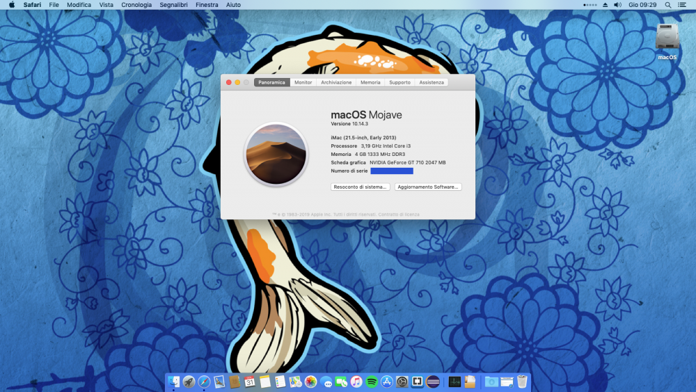

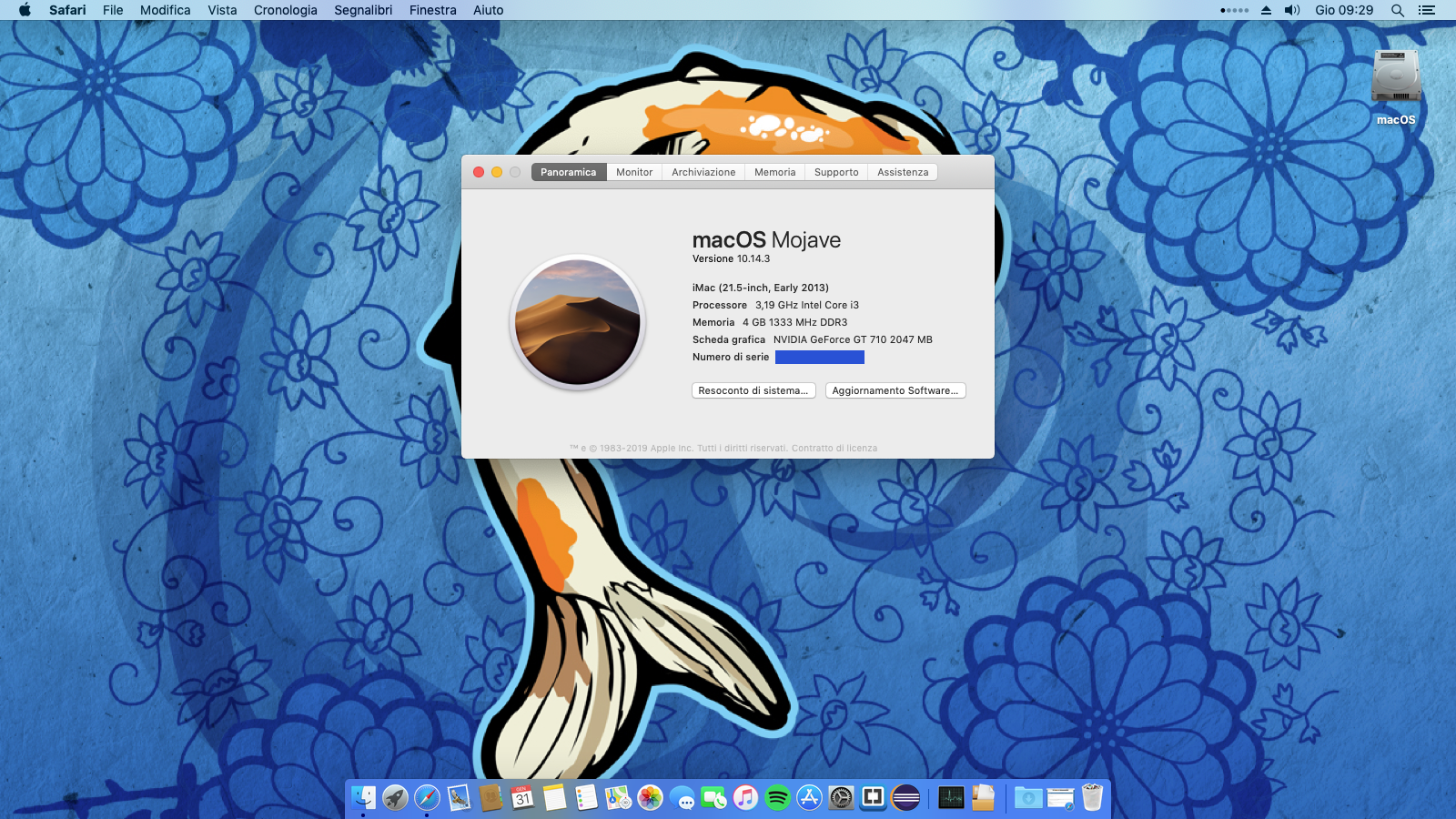

lollized Posted January 31, 2019 Author Share Posted January 31, 2019 20 hours ago, Hervé said: If you already have Lilu + WEG, you may just boot as things are right now. well, just booted without flag and Lilu. This Nvidia works OOB with full resolution. Link to comment https://www.insanelymac.com/forum/topic/337431-success-hp-pavilion-p6619it-mojave/#findComment-2662177 Share on other sites More sharing options...
lollized Posted February 1, 2019 Author Share Posted February 1, 2019 On 1/31/2019 at 10:43 AM, Hervé said: And it's a GeForce GT710, not GT710M (M would be for a mobile/laptop version)... thank you, I made a mistake... I'll update the thread with new info, now with a new smbios isn't required to boot with -no_compat_check Link to comment https://www.insanelymac.com/forum/topic/337431-success-hp-pavilion-p6619it-mojave/#findComment-2662319 Share on other sites More sharing options...
