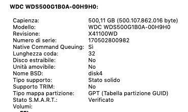

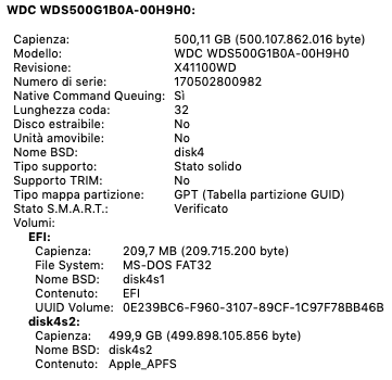

greenfrog Posted January 23, 2019 Share Posted January 23, 2019 Non riesco ad abilitare il TRIM su Mojave... Il comando "sudo trim enabler" che ho utilizzato su 10.13 pare che sul mio pc non funzioni. Fermo restando che funziona tutto correttamente vorrei sapere se la non attivazione del "trim" può creare problemi. Mojave è installato su un ssd WD Blue. Allego schermata. Ciao Link to comment https://www.insanelymac.com/forum/topic/337340-trim-su-mojave/ Share on other sites More sharing options...
iCanaro Posted January 23, 2019 Share Posted January 23, 2019 provato ad abilitarlo con la patch presente nel config? Link to comment https://www.insanelymac.com/forum/topic/337340-trim-su-mojave/#findComment-2660871 Share on other sites More sharing options...
MARZILLO Posted January 23, 2019 Share Posted January 23, 2019 enable....senza la r Link to comment https://www.insanelymac.com/forum/topic/337340-trim-su-mojave/#findComment-2660898 Share on other sites More sharing options...
fasullo Posted January 23, 2019 Share Posted January 23, 2019 sudo trimforce enable Link to comment https://www.insanelymac.com/forum/topic/337340-trim-su-mojave/#findComment-2660917 Share on other sites More sharing options...
greenfrog Posted January 31, 2019 Author Share Posted January 31, 2019 (edited) Scusatemi, mi sono dimenticato di rispondere...... Comunque no, il comando "sudo triforce enable" non va. Non funziona, dopo il riavvio tutto rimane invariato. Che faccio? Edited January 31, 2019 by greenfrog Link to comment https://www.insanelymac.com/forum/topic/337340-trim-su-mojave/#findComment-2662192 Share on other sites More sharing options...
carlo_67 Posted January 31, 2019 Share Posted January 31, 2019 provato da terminale trimforce enable Link to comment https://www.insanelymac.com/forum/topic/337340-trim-su-mojave/#findComment-2662196 Share on other sites More sharing options...
iCanaro Posted January 31, 2019 Share Posted January 31, 2019 18 minutes ago, greenfrog said: Scusatemi, mi sono dimenticato di rispondere...... Comunque no, il comando "sudo triforce enable" non va. Non funziona, dopo il riavvio tutto rimane invariato. Che faccio? apri il config con clover configurator ed aggiungi la patch sul trim che è possibile selezionare nella sezione kernel & kext patches 1 Link to comment https://www.insanelymac.com/forum/topic/337340-trim-su-mojave/#findComment-2662198 Share on other sites More sharing options...
greenfrog Posted January 31, 2019 Author Share Posted January 31, 2019 Ha funzionato. Grazie mille, è un pochino più lento in avvio ma non mi interessa granché. Preferisco avere il trim attivo. Ciao Link to comment https://www.insanelymac.com/forum/topic/337340-trim-su-mojave/#findComment-2662200 Share on other sites More sharing options...
