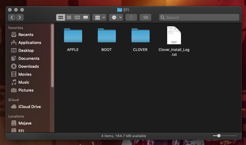

Jared Ward Posted January 8, 2019 Share Posted January 8, 2019 Hey guys! I'm in need of some major help with my Hackintosh which I put together about a year ago. The build was super easy and had no issues with installing but I've been having random crashes recently when I'm using Photoshop and Final Cut Pro. Mainly when I'm re-sizing things in Photoshop it will just shut down and reboot. At first I thought it could be my graphic's card and went ahead and upgraded it to a Sapphire Pulse RX 580 but it's still crashing. I also tested my ram with memtest and also took each stick out to test them one by one in each slot & that didn't help either. I'm honestly out of options and have no idea what this could be. I've posted a short video below that shows what I'm experiencing. Here are my specs and what I'm running... Gigabyte GA-H170 Gaming 3 Intel Core i7 8700K Sapphire Pulse RX 580 Corsair CS 750M Power Supply Corsair Vengeance LPX 48GB Memory All of my parts are brand spankin' new and I'm running High Sierra 10.13.6. If there is anyone who could help me with this or would have any other suggestions I would appreciate it! It's just frustrating as my main job is graphic design. Thanks so much! Link to comment Share on other sites More sharing options...
Donw35 Posted January 9, 2019 Share Posted January 9, 2019 post your EFI folder Link to comment Share on other sites More sharing options...
Jared Ward Posted January 9, 2019 Author Share Posted January 9, 2019 (edited) I also just tried updating to Mojave just to see if that would help anything but it didn't. Other than my problem Mojave is stable though. Edited January 9, 2019 by Jared Ward Link to comment Share on other sites More sharing options...
Donw35 Posted January 9, 2019 Share Posted January 9, 2019 lol, compress your clover folder and upload it Link to comment Share on other sites More sharing options...
Jared Ward Posted January 9, 2019 Author Share Posted January 9, 2019 My bad. CLOVER.zip Link to comment Share on other sites More sharing options...
Donw35 Posted January 9, 2019 Share Posted January 9, 2019 lol, compress your clover folder and upload it Try this one, I mad some changes, review them before hand, looks like you need to update clover too, CLOVER.zip Link to comment Share on other sites More sharing options...
Jared Ward Posted January 9, 2019 Author Share Posted January 9, 2019 (edited) Yeah, it wouldn't even boot with that folder, my HD was missing. I have a backup HD that I used to boot into my main but it still crashes. I honestly have little experience with Clover as it's always worked for me but if you have any other suggestions I'm open to them. You think updating it would help? EDIT: I went ahead and updated Clover and no luck. Edited January 9, 2019 by Jared Ward Link to comment Share on other sites More sharing options...
