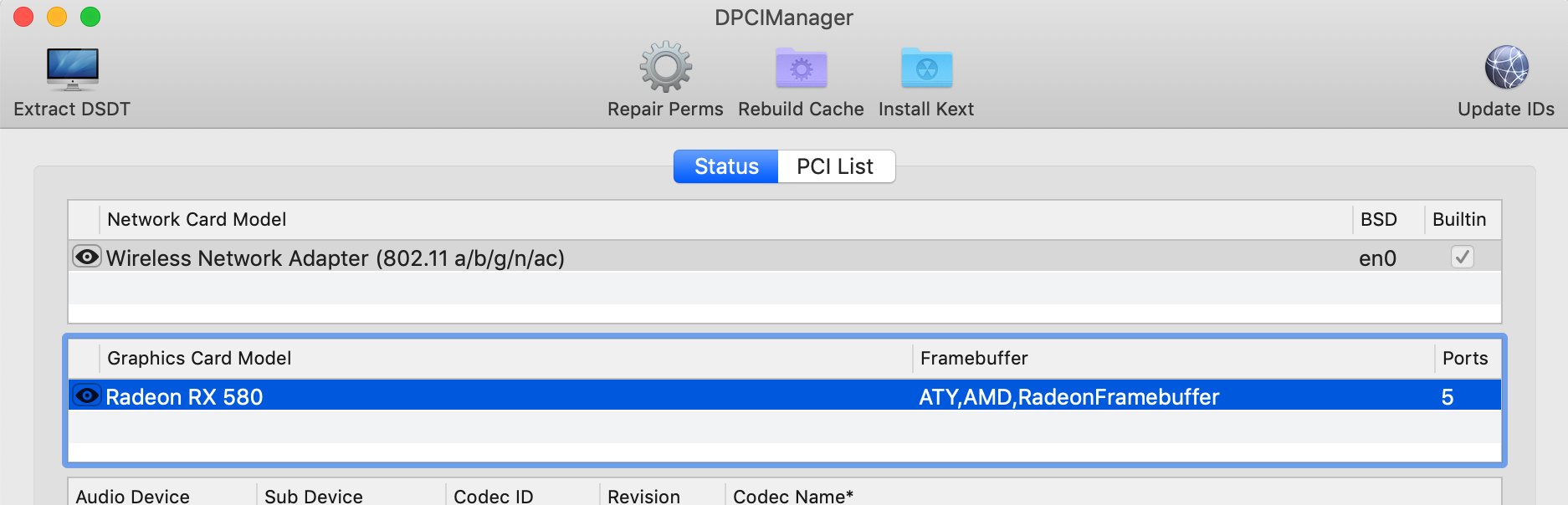

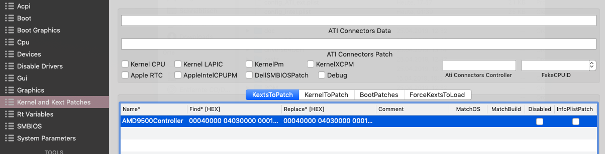

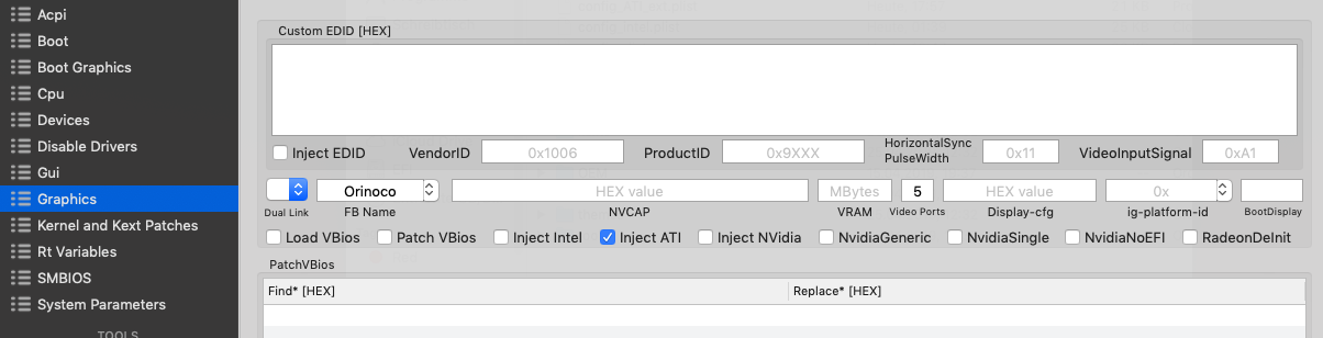

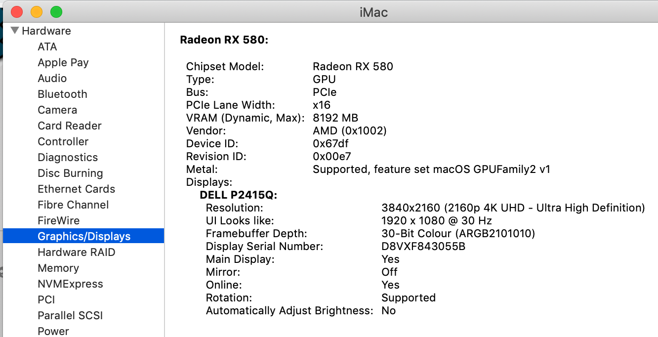

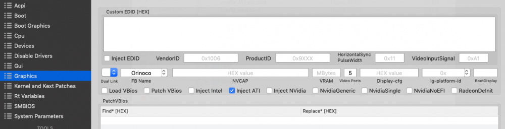

noserider Posted July 11, 2019 Share Posted July 11, 2019 I got my GIGABYTE RX 580 (Device ID 0x67DF) working with all video ports active, including HDMI, not only DVI like most users report ! Use Clover and configure the following: a) Graphics: activate 'InjectATI' AND select Framebuffer (FB) 'Orinoco' b) Kernel & Kext Patches: KextToPatch -> New entry (+) -> AMD9500Controller Under 'Find' and ''Replace' use the following text (copy / paste): Find: 000400000403000000010101000000001204060100000000 000400000403000000010201000000002205040300000000 000800000402000000010300000000001102010200000000 000800000402000000010400000000002103050400000000 040000000400000000010500000000000000030600000000 Replace: 000400000403000000010001000000001204060100000000 000400000403000000010001000000002205040300000000 000400000403000000010001000000001102010200000000 000800000402000000010000000000002103050400000000 040000000402000000010000000000000000030600000000 c) Put Lilu.kext and WhateverGreen.kext into EFI->Clover->kext->Other All ports are being activated. If you switch ports, reboot is necessary. Link to comment https://www.insanelymac.com/forum/topic/336969-rx-580-mojave-boots-to-black-screen/page/2/#findComment-2681093 Share on other sites More sharing options...
