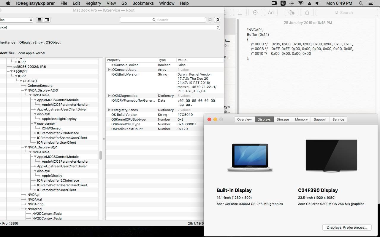

onemanOSX Posted January 29, 2019 Share Posted January 29, 2019 Using this NVCAP, HDMI video output is enabled on my other "experimental" laptop with GS 9300M running High Sierra (with WEG and LILU). No audio output though (AppleALC) Now I am determined to find an appropriate NVCap, if any, to enable VGA and HDMI of this laptop. Any ideas? Link to comment Share on other sites More sharing options...
onemanOSX Posted January 29, 2019 Share Posted January 29, 2019 I am faced with ioreg.txt: read-only file system. How can I proceed? Thanks in advance. Link to comment Share on other sites More sharing options...
onemanOSX Posted January 29, 2019 Share Posted January 29, 2019 (edited) Hi Herve, It looks like VGA is not supported for my setup here. I am however happy that at least HDMI video is working! Thank you for your kind help! Edited January 29, 2019 by onemanOSX Link to comment Share on other sites More sharing options...
