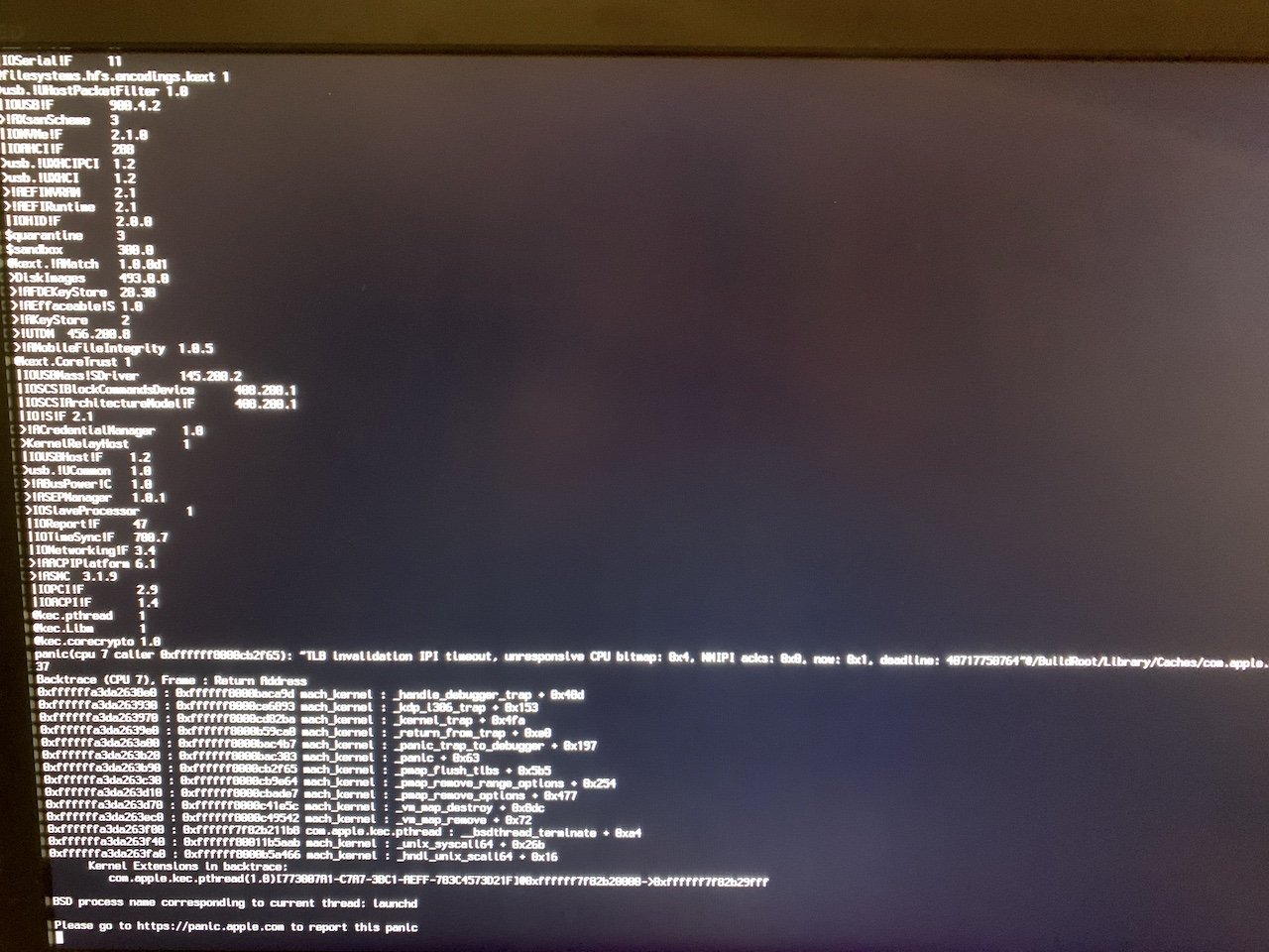

Garrosh Posted December 1, 2018 Share Posted December 1, 2018 The computer works fine but I have two problems I can't see how to fix: It crashes when I try to shutdown / reboot the system. The case fans start increasing the speed up to 100% once the OS is booted, making the computer very noisy. It's so noisy I'm starting to think about unplugging them. The system specs are: Motherboard: Gigabyte H370 HD3 CPU: Intel i7 8700 GPU: Sapphire Pulse Radeon RX Vega 56 Case: Fractal Design Define R6 EATX And this is the kernel panic: Any kind of help will be greatly appreciated. Send me Garrosh-iMac.mshome.net.zip Link to comment Share on other sites More sharing options...

Garrosh Posted December 2, 2018 Author Share Posted December 2, 2018 (edited) Ok, the fan problem was something really stupid, I forgot to copy the fake sensors kexts (although for some reason the GPU die reports always 127º, even with the RadeonVega56AirCoolingFansFix.kext). The kernel panic, on the other hand, I've been unable to fix it. I tried following the "edit DSDT" part of this guide, replacing the SSDT-UIAC.aml and SSDT.aml files I already had in ACPI/patched with the SSDT-GPRW.aml but the problem remains. This is my new config.plist. Update: looks like the fan problem isn't 100% fixed. If I run a game the fans speed increases, which is understandable, but they never go back to their original speed once I close the game. Edited December 2, 2018 by Garrosh Update about fan speed. Link to comment Share on other sites More sharing options...
Garrosh Posted December 3, 2018 Author Share Posted December 3, 2018 (edited) I've tried to follow this guide to make my own DSDT buy when I try to run the iasl command: iasl -da -dl -fe refs.txt DSDT.aml SSDT*.aml It ends with a segmentation fault error: Intel ACPI Component Architecture ASL+ Optimizing Compiler/Disassembler version 20180427(RM) Copyright (c) 2000 - 2018 Intel Corporation Input file DSDT.aml, Length 0x400E7 (262375) bytes ACPI: DSDT 0x0000000000000000 0400E7 (v02 ALASKA A M I 01072009 INTL 20160527) External object resolution file SSDT-x1_6-HwpLvt.aml Input file SSDT-x1_6-HwpLvt.aml, Length 0x724 (1828) bytes ACPI: SSDT 0x0000000000000000 000724 (v02 PmRef HwpLvt 00003000 INTL 20160527) Pass 1 parse of [SSDT] Pass 2 parse of [SSDT] External object resolution file SSDT-x1_5-ApHwp.aml Input file SSDT-x1_5-ApHwp.aml, Length 0x317 (791) bytes ACPI: SSDT 0x0000000000000000 000317 (v02 PmRef ApHwp 00003000 INTL 20160527) Pass 1 parse of [SSDT] Pass 2 parse of [SSDT] External object resolution file SSDT-x1_4-Cpu0Hwp.aml Input file SSDT-x1_4-Cpu0Hwp.aml, Length 0x10A (266) bytes ACPI: SSDT 0x0000000000000000 00010A (v02 PmRef Cpu0Hwp 00003000 INTL 20160527) Pass 1 parse of [SSDT] Pass 2 parse of [SSDT] External object resolution file SSDT-x1_3-ApCst.aml Input file SSDT-x1_3-ApCst.aml, Length 0x30A (778) bytes ACPI: SSDT 0x0000000000000000 00030A (v02 PmRef ApCst 00003000 INTL 20160527) Pass 1 parse of [SSDT] Pass 2 parse of [SSDT] External object resolution file SSDT-x1_2-Cpu0Cst.aml Input file SSDT-x1_2-Cpu0Cst.aml, Length 0x386 (902) bytes ACPI: SSDT 0x0000000000000000 000386 (v02 PmRef Cpu0Cst 00003001 INTL 20160527) Pass 1 parse of [SSDT] Pass 2 parse of [SSDT] External object resolution file SSDT-x1_1-ApIst.aml Input file SSDT-x1_1-ApIst.aml, Length 0xEF1 (3825) bytes ACPI: SSDT 0x0000000000000000 000EF1 (v02 PmRef ApIst 00003000 INTL 20160527) Pass 1 parse of [SSDT] Pass 2 parse of [SSDT] External object resolution file SSDT-x1_0-Cpu0Ist.aml Input file SSDT-x1_0-Cpu0Ist.aml, Length 0x708 (1800) bytes ACPI: SSDT 0x0000000000000000 000708 (v02 PmRef Cpu0Ist 00003000 INTL 20160527) Pass 1 parse of [SSDT] Pass 2 parse of [SSDT] External object resolution file SSDT-7-A M I.aml Input file SSDT-7-A M I.aml, Length 0xFFE (4094) bytes ACPI: SSDT 0x0000000000000000 000FFE (v02 ALASKA A M I 00000000 INTL 20160527) Pass 1 parse of [SSDT] Pass 2 parse of [SSDT] External object resolution file SSDT-6-A M I.aml Input file SSDT-6-A M I.aml, Length 0x27DE (10206) bytes ACPI: SSDT 0x0000000000000000 0027DE (v02 ALASKA A M I 00001000 INTL 20160527) Pass 1 parse of [SSDT] Pass 2 parse of [SSDT] External object resolution file SSDT-5-A M I.aml Input file SSDT-5-A M I.aml, Length 0x299C (10652) bytes ACPI: SSDT 0x0000000000000000 00299C (v02 ALASKA A M I 00000000 INTL 20160527) Pass 1 parse of [SSDT] Pass 2 parse of [SSDT] External object resolution file SSDT-4-A M I.aml Input file SSDT-4-A M I.aml, Length 0xF9E (3998) bytes ACPI: SSDT 0x0000000000000000 000F9E (v02 ALASKA A M I 00001000 INTL 20160527) Pass 1 parse of [SSDT] Pass 2 parse of [SSDT] External object resolution file SSDT-3-A M I.aml Input file SSDT-3-A M I.aml, Length 0x31C7 (12743) bytes ACPI: SSDT 0x0000000000000000 0031C7 (v02 ALASKA A M I 00003000 INTL 20160527) Pass 1 parse of [SSDT] Pass 2 parse of [SSDT] External object resolution file SSDT-2-A M I.aml Input file SSDT-2-A M I.aml, Length 0x6E3D (28221) bytes ACPI: SSDT 0x0000000000000000 006E3D (v01 ALASKA A M I 00000001 INTL 20160527) Pass 1 parse of [SSDT] Pass 2 parse of [SSDT] External object resolution file SSDT-1-A M I.aml Input file SSDT-1-A M I.aml, Length 0x17CB (6091) bytes ACPI: SSDT 0x0000000000000000 0017CB (v02 ALASKA A M I 00003000 INTL 20160527) Pass 1 parse of [SSDT] Pass 2 parse of [SSDT] External object resolution file SSDT-0-A M I.aml Input file SSDT-0-A M I.aml, Length 0x334 (820) bytes ACPI: SSDT 0x0000000000000000 000334 (v01 ALASKA A M I 00001000 INTL 20160527) Pass 1 parse of [SSDT] Pass 2 parse of [SSDT] refs.txt: Importing method external (1 arguments) MDBG refs.txt: Importing method external (0 arguments) _GPE.MMTB refs.txt: Importing method external (2 arguments) _SB.PCI0.LPCB.H_EC.ECWT refs.txt: Importing method external (1 arguments) _SB.PCI0.LPCB.H_EC.ECRD refs.txt: Importing method external (1 arguments) _SB.PCI0.LPCB.H_EC.ECMD refs.txt: Importing method external (2 arguments) _SB.PCI0.PEG0.PEGP.SGPO refs.txt: Importing method external (1 arguments) _SB.PCI0.GFX0.DD02._BCM refs.txt: Importing method external (4 arguments) _SB.PCI0.SAT0.SDSM refs.txt: Importing method external (3 arguments) _GPE.VHOV refs.txt: Importing method external (2 arguments) _SB.PCI0.XHC.RHUB.TPLD iASL: Segmentation Fault iASL: Terminating Send me Garrosh-iMac.zip Edited December 3, 2018 by Garrosh Added updated send_me zip file. Link to comment Share on other sites More sharing options...
