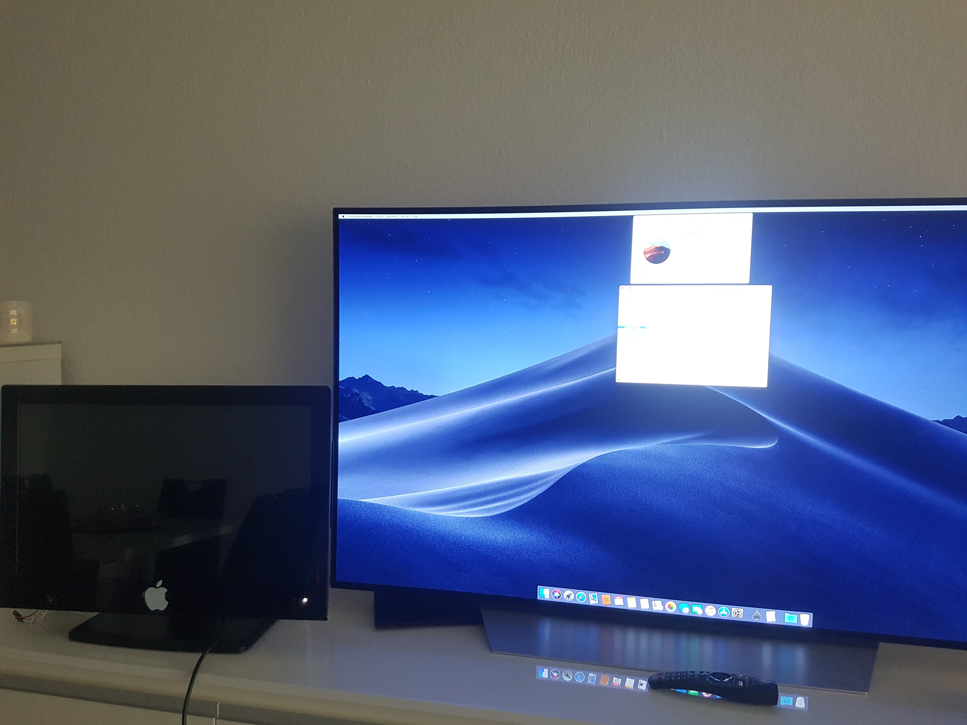

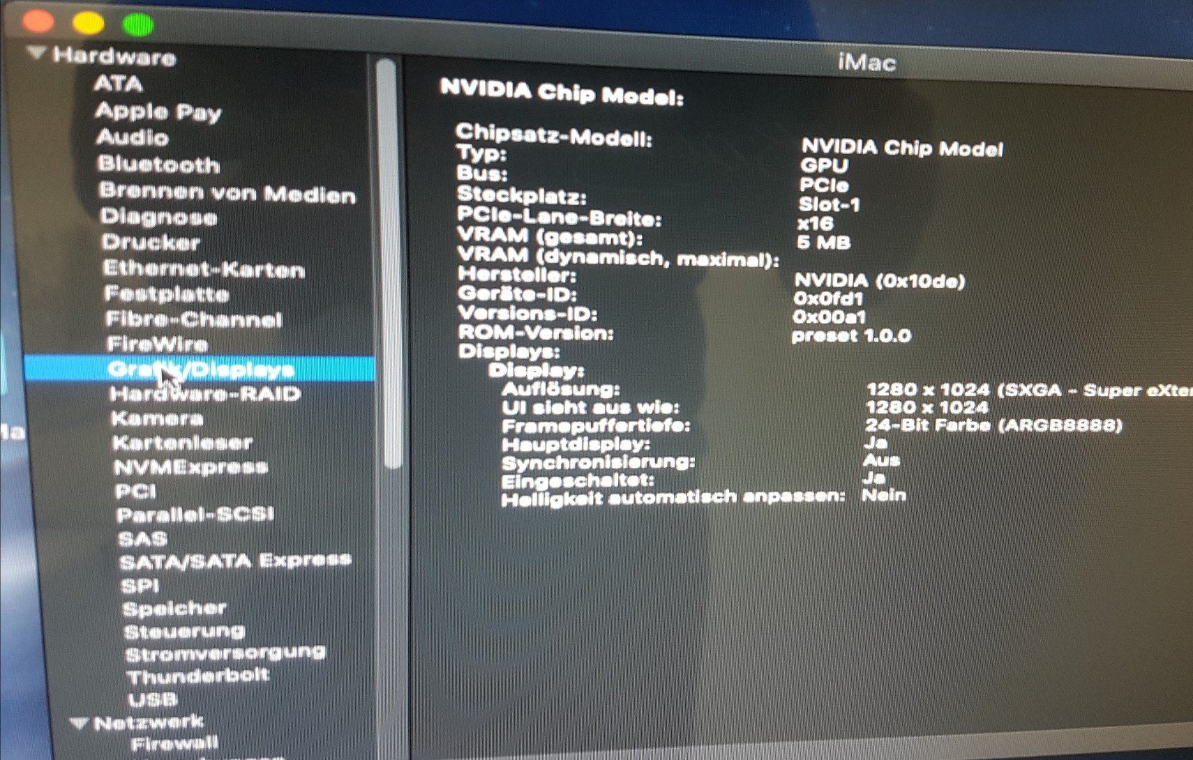

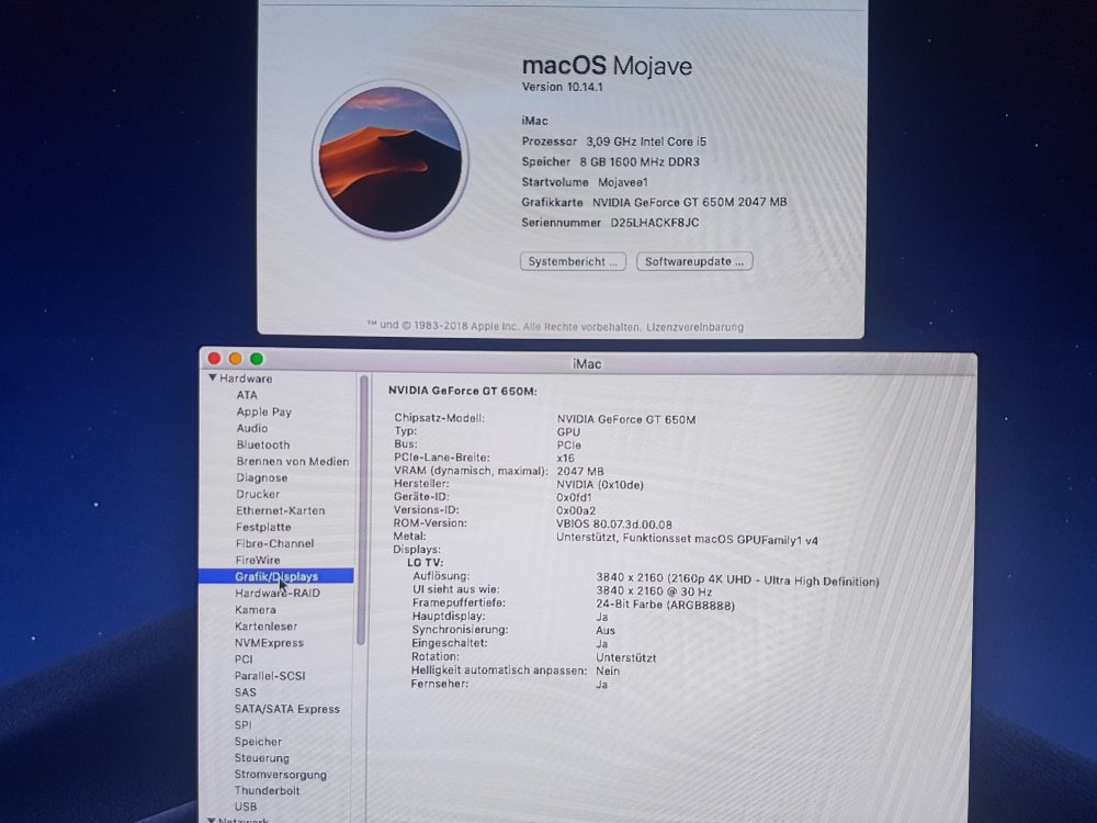

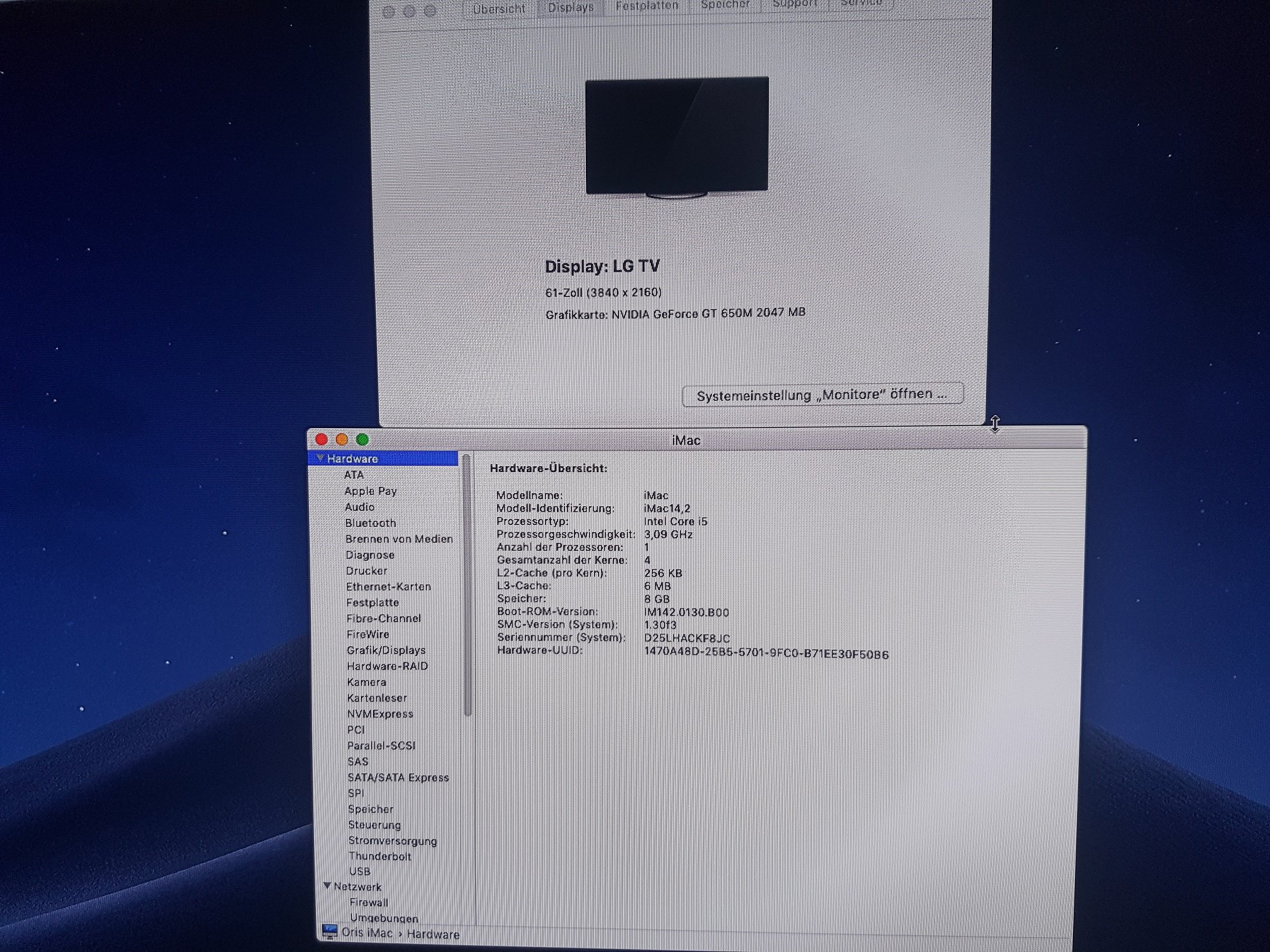

XOBX Posted November 26, 2018 Share Posted November 26, 2018 Hello EverybodyHave Mojave successfully installed without any error. But I can only start Mojave with nv_disable = 1.If I start without nv_disable the screen will remain black.The same thing happens with all versions after Mavericks.The PC has an HDMI In / Out connection. About the HDMI connection Works everything. The graphics card is recognized correctly. The graphics acceleration works wonderfully. But the built-in Minitor stays black.I have a fully functioning Mavericks. I can not update it. When I update the same thing happens as above. My PC is an AIO Lenovo B540PIntel Core i5-3350P Ivy Bridge-DTBoard: LENOVO MAHOBAYChipset: Intel H77 (Panther Point Base)NVIDIA GeForce GT 650M GK107M / N13P-GT (Kepler) Usually it does not need a driver. Is the same as Imac 13.1 only with 2GB of RAM It is the only graphics card in the system. That's on my TV via HDMI Out. I can not get any further.I think the problem is due to the HDMI Out.I have to direct it to the internal connection but unfortunately I do not know how?I do not have that much knowledge about OSX With nv_disable I see picture but the resolutions are wrong and the graphics acceleration is not available.Like here in the picture. The system loads the correct drivers, but somehow does not recognize the internal monitor connection.I have to find out where in the OSX system this is. Or I have in the OSX system HDMI Out disable and redirect it.This is not possible in the Config.plist Link to comment Share on other sites More sharing options...

rr7 Posted March 25, 2019 Share Posted March 25, 2019 I had this problem a long time ago, after mavericks 10.9.2 update NVDAResman.kext stops supporting LVDS. I don't think any developers are able to fix this for many years now. only thing I could do was plug the HDMI-out to the HDMI-In as a loop and then the screen works. I tried again recently with Lilu + whatevergreen but this is still an issue. also, currently AppleALC does not fully support GK107 audio it seems, no volume control is present. Link to comment Share on other sites More sharing options...
