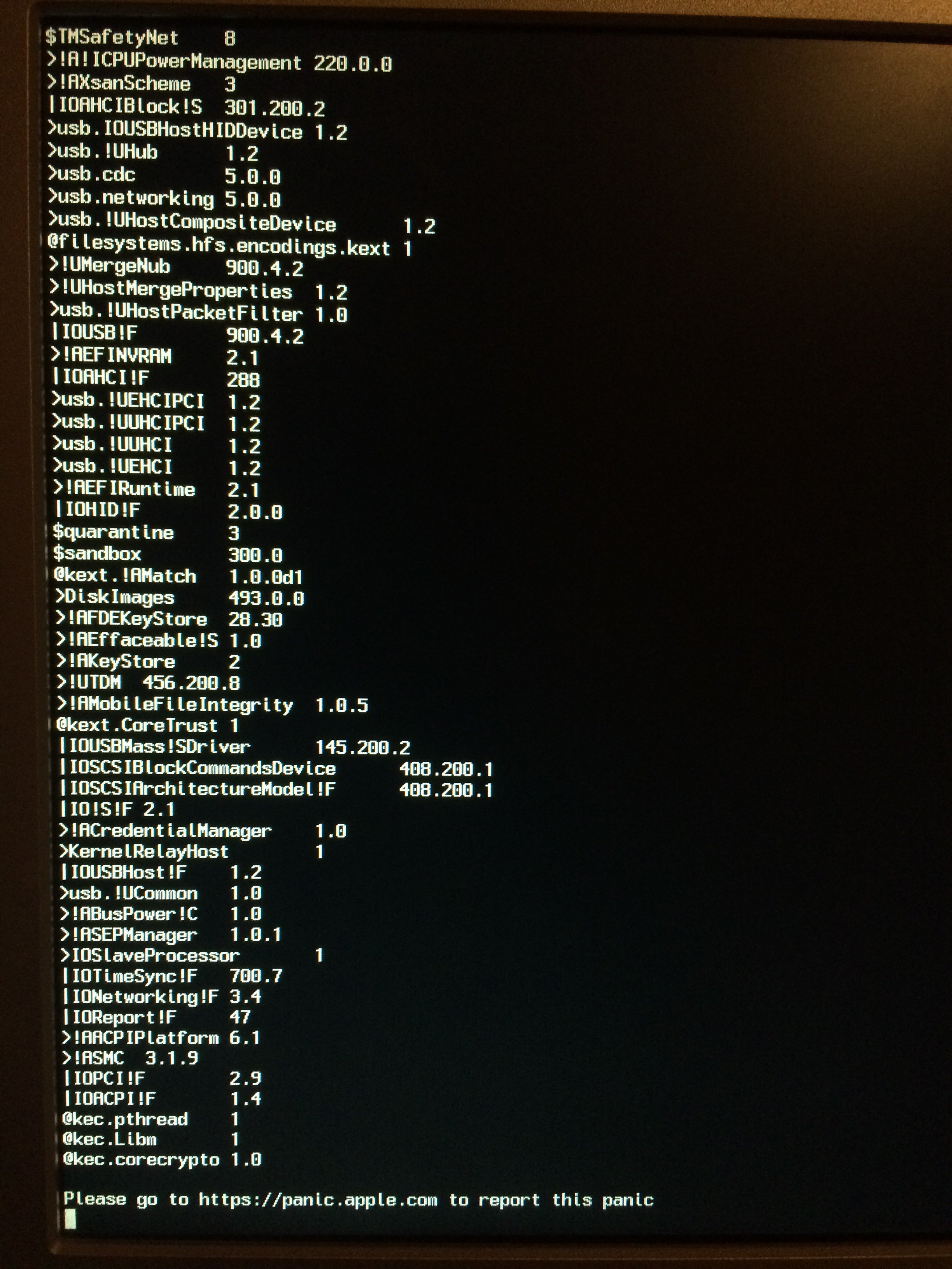

marvelloard Posted November 19, 2018 Share Posted November 19, 2018 Hi, I was able to install High Sierra on my old setup just fine (Q9500, EP45-DS3L, 650Ti, 8GB RAM, SSD). It bootet without any problems once I applied the ICH10 patches. Now I tried to install Mojave. Installation was fine, but after a reboot the system crashes on start. ICH10 patch still active. See also screenshot of crash... Latest Clover of course installed. Anyone any ideas? Link to comment Share on other sites More sharing options...
carlo_67 Posted November 19, 2018 Share Posted November 19, 2018 once installed on the disk just replace it in S/L/UserEventPlugins / com.apple.telemetry.plugin with that of High Sierra task permits and rebuild the cache com.apple.telemetry.plugin.zip that cpu does not support mojave instructions, and every update must be restored to the .plugin 1 Link to comment Share on other sites More sharing options...
marvelloard Posted November 20, 2018 Author Share Posted November 20, 2018 (edited) Thank you, I'll try that once at home. Does that mean 10.14.2+ could potentially screw this machine completely because other services might use unsupported instructions in further updates too? Is there a compatible CPU I can buy 2nd hand for 775? Edit: It did work, thank you! Edited November 20, 2018 by marvelloard Link to comment Share on other sites More sharing options...
